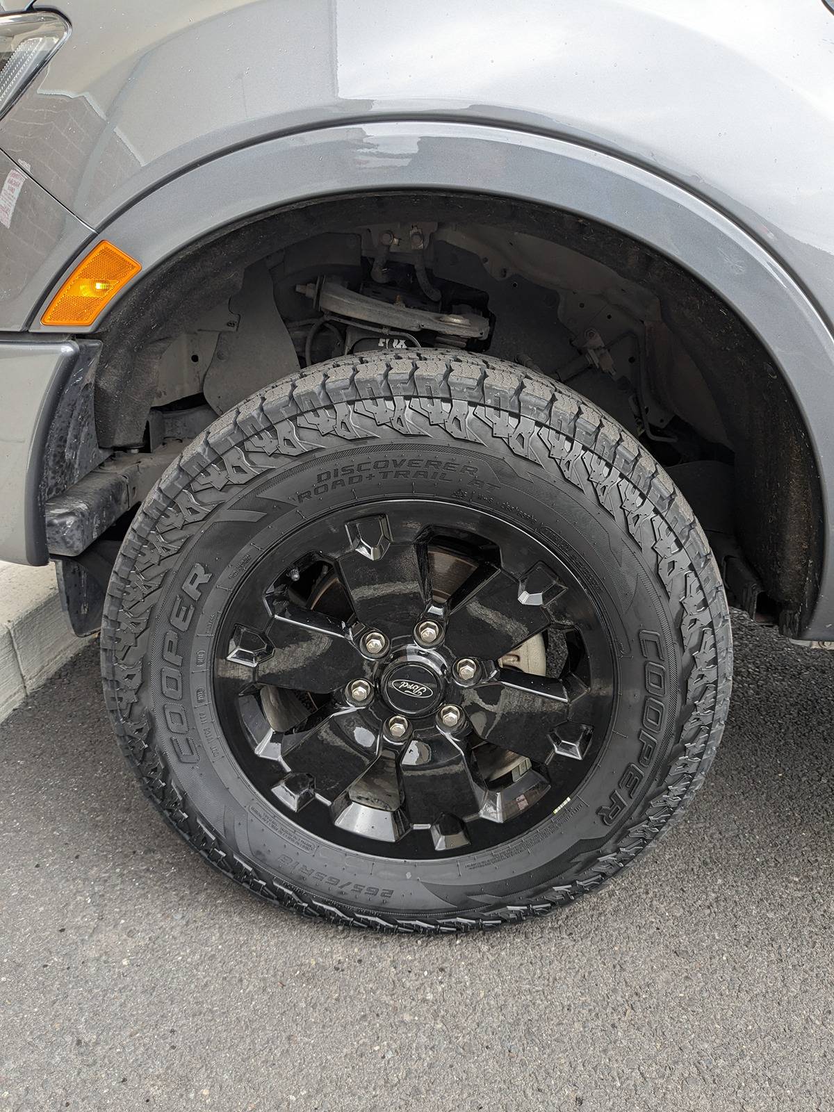

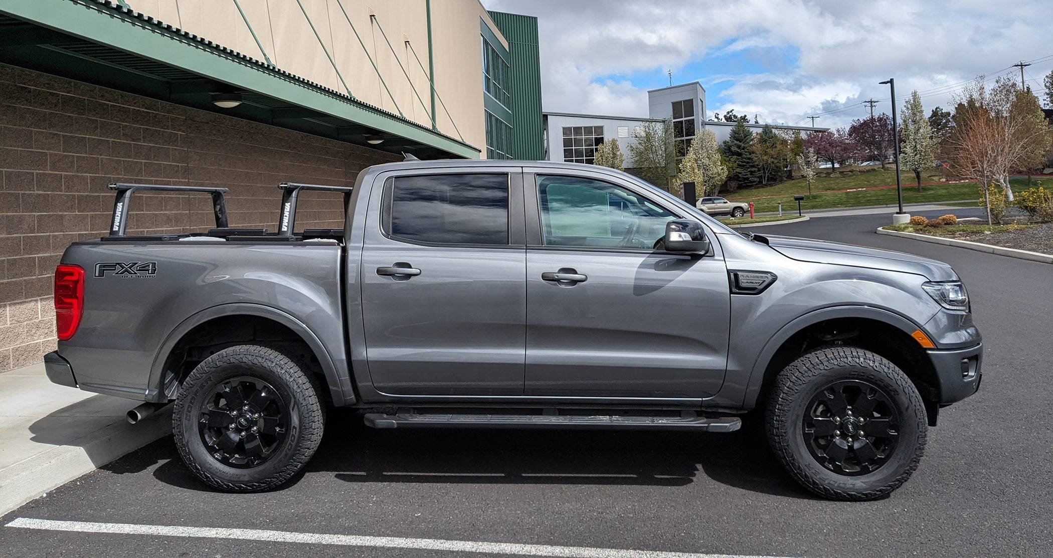

I just got back from having the Cooper Discoverer Road+Trail installed in 265/65 R18.
Initially impressions after only driving surface streets up to 45mph.
  • They look great. With my Fox 2.0 set at a pretty modest level, I could probably have gone to a full 32" tires (275/65 R18) without modifying anything. I feel that this size 265/65 R18 (31.5") is a sweet spot and don't want larger.
  • The acceleration might be a tab slower. This was a given with any replacement tire other than the Hankooks which weight 35 or 36 lbs stock. The Coopers are 41 lbs. I'll get used to new gas pedal motions and this won't be an issue.
  • At about 35 psi the tires feel much more firm than the Hankooks. With my Fox 2.0 and these tires, I love the way the truck drives. I did not realize how much of the Ranger bounce was due to the Hankooks being so squishy. I am curious to tow my travel trailer. I bet it feels much better towing.
  • They are quieter than my half-way worn down Hankooks.
The main reasons I went with the Cooper over the Falkens were:
  • weight - about 5 lbs lighter
  • XL vs SL load rating
  • cost - about $120 less with rebate.
Otherwise I am also a fan of Falken tires. I am sure they would have been a great option too. I just put their WIldpeak A/T Trail on my wife's Crosstrek and those have been impressive.

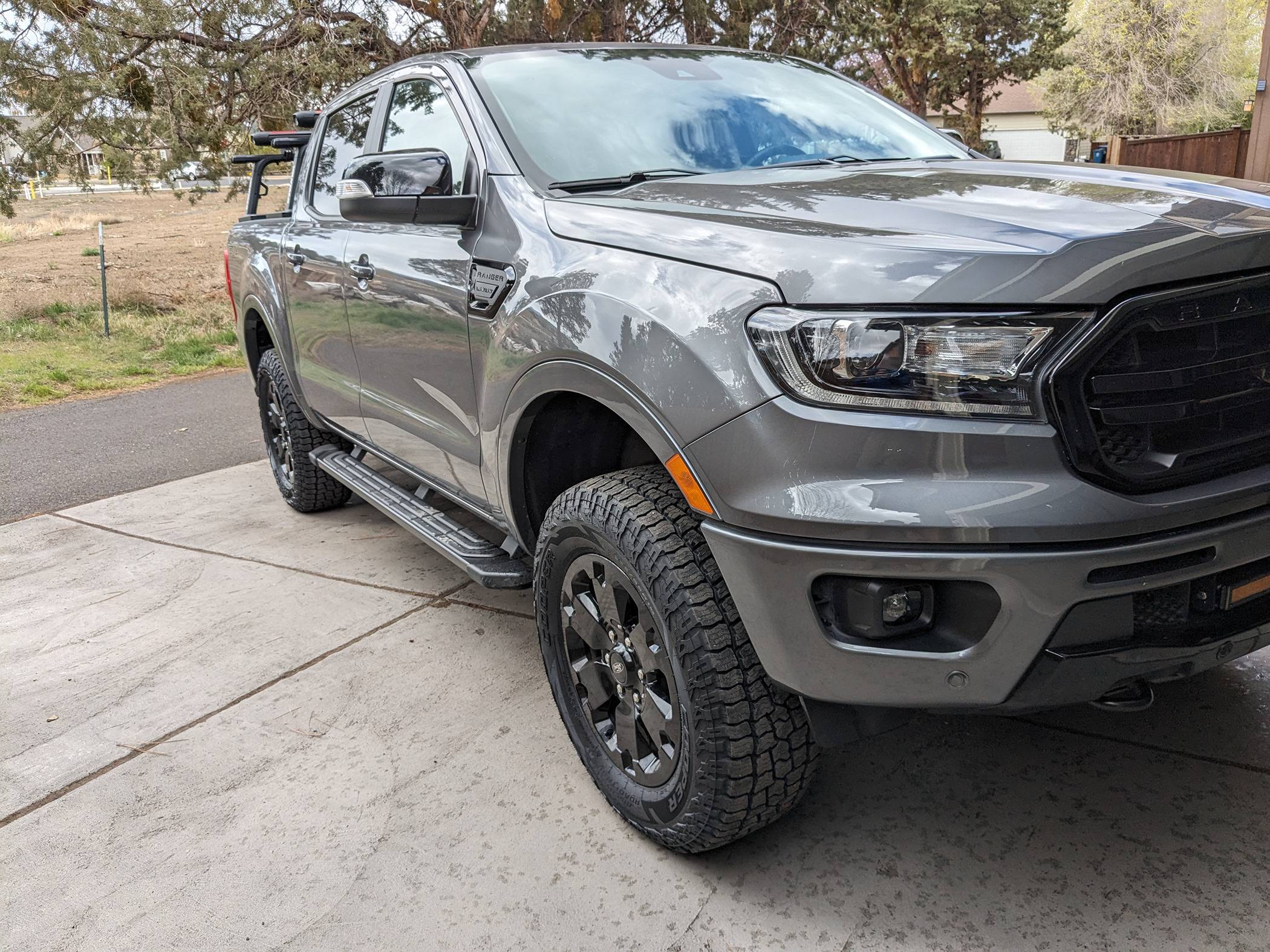

Nice looking tires. I have been researching these. I'm going to get the 255/75/17s at 32.1".
That's awesome!
I was very tempted to go for a full 32" (275/65r18 in my case).
I'll post more real world experience after I get more miles on the tires. I am researching how to adjust the tire size with Forscan currently.
Here is a good side pic.
