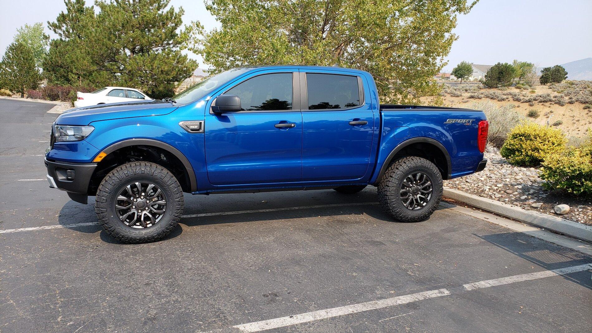

I'm running 285/70/17 with 2" wheel spacers on 2.5" level; Removed crash bars for clearance, no cutting required. Prior to the 2" spacers I had full clearance with bars installed. Talking to Stage 3 about it, in a nut shell not all 285/70/17 tires are identical in dimensions.
For the record I have Toyo OC AT2.

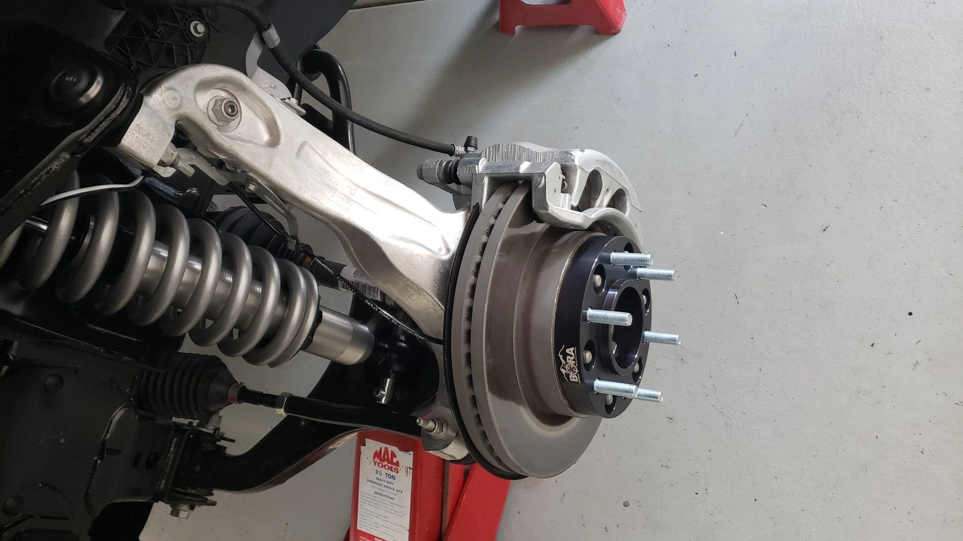

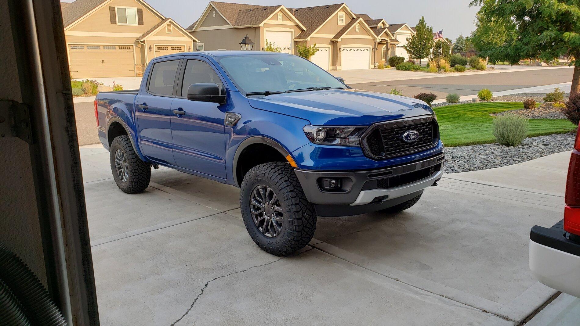

FYI In forscan I adjusted my tire size to 2614mm which is equal to the 102.9” diameter nitto has on their website for these tires and I went from 5mph slow to about 2mph fast.(odometer compared to gps) I’ll adjust with the mm size down a bit and report back.
After lots of trial and error I am down to 2520MM on the forscan tire size setting. I’m extremely close now.
Closer than my wife’s car from the factory, which is 1mph off. I’m maybe .5mph off now. Good enough for me.

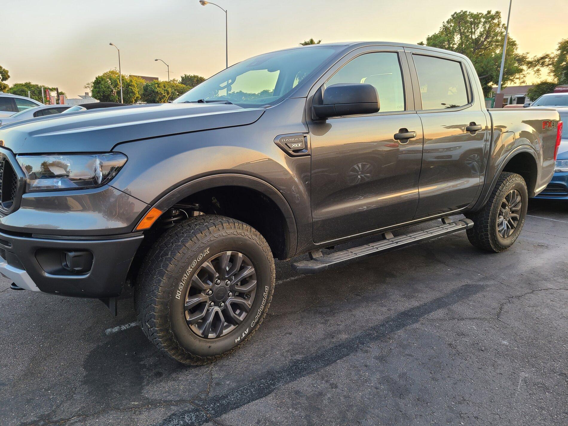

No rubbing. Quiet ride. Love the look!!!@
Wow, that looks nice, how's the ride? Have you tried it on off road? I just got a Fox 2.0 in the front and waiting to replace my tires. Thanks for the pics

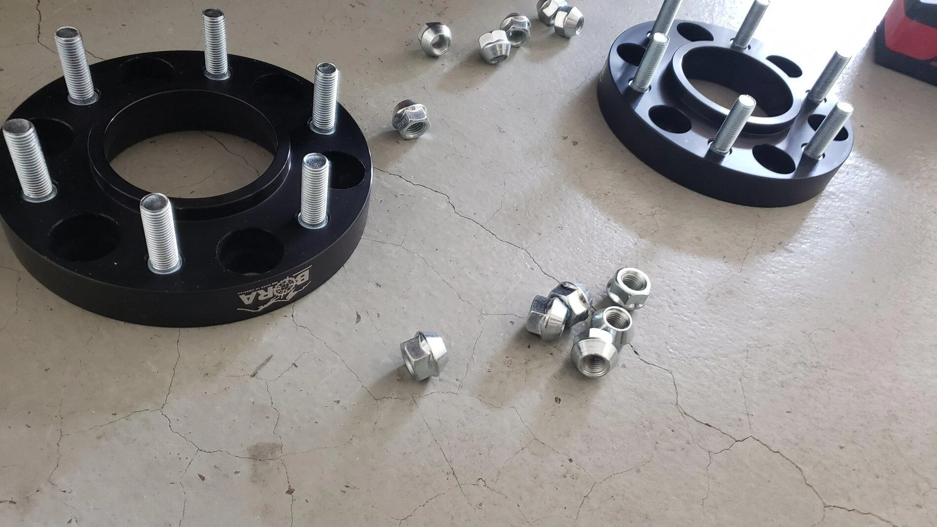

I can't say for sure but I personally do not like wheel spacers. Most like the 1/4 inch make you loose a 1/4 of the threads or more of the lug studs and that can create a safety issue even though others on the fourm will disagree with me. I myself am running the 265/70-17 Bridgestone Dueler Revo 3 on factory wheels and do just fine. For you there may be other options that suit you better.
