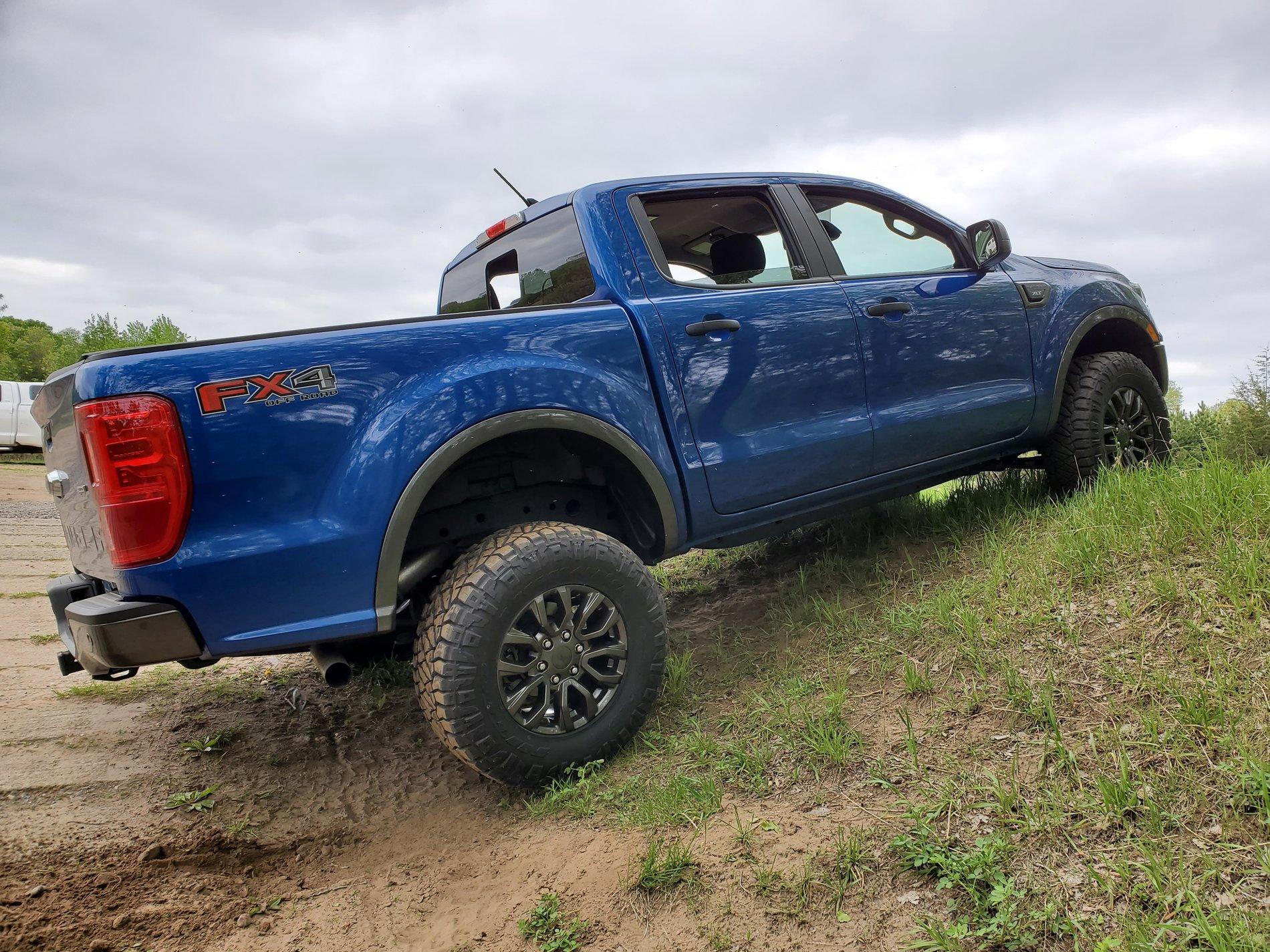

OK I’ll go... fourth?
Confirming what others have said - 1/4” wheel spacer needed to fit the magnetic 17”s. Very happy with the Ridge Grappler so far.

You need the 1/4" spacer up front to clear a 285 width tire, otherwise it rubs the steering knuckle. The lift is irrelevant to the spacer

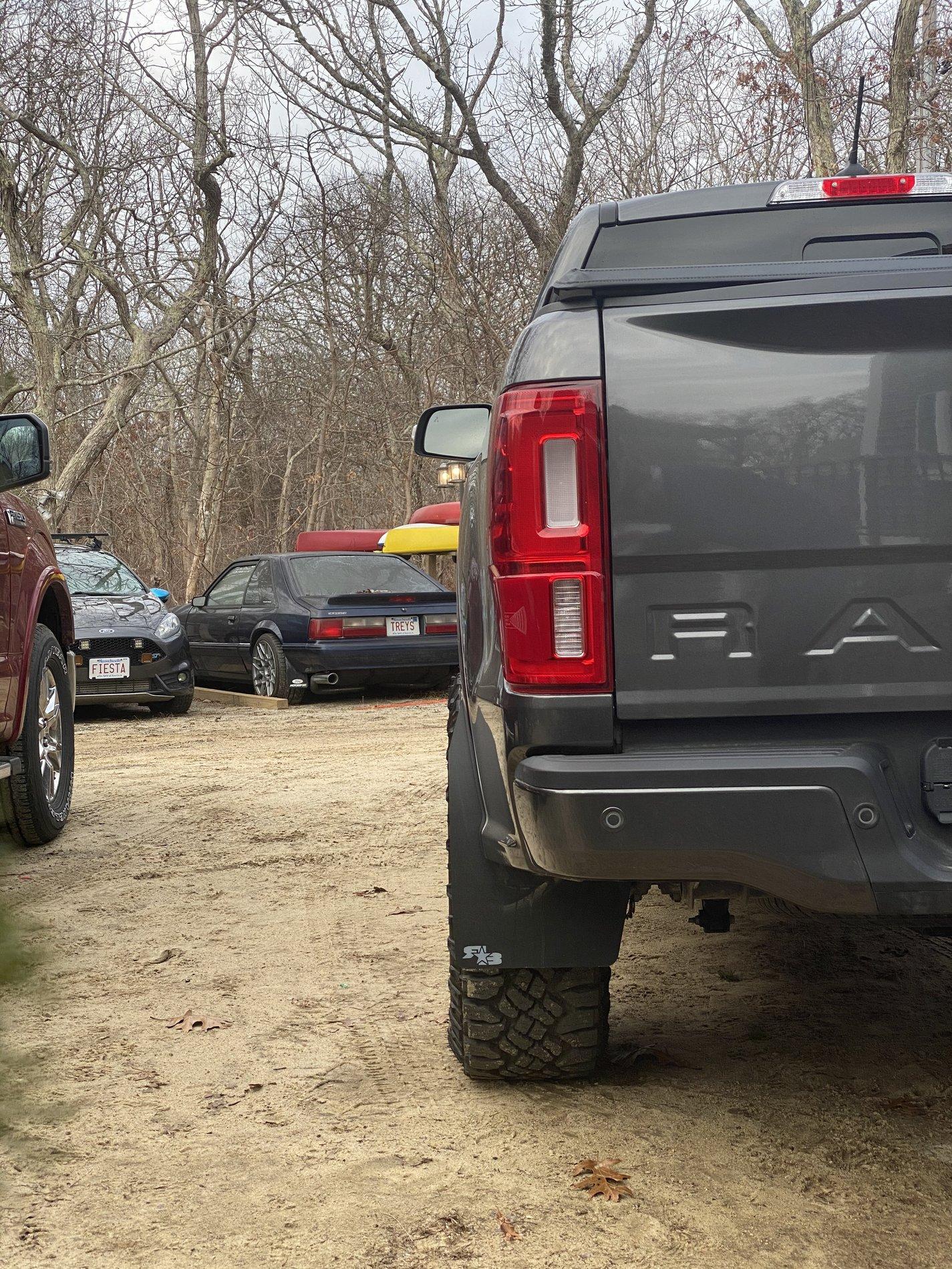

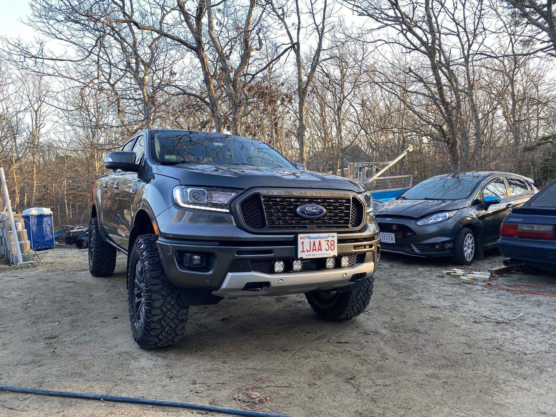

I'm running a 1.5" spacer all around, makes the clearance up front a lot tighter but dang is she good lookin'! ? a 1/4" spacer looks almost factory, you can barely tell.
I am running a 285/70/17 tire though. The spacers I bought are like $200, and you can get them in 3/4", 1", or 1.5", the small 1/4" ones are way cheaper and you only need two of them.
