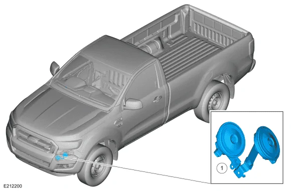

Both Horns are located by the Driver's Side headlight assembly
Car Horn = Double Horn Assembly
Alarm Horn = Single Horn Assembly

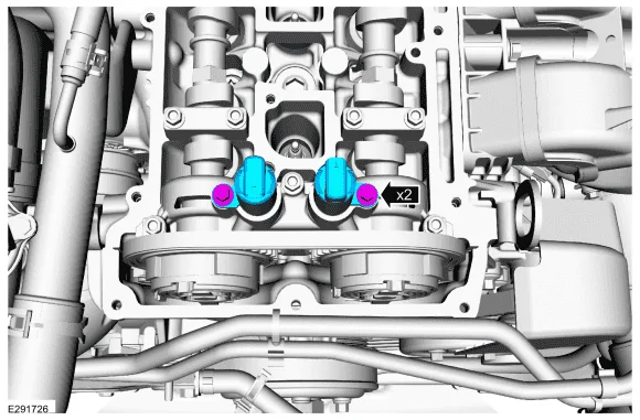

One other thing I can think of that could possibly be triggering that sound would be in the VCT - Variable Camshaft Timing solenoids trying to activate without oil pressure to move the actuators.
VCT - Solenoid Location

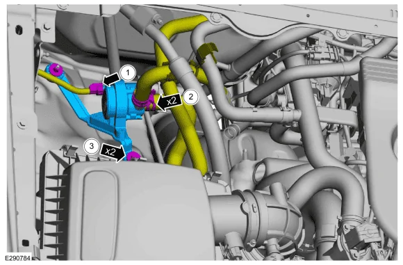

Another Possible that comes to mind would be the Cabin Coolant Heat Pump
This Pump activates when the ASS is active and you have heat selected, this keeps the Coolant Flow through the Heater Core with the engine off (ASS Active and Engine Off)
Cabin Control Heat Pump - Location

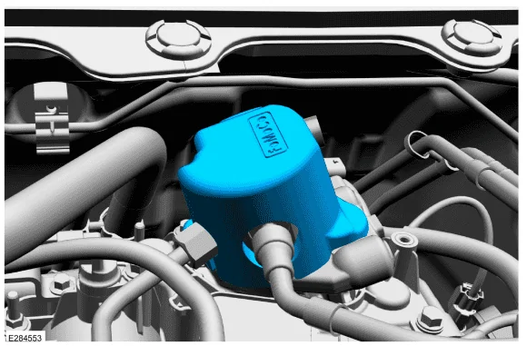

Another possible would be the HP Fuel Pump, now the HP Pump itself is driven by the Camshaft but the LP Fuel Pump (Electric) may be triggering on and trying to Prime the Fuel Rail in a non-normal manner, and the sound may be the fuel rail dumping excess pressure.
So, the command for the Fuel Pump Prime circuit may be stuck in Prime.
HP Fuel Pump - Location

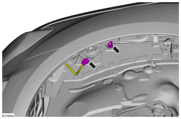

For Ref:
Truck Horn Location
Alarm Horn - Under Driver's Fender
