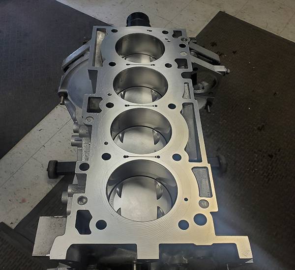

I'm glad you brought this up. Is this the definition of the closed deck? If so then the ranger does have a closed deck and not an open deck?
It's an open deck design on our engine. You can see the coolant passage around the cylinder in this photo.

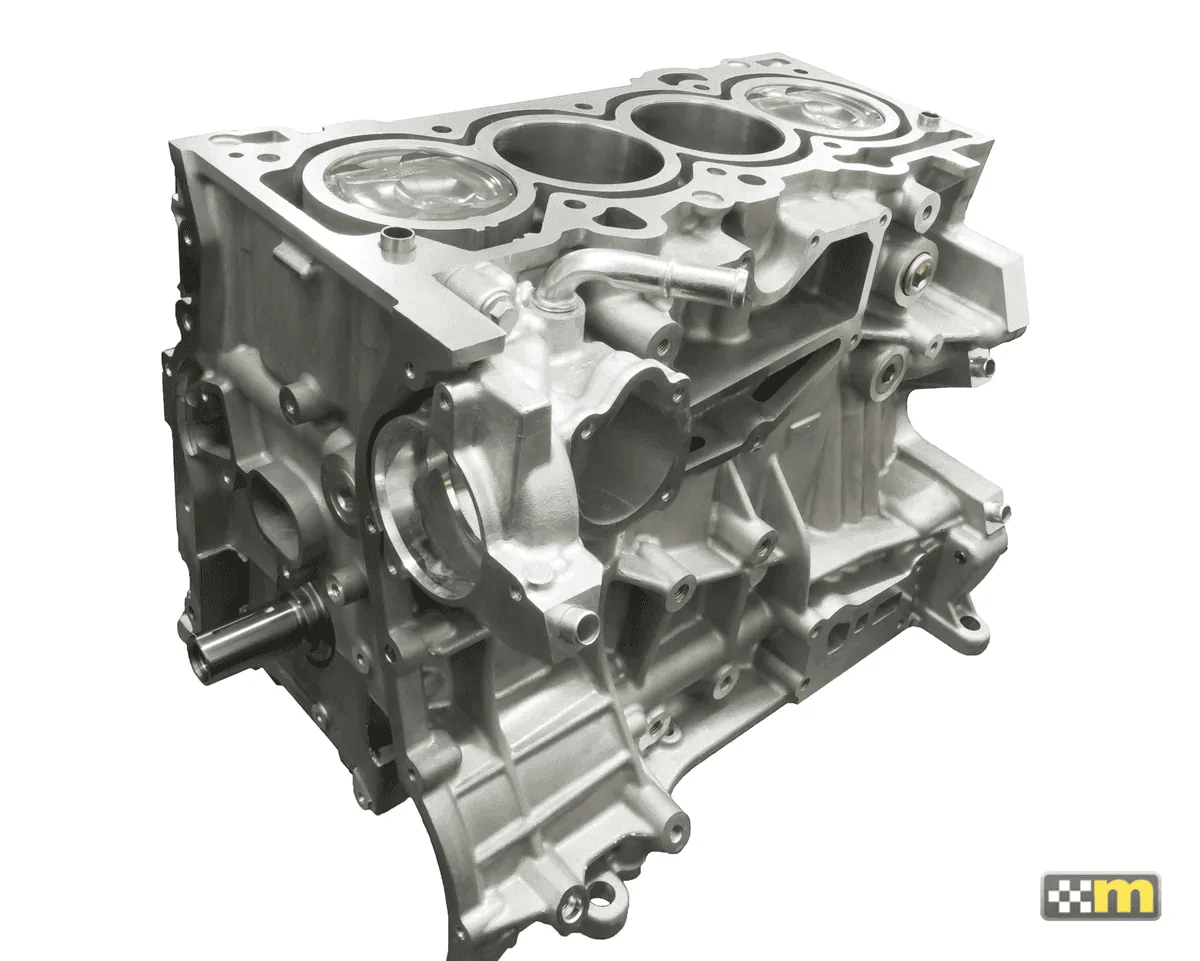

For reference - here is a closed deck 4-banger. This is NOT our engine.
Thanks for the clarification. My buddy had an open deck and bought his mustang used and shortly after had to get the bottom end replaced under warranty. He said he paid the tech extra and got the closed deck.
