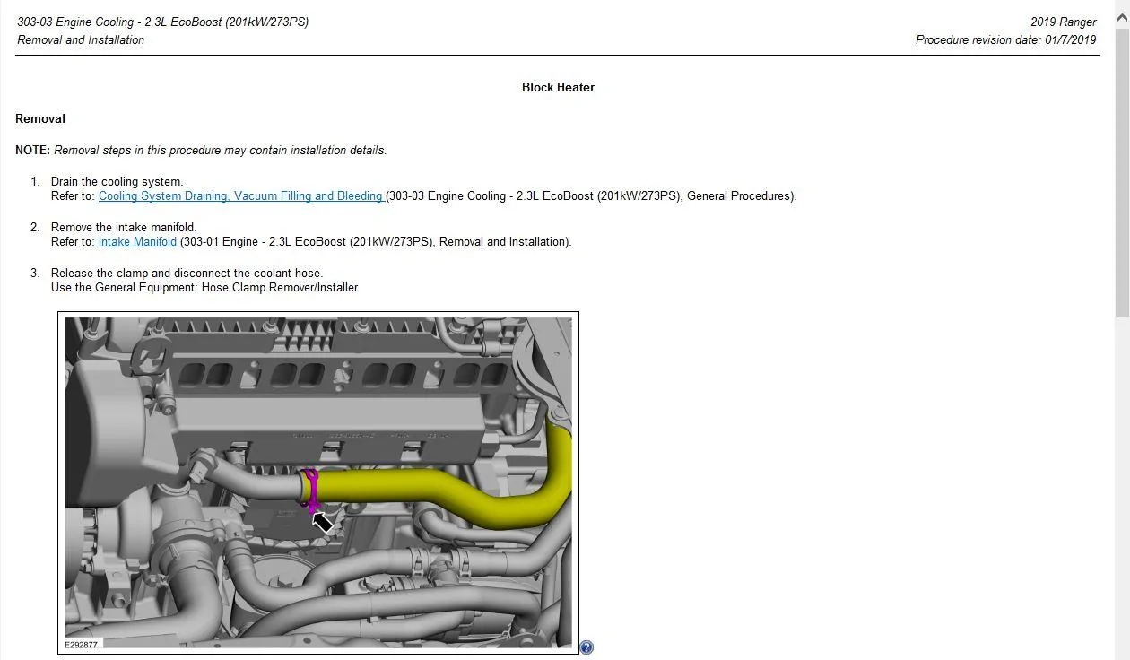

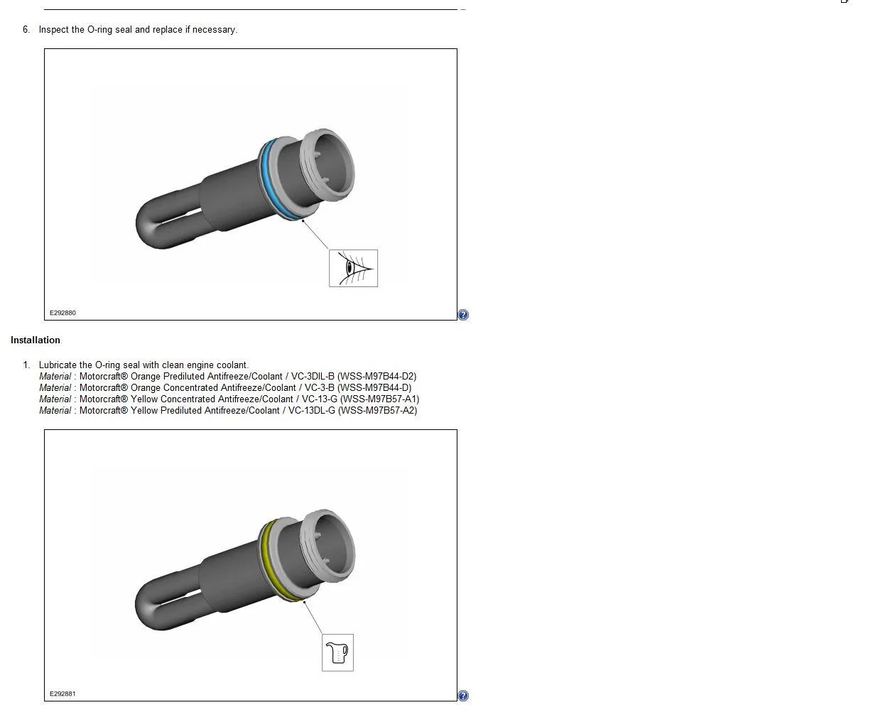

Hi Michel,
Here you go!
  1. To install, reverse the removal procedure.
  1. Fill and bleed the cooling system.
    Refer to: Cooling System Draining, Vacuum Filling and Bleeding (303-03 Engine Cooling - 2.3L EcoBoost (201kW/273PS), General Procedures).

Thanks Phil, I just took a look at the area in question and its a nightmare...

If these illustrations are indicative of the actual production parts, the design of the heater element has changed since early production. The component that the dealer sourced for my 2020 model threads into the block, with red thread sealant instead of an o-ring. The threaded section is probably 3/4" in depth, so that would indicate to me a substantial threaded boss in the block to receive the heater. That would be part number GJ7Z-6A051-B, and the electrical harness is KB3Z-6B018-B. I wonder what else may have changed. Also, the computer that I saw in the parts department showed illustrations working through the same rubber splash shield that you remove (at least partially) to change the oil filter. It also showed a large socket head (Allen-type) plug in the installation hole. I'm nearly due for an oil change, so I will poke around in there and see what access looks like from the wheel well.

The electrical harness has multiple built-in push connectors designed to fasten in specific locations in the engine bay. It seems best to use them as designed. There can only be so many variations, and I'm guessing it would be fairly obvious once the harness is attached to the heater element. The density of components in the engine bay is a serious obstacle, though, and I would feel better with an illustration that showed the intended mounting points.

Right, I am with you though about making it a diy project, which regardless of how you tacke it, you will need to at least partially drain the coolant from the engine and, by looking at the pages posted by Phil, it would seem a lot easier to just pull out the plastic intake manifold to get to the plug. I can see though why it is much cheaper to pre order your truck with the block heater rhan adding it later.....

Hi Michel,
I also get the idea that purging air from the coolant system after the install can be problematic. Indications are the best way is evac and fill, which most dealers have capability to do now.
