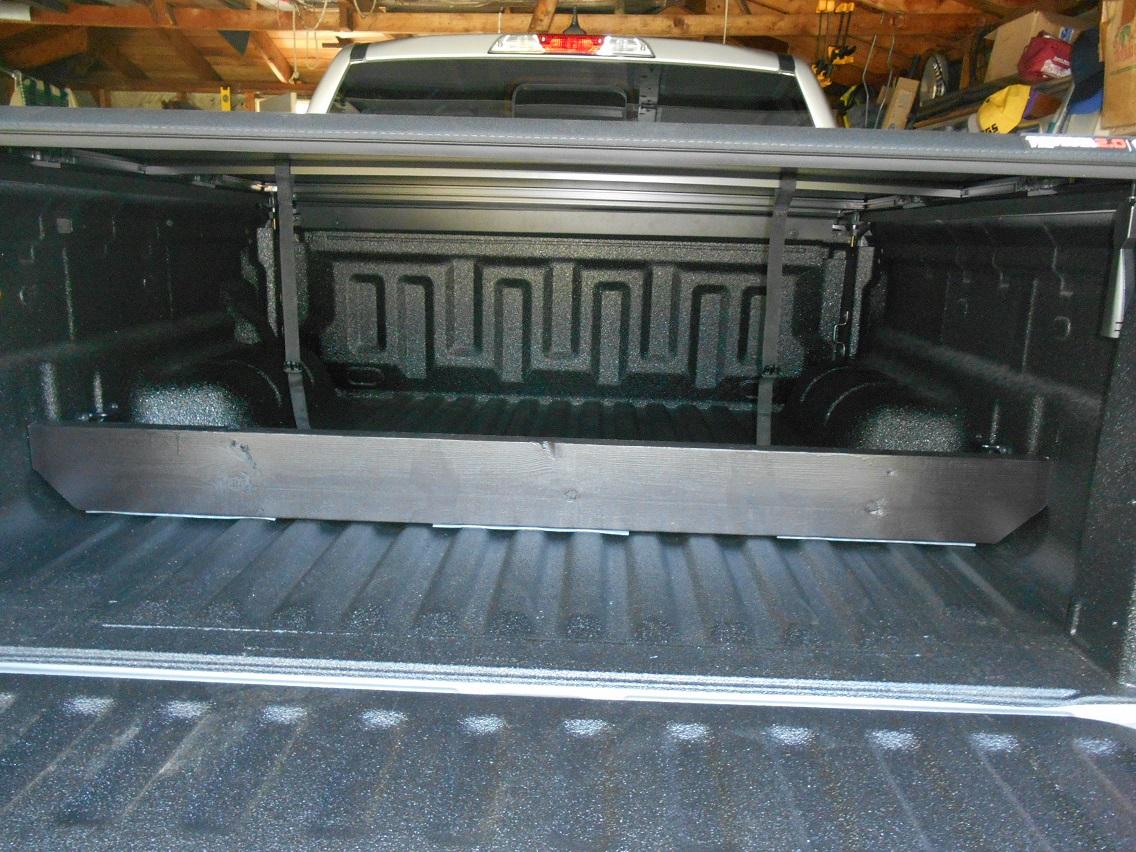

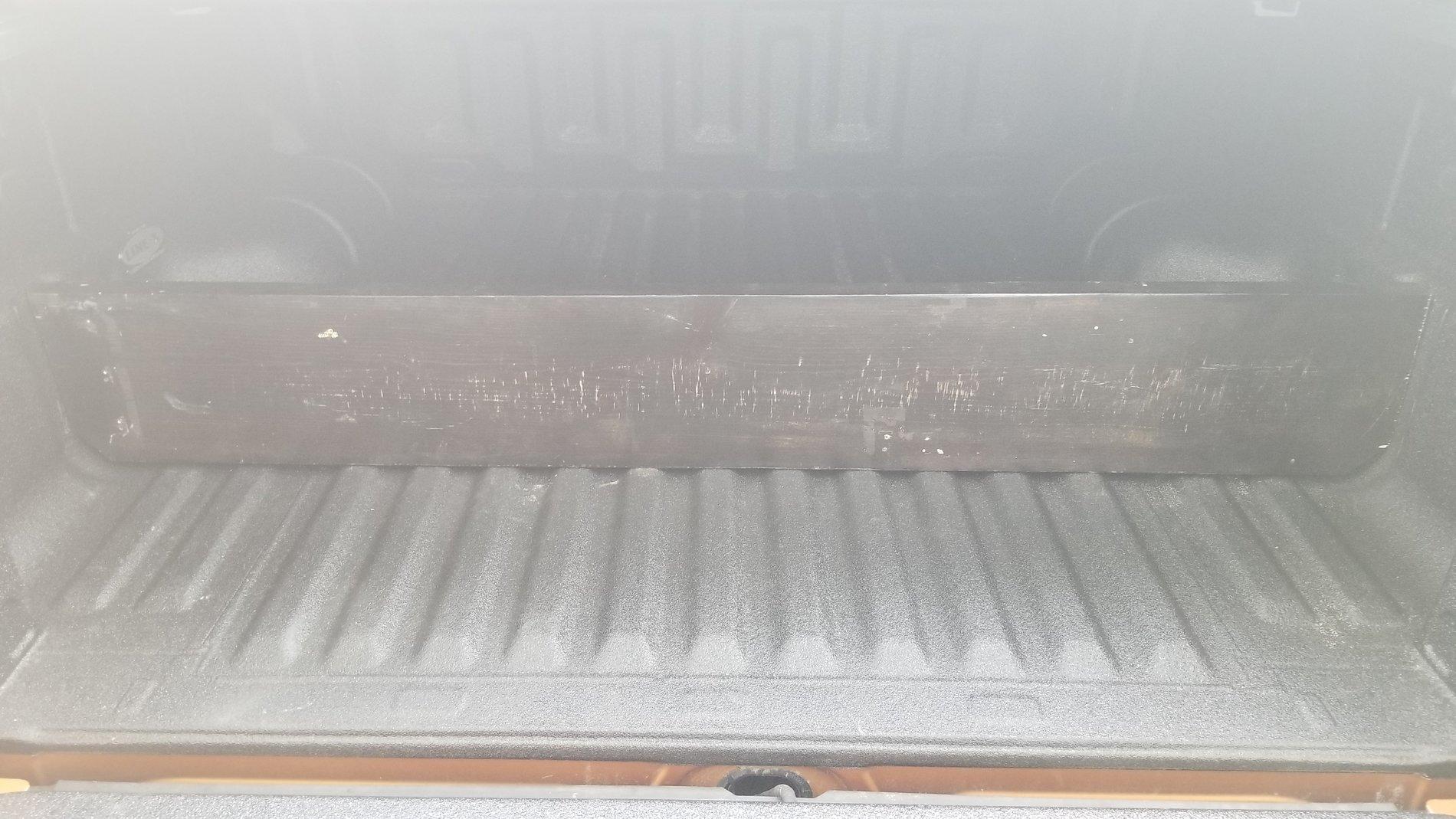

Many likely are aware but you can cut a 2x6 to act as a bed divider for hauling groceries and small items without them rolling all over the bed. Cut my piece at 62" with 2" chamfers but check your measures since I have a bed liner and ymmv. Sorry pic is cloudy, this just makes daily use of the bed much more enjoyable for me. Can develop a rattle since the 2x6 width fits a bit sloppy.
There are also shelf pockets built into the bed should you want to divide the bed horizontally too. I did not opt for this at this time but may build a shelf to store in the garage for future hauls that would benefit from this config.
