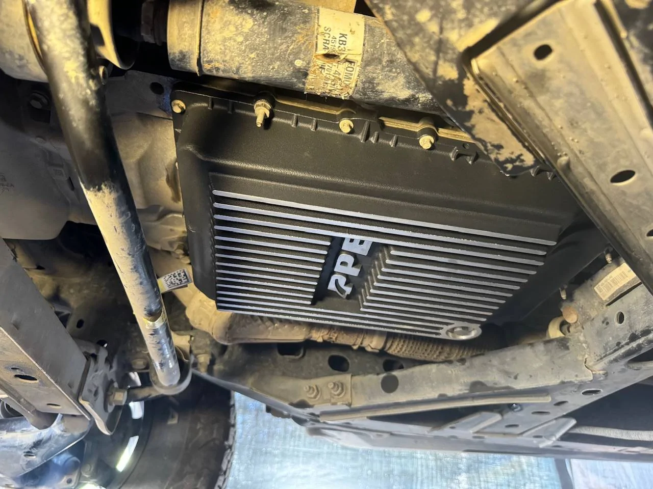

That's exactly what I experienced. I pulled 7.5qts when I changed the filter and installed a stock depth PPE pan. I refilled with exactly 7.5qts and it drove fine for the next 1k miles. Then I installed the FitzStick and found I was almost a full qt low. Even though I didn't experience any problems, I've now got transmission peace of mind and a super easy way to verify fluid level, color & condition.

The shallow PPE pan holds about .75 of a quart more than the stock pan. Verified that with PPE a while back. That's where your low level came from.

So the PPE deep pan only holds a quart more than the PPE Shallow pan.

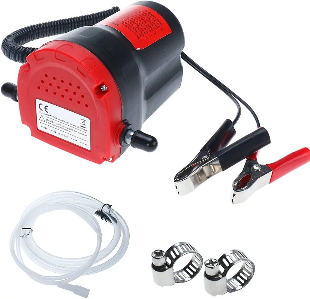

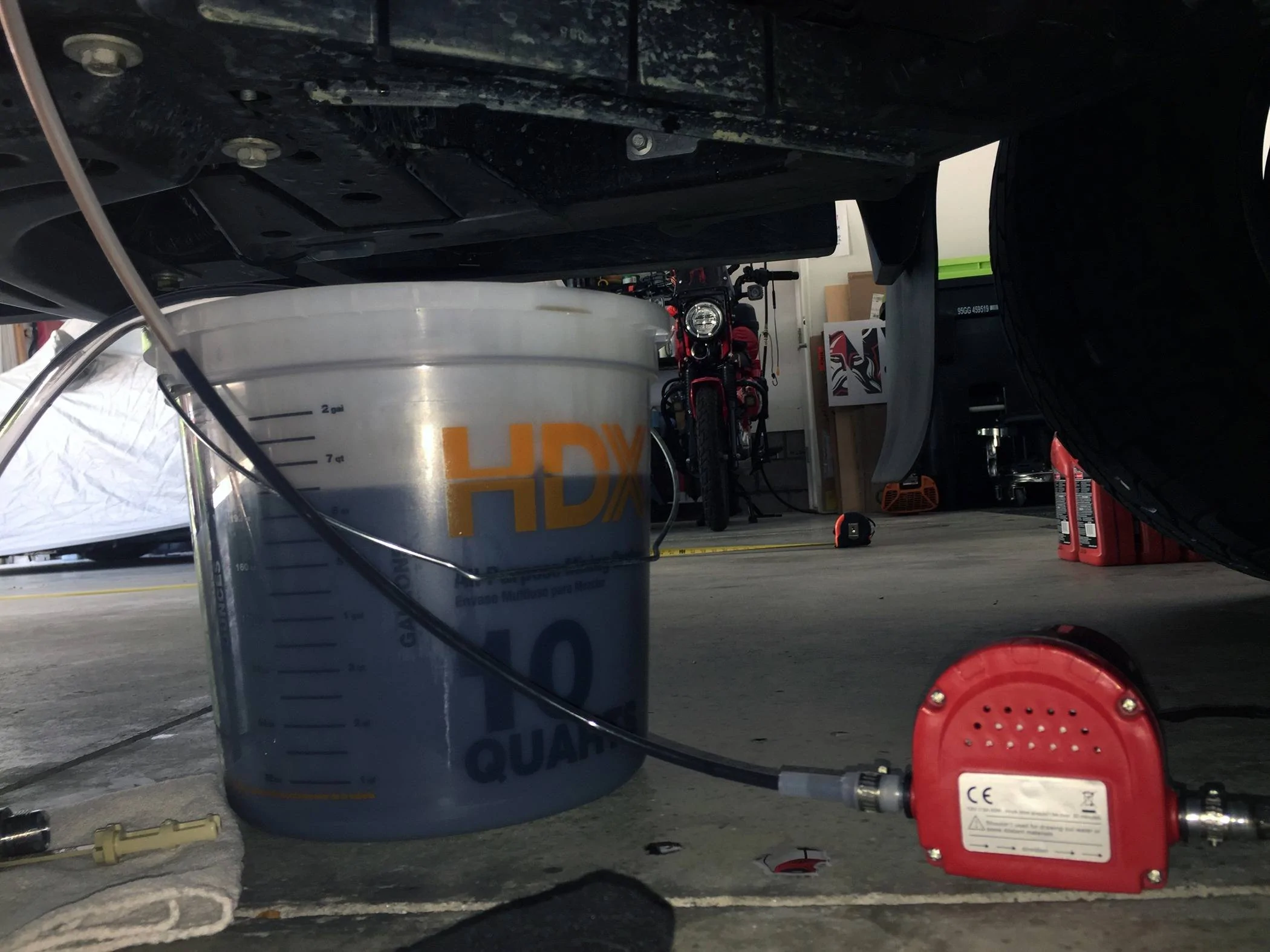

I use a $25 reversible transfer pump with 1/4" vinyl hose...insert tube into fill hole till it bottoms out at lowest level of sump...same with Fitzstick except you'll need longer tubes...quick, easy and clean...
I note how much was pumped out (mine was 7 quarts) and fill with same amount...

How did that pump work and how long did it take to pump out the 7.5 Quarts?I see some bad reviews on the pump.Just don't wont get stuck in the middle of the fluid change.Thanx
Same one I have...not long.
Just make sure and don't depend on the barbs to hold the hoses on. Back it up with some hose clamps and make sure your discharge is firmly fastened inside a jug or other receptacle.
Ask me how I know. There's nothing like spraying ATF all over the truck, garage, car parked next to it and inside the open truck windows and then having a truck you can't move outside to clean until you finish with the ATF change.
