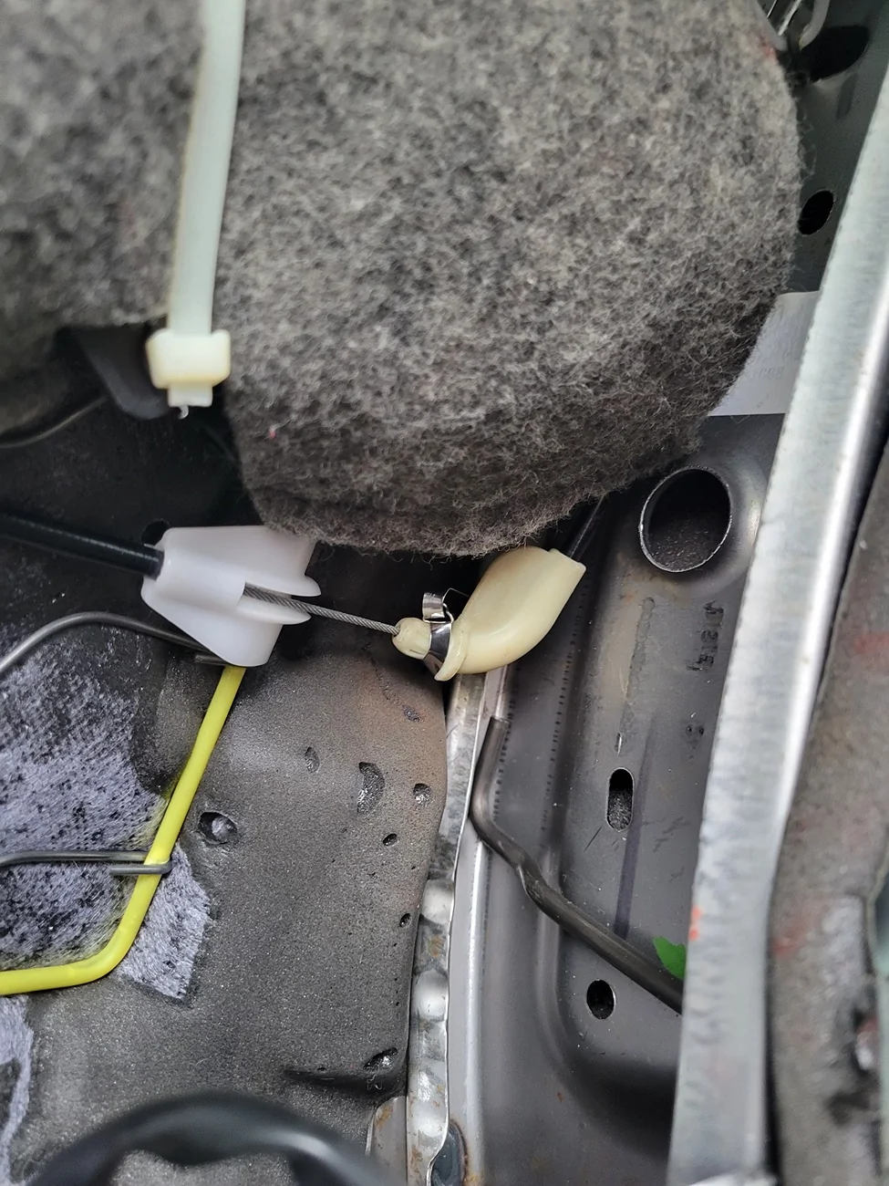

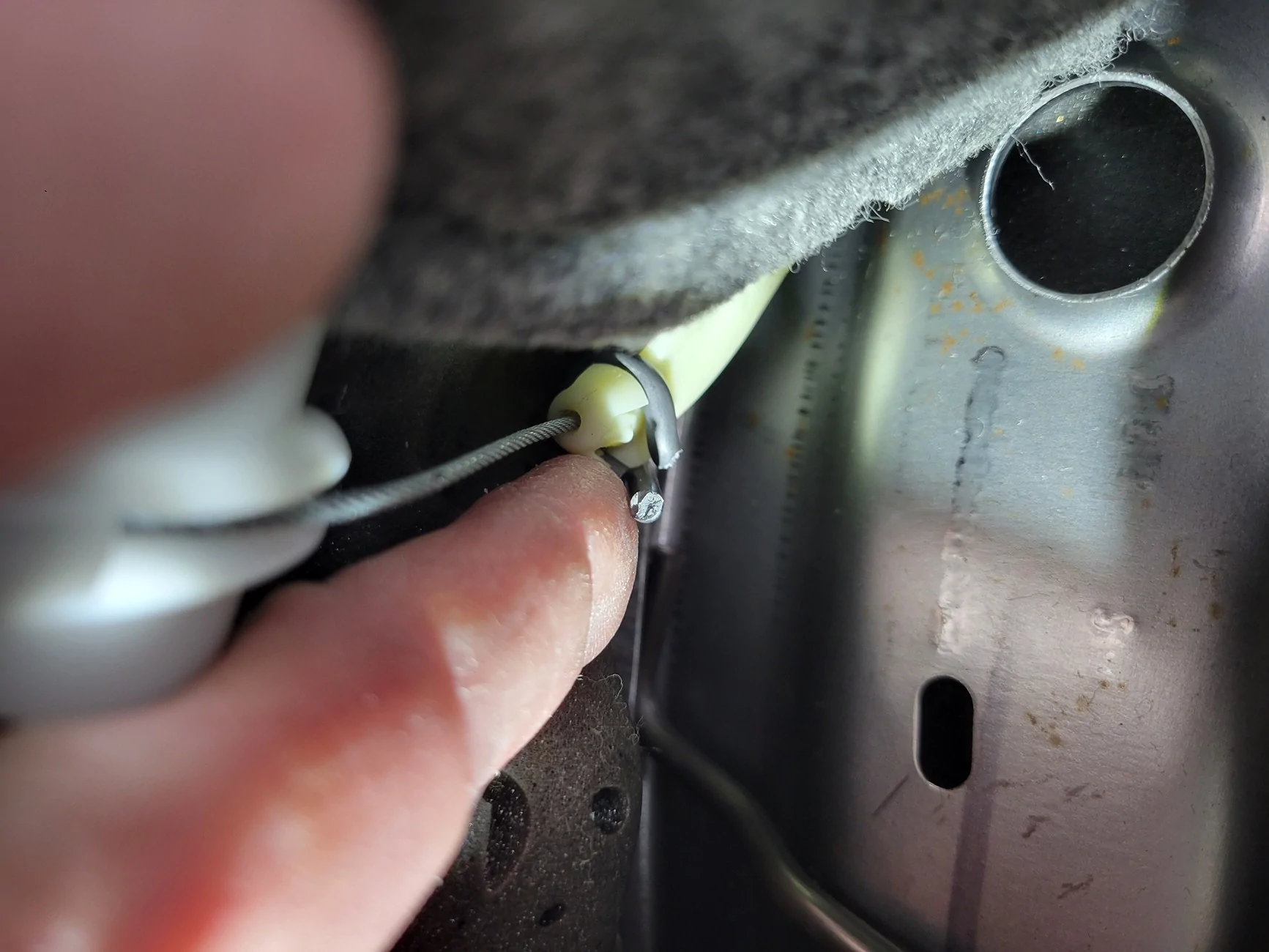

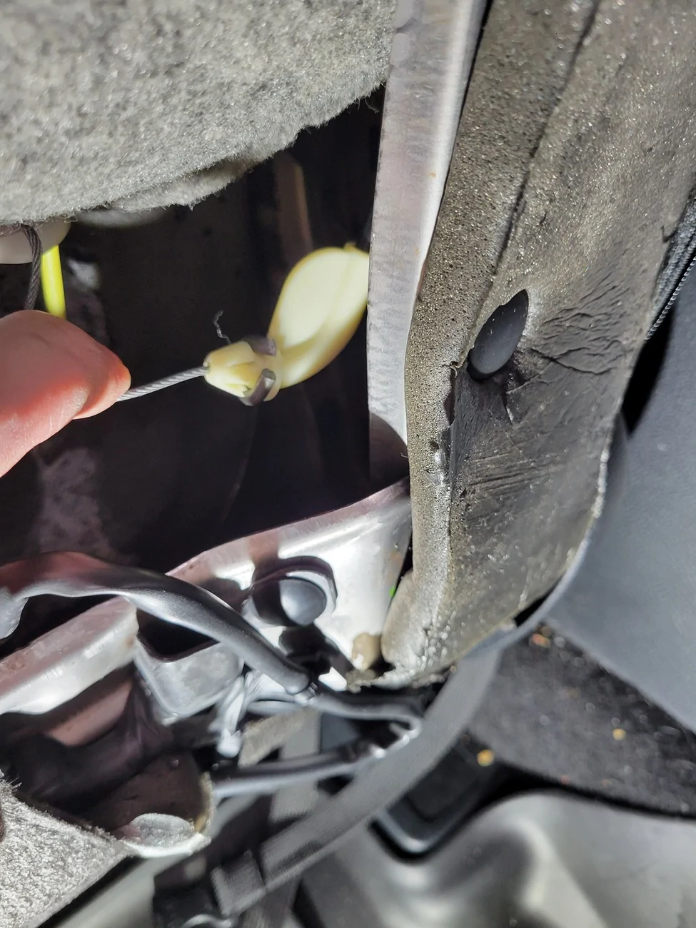

Earlier today I was adjusting myself in the drivers seat to get comfortable, and I heard a pop and my lumbar sunk all the way in. My question is what parts do I need to replace to get my lumbar support back? 2021 Tremor.
Thanks!

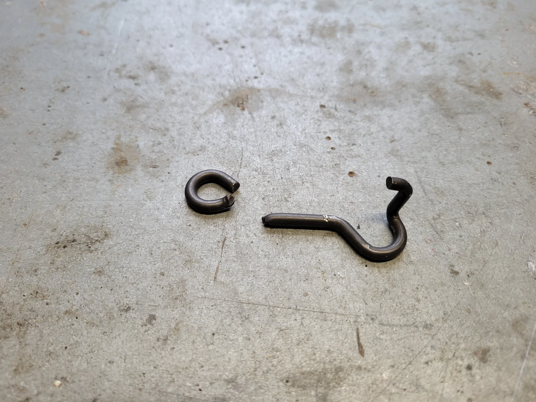

Found the culprit! Now how do I fix it?

Maybe you could find someone to weld it back together.
I dunno, its pretty thin. I'm thinking it would more than likely break in the same place.

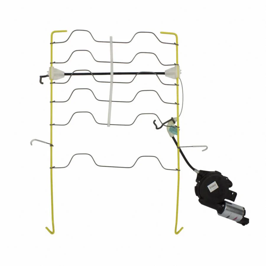

Unfortunately, its part of the assembly and not separate
