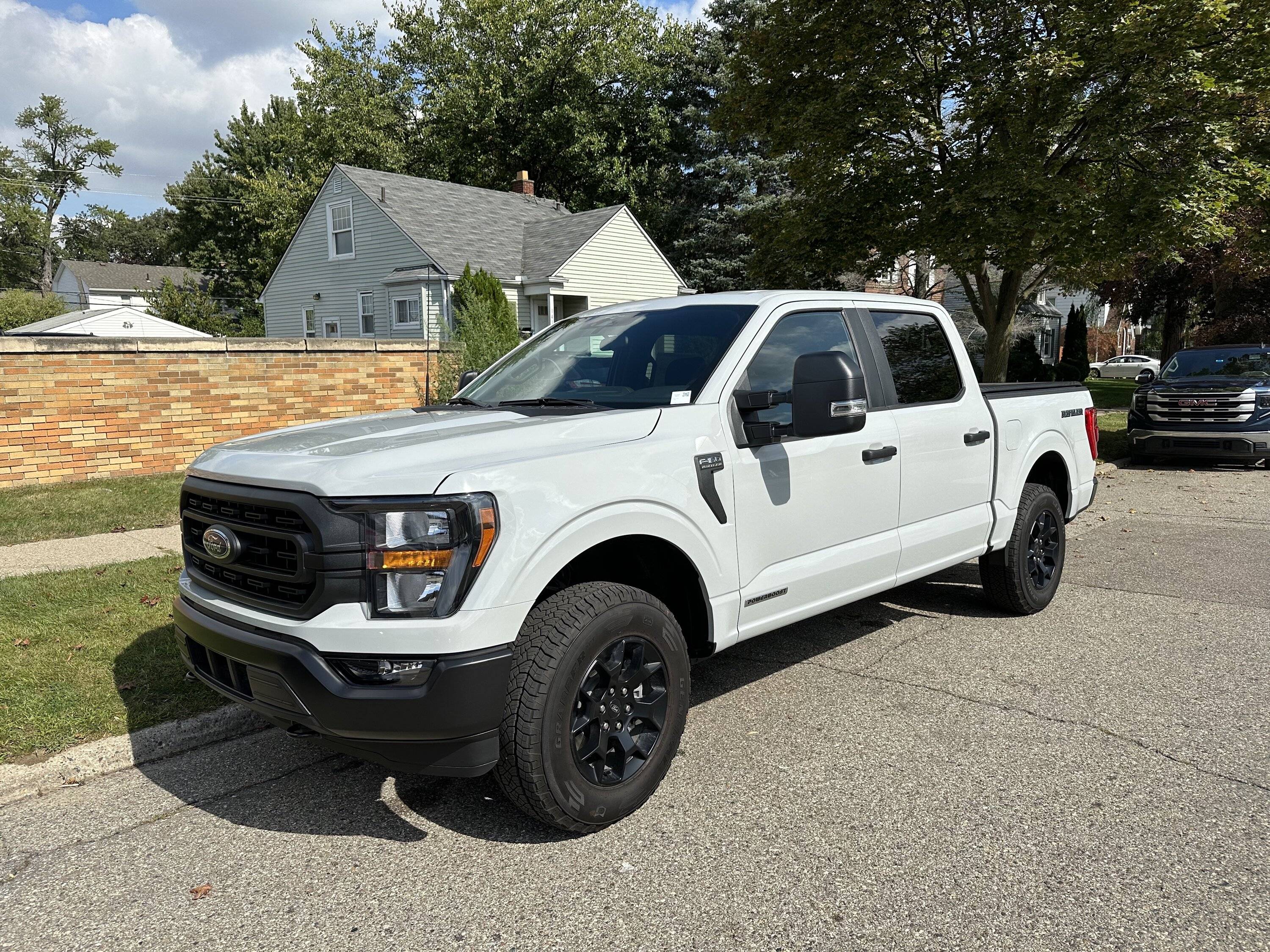

Looks like I wont be DIYing this issue, I do appreciate the comments fellas. I found a deal nearby and I dont think I can pass it up.
