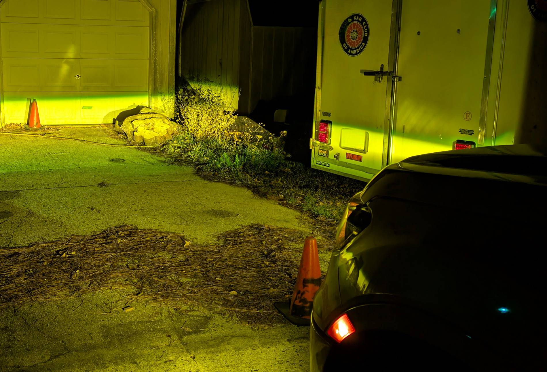

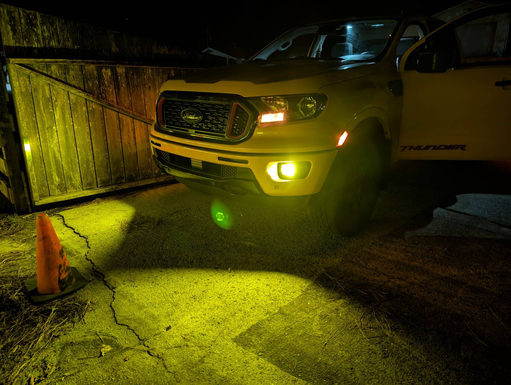

Yesterday I just took it to the shop my daughter works at and did it there on a lift I had her get that top right screw back in with her little hands, the rest I could do. I had a leak in the right front she fixed while I worked on the fog lights. Tonight, I got around to adjusting the lights. My drive way outside the garage is not level, and my garage is not long enough inside for 25' from the front to a wall. So, I put out my laser level, put it next to the truck and found the back wheels were about 2 inches lower than the front, pulled the ramps out and creeped up them until the laser was at the same level on the front and rear rims (really this means the lights are likely aimed a little low, since there is less weight on the rear tires, but that is fine since I want them a little bit low so they are not way too high with the 700lb weight on the tongue for the club trailer that I'm often towing after dark). Then since the garage entrance is not level with there the truck was either I moved the laser level onto the trailer between the truck and the garage and out the laser right in the middle of the fog light, then marked 4" down on the garage from where the laser was on the garage. Worked out well I think, this is after backing off of the ramps. The cone right in front of the truck is 25' from the garage door.
