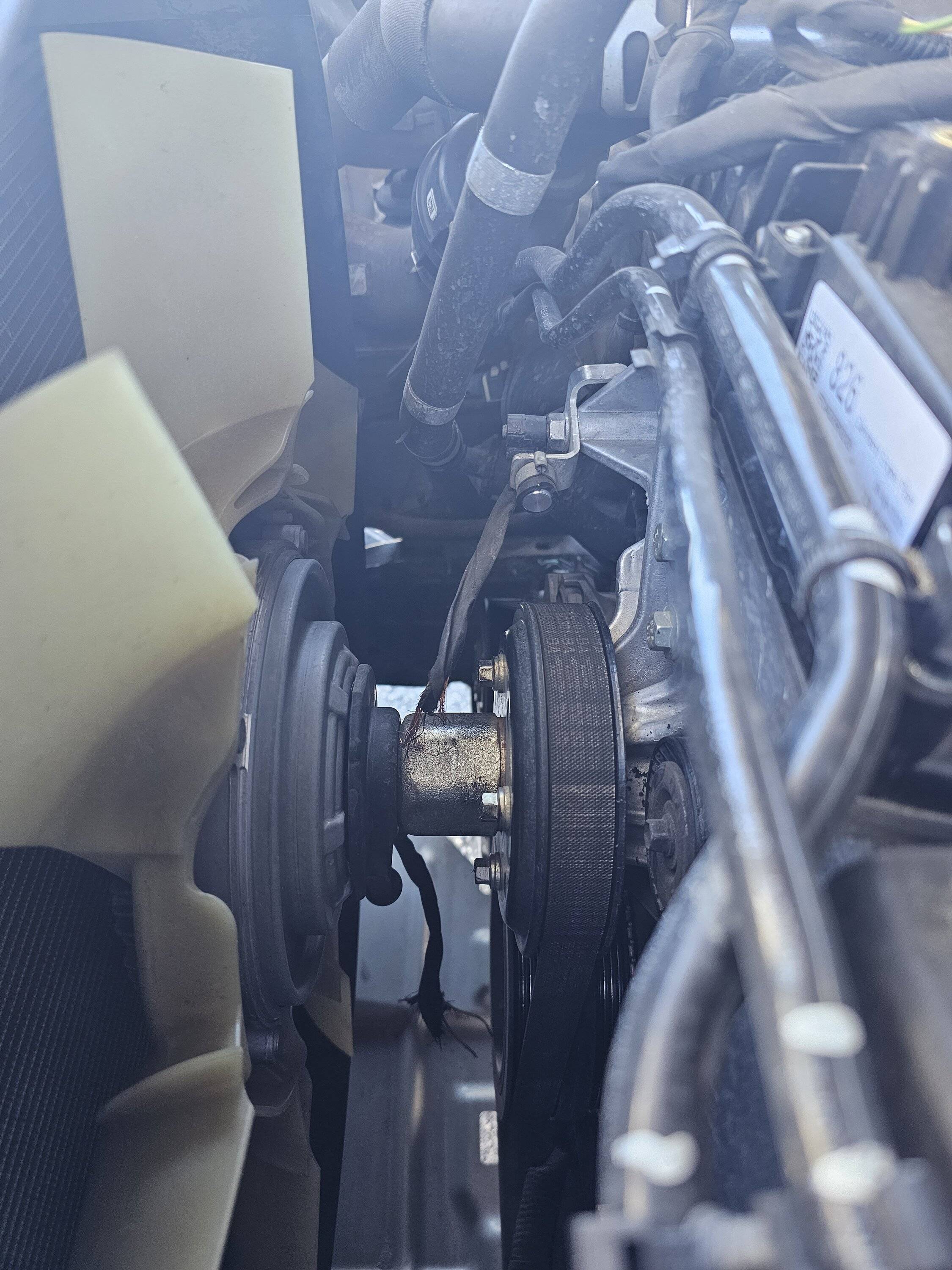

Aside from a major oops that resulted in a new engine, I had similar issues in the first two years from day 1. I tolerated it because they were inconvenient at worst and the warranty covered everything with no fuss. I'm feeling much less tolerant after yesterday's fiasco...
My wife was driving on I275 in Tampa when the truck just died at 50 mph. Locals refer to this stretch of road as "malfunction junction" as it is a 5-6 lane road that funnels all local traffic either into or through Tampa. Really bad spot to have problems. Luckily my wife kept it cool and coasted safely off the interstate into a parking lot. The dash is lit up like a Christmas tree and revving to 3000 rpm when she tried starting it again. She popped the hood and found the cable to the rad fan sensor was ripped in half, just dangling there (Pic below).

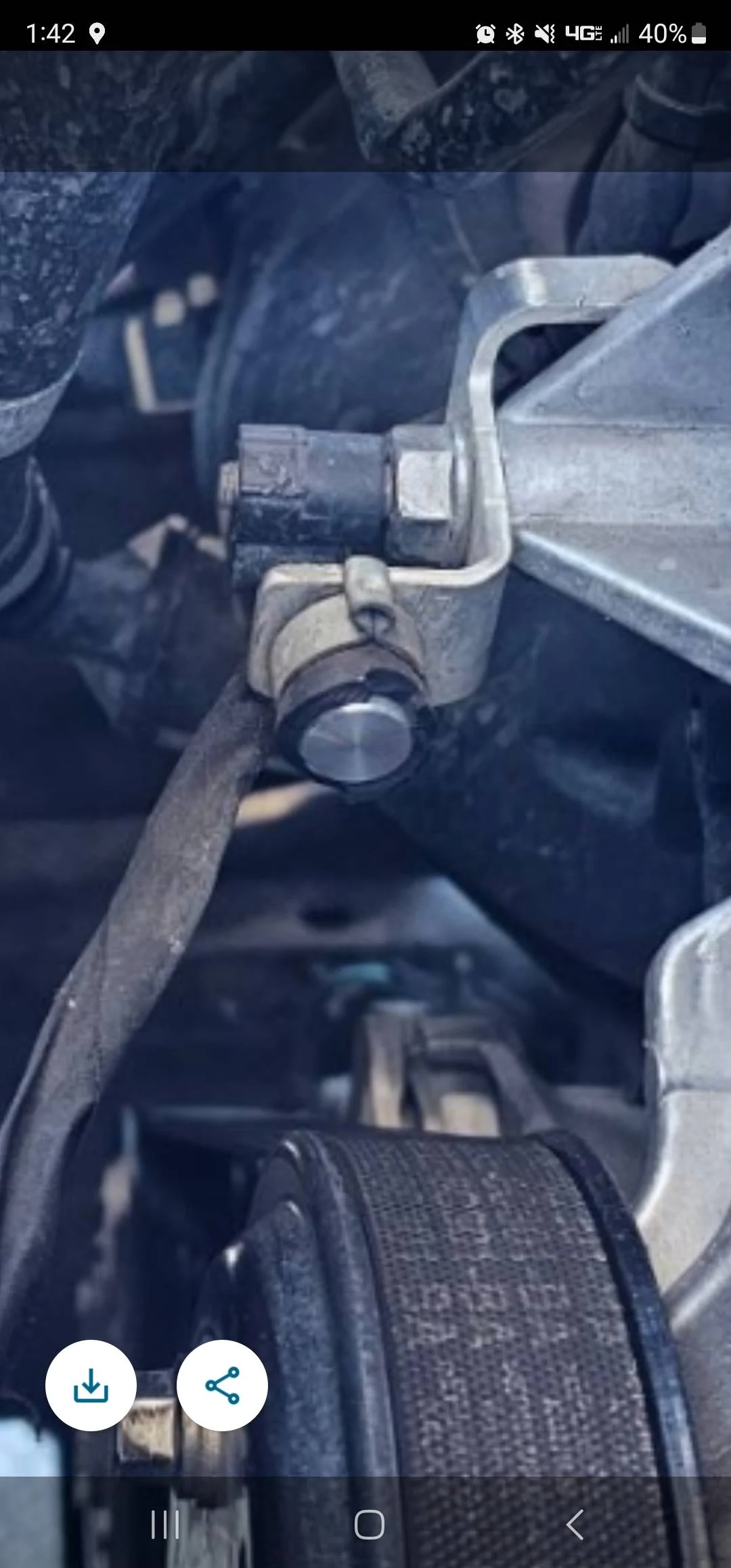

Looking at the design for this system, it appears the wire is held up by a short section of rubber hose. Only evidence I have of this hose is the piece left behind on its mounting point shown below. This hose failed, fell down into the spinning pulley below and then the wire got ripped in half.
I've been driving this truck through BFE blissfully unaware of how close the truck has been to just cutting it's own lifeline. Sure I could go in and secure this wire, but what other system on the truck is one bump away from gutting itself?
Not trying to be dramatic, but I really don't feel I can trust this truck to get me home anymore.

damn what a stupid design. Them rubber tubes always dry rot quickly. I wonder what they were thinking. Is your wife a power lifter? How did she manage to steer that mofo through several lanes of traffic? Glad she’s ok.
