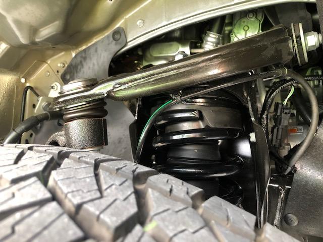

Hey just a quick heads up for anyone using this kit. In the directions it tells you to remover lower strut studs by placing strut in vice and to hit the studs out. My word of advice is that is going to be very difficult. I have a harbor freight 12 ton press and used that to remove them. Using the press takes about 5 minutes per strut. Once studs are removed the whole job is done in about 3 hours. The upside to Daystar is the spacer is polymer so it won't rust and look like crap over time. I have done about 8 lift kits and leveling kits in the past. This was the first time I did one by removing lower control arm and have to say I believe this way was much faster, a lot less stuff to disconnect. Like I said just a heads up for anyone considering it.

Ride is exactly same as stock as this system sits on top of the strut with 1.5" spacer. Ride gets effected when you install strut spring spacers for the lift.

When you install a top spacer on the strut it doesn't effect the spring load so the shock functions same as it was from the factory. When you disassemble the strut to put in a preload spacer in for the lift, the spring is under more tension so you can get a slightly more bouncy ride. RC sits on top so ride quality won't change. My truck has FX off road and I like the ride so I didn't want to buy new struts because I wasn't sure how they would ride.
