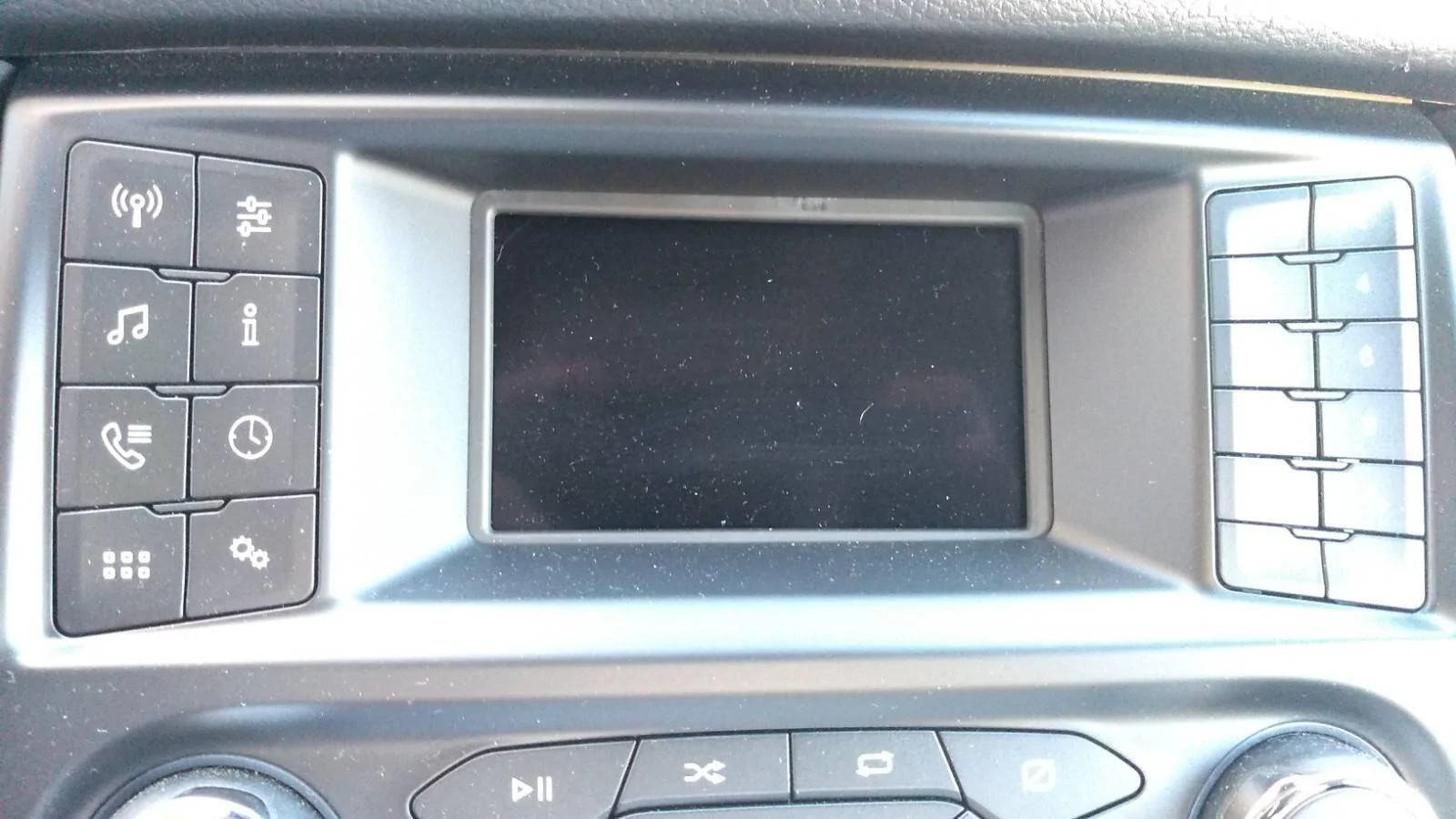

Hey guys! On 2 occasions, while driving, the screen goes dark. The radio and heat still works, although I can’t adjust them… after I stopped and turned truck off, when I restarted the screen worked fine. Am I headed for trouble?

This has happened to me a few times on the little Sync screen. By a few, I mean like 3 times in 3 years.
I'm driving, listening to a good tune, then it goes blank. I punch all the side buttons and nothing. Hit the power button and nada. But restarting the truck clears it and all's fine (hard to do at 70 mph).

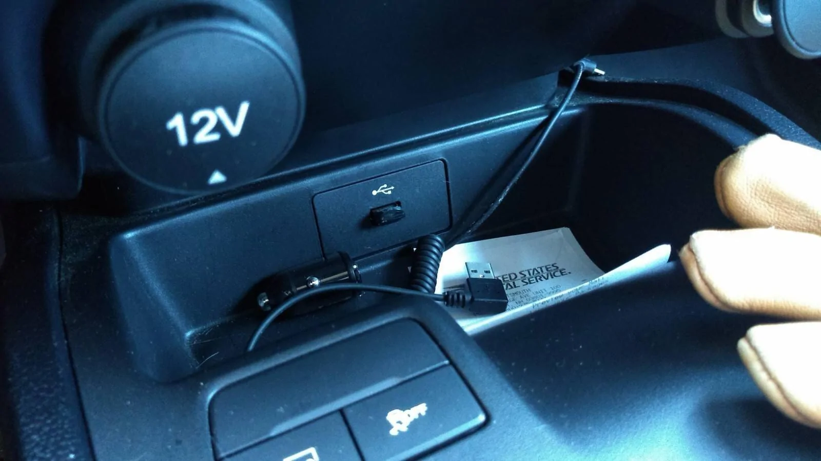

Sorry to hear that the USB update fails. I have an XL, so it's a much smaller update (no maps). And the USB method has worked 3 times for me.
Now the upload XML file on the Ford site has never worked for me (same for many others too).
I have a small dedicated USB for mine, nothing else on it. I always reformat it before doing an update.
Plus I only have one USB port. I believe you have at least two ports but I also believe that both are not identical in function, so could that be the reason yours fails?
https://www.ranger5g.com/forum/threads/sync-3-4-21194-update.22165/post-491058
