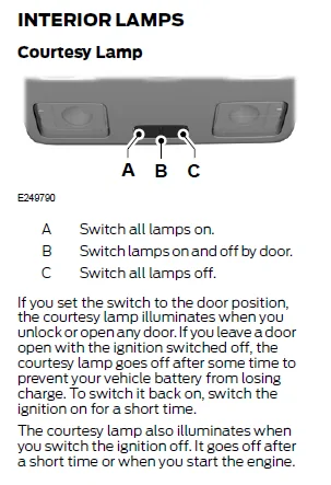

I was wondering about why the overhead courtesy light doesn't come on when I open the driver's side door (haven't looked in the manual yet) like my Mountaineer does. Would sure make it easier to put the key in the ignition when it's dark.
