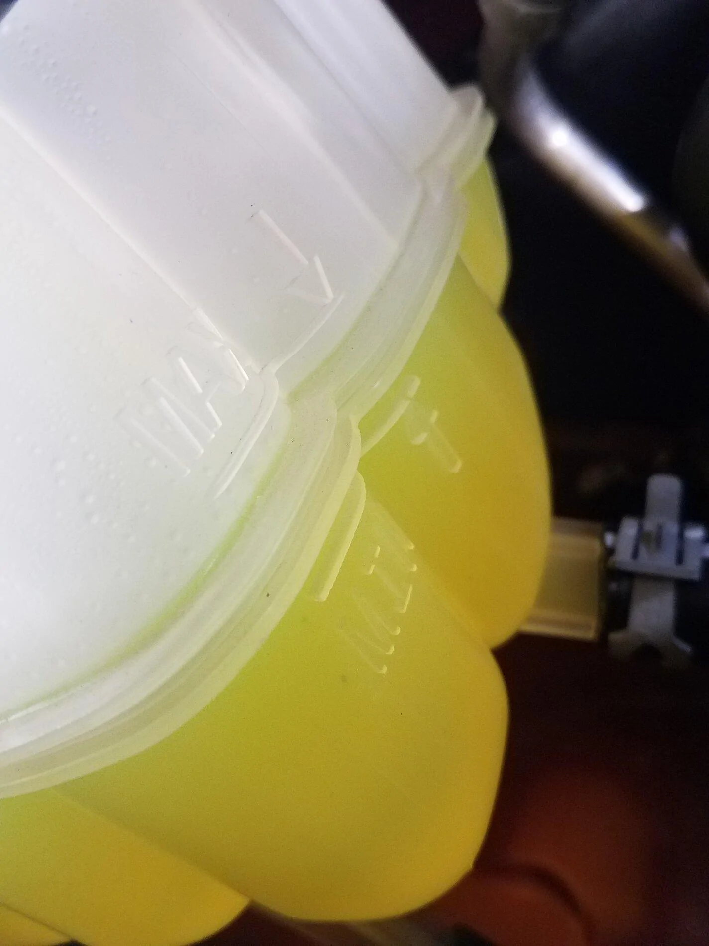

I guess I must have had bad lighting that one day.
Defn looks more yellowish now.
Crisis averted.....
I could have sworn it was green the other day. haha

It's okay some of the yellow coolant will look green just because that's how things are. Sometimes the green coolants will also look yellow if set in the right position of light.
