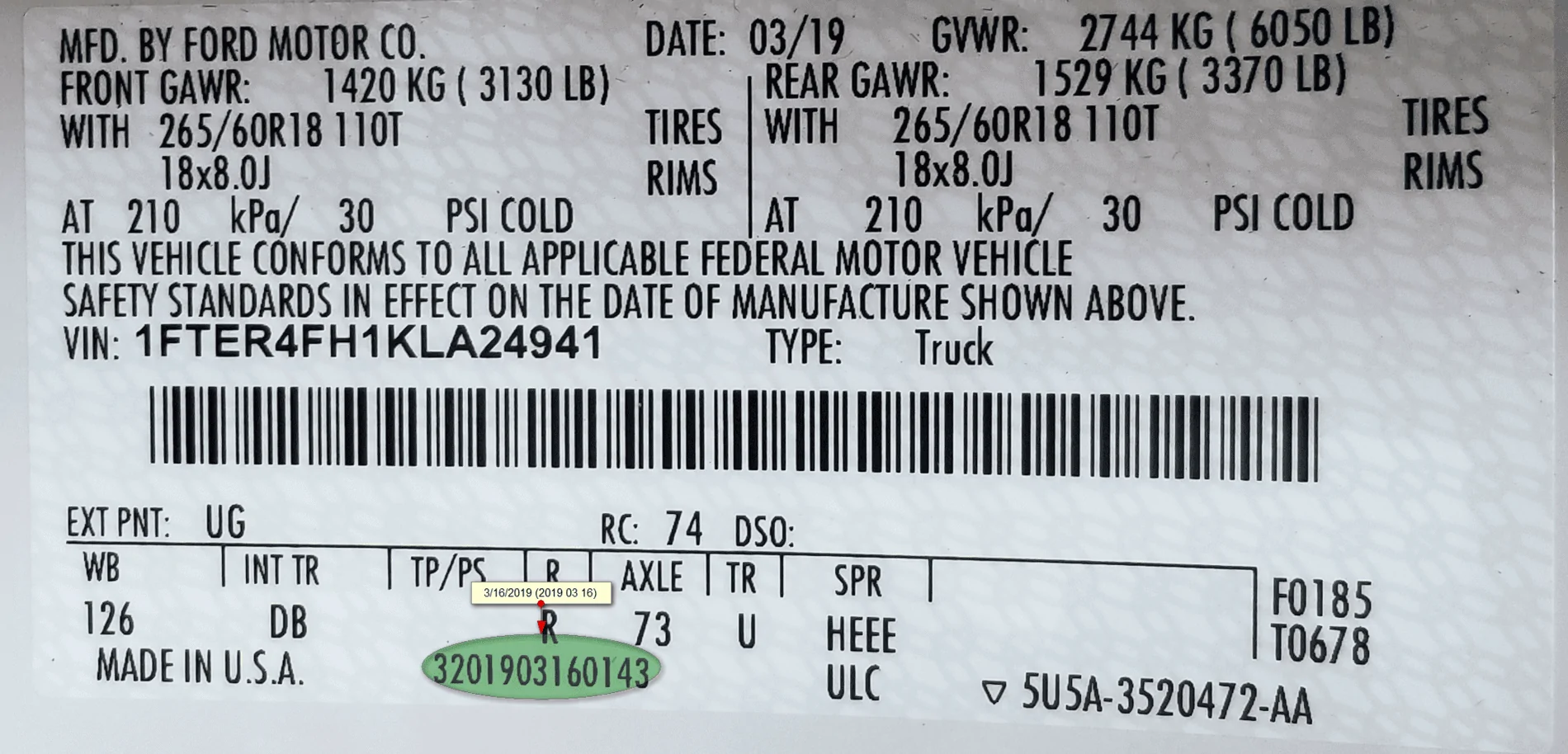

If you had an early 2019 build (before 7/8/2019) you would have had orange coolant from the factory - after that they changed to yellow coolant.
The Orange coolant is good for 100k miles - the yellow is good for 200k miles - but if you replace the orange with the yellow, it will only be good for 100k. I guess it is only 200k on a clean fill of the yellow stuff.
You can find the build date on your door sticker:
The circled part is your "blend date" - this is mine - my blend date is 3/16/2019 (2019 03 16)
