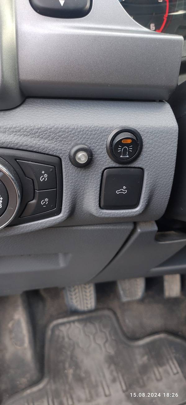

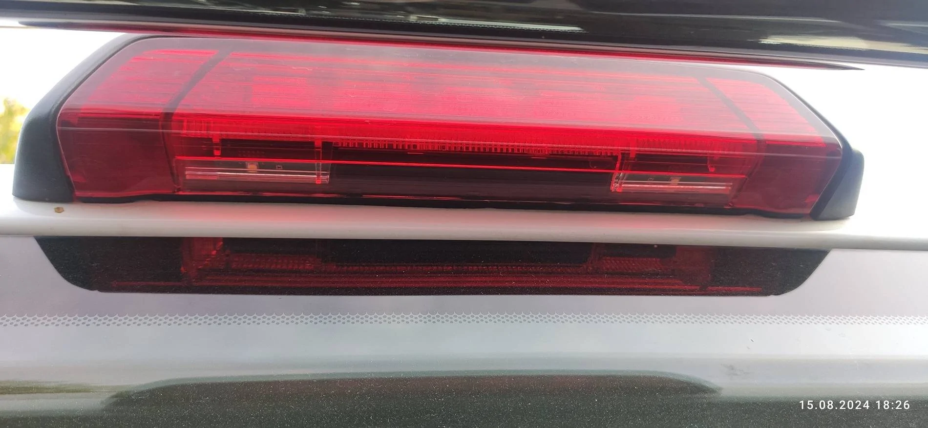

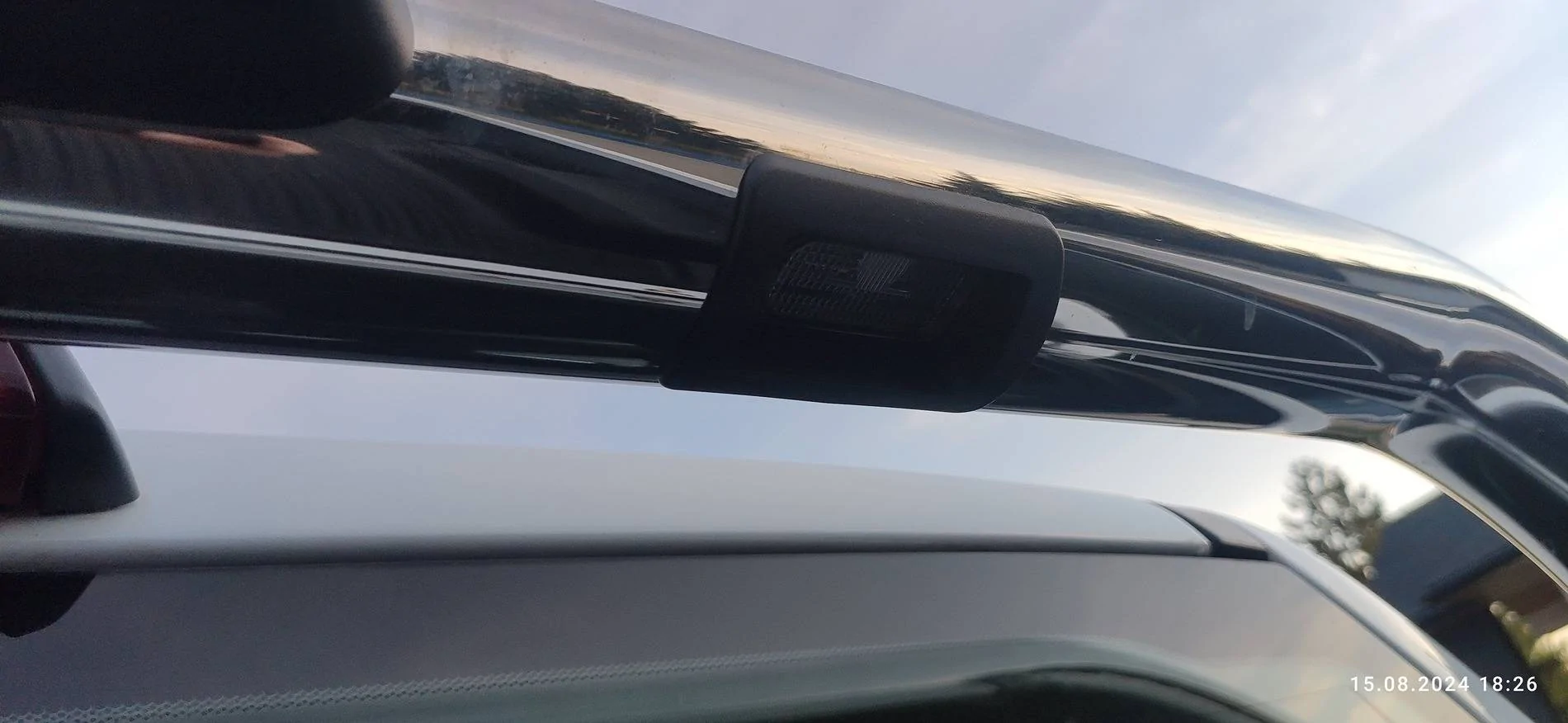

I know you can connect to the wiring harness anywhere, but I preferred the factory solution. I have a switch for the cargo area lighting in the cabin, and in the roll bar, in addition to the third brake light, there is also additional lighting that I also want to connect.
Does anyone have a diagram or the original roll bar and can check where it is connected?
Currently, when I press this button in the cabin, nothing comes on... and I think it should be the white illumination of the third brake light on the roof. It is possible that it is decoded because when I bought the car it had a body.

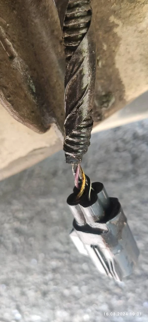

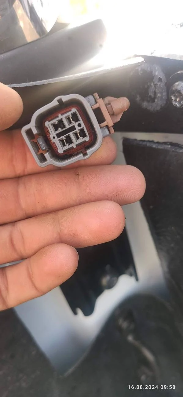

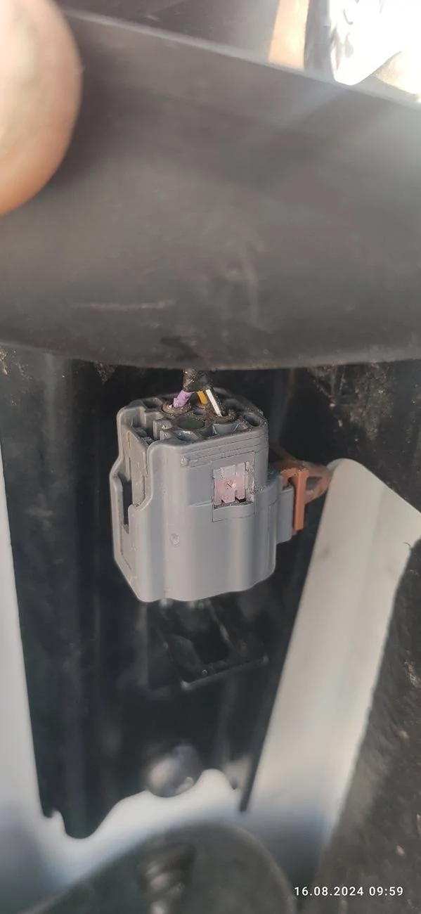

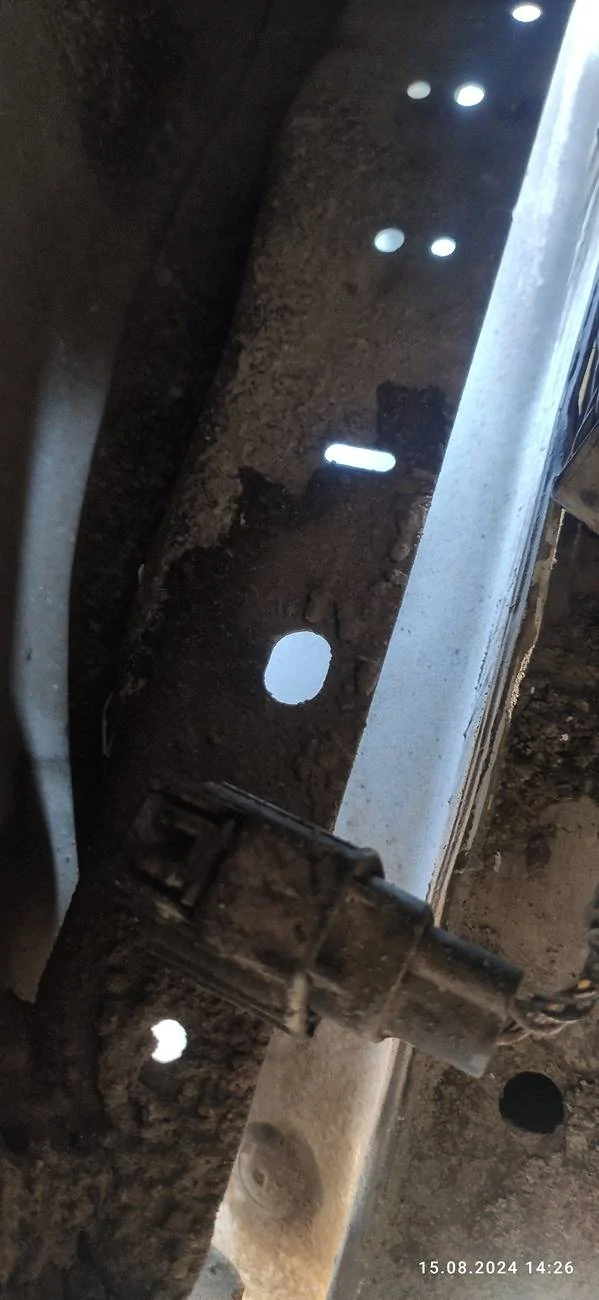

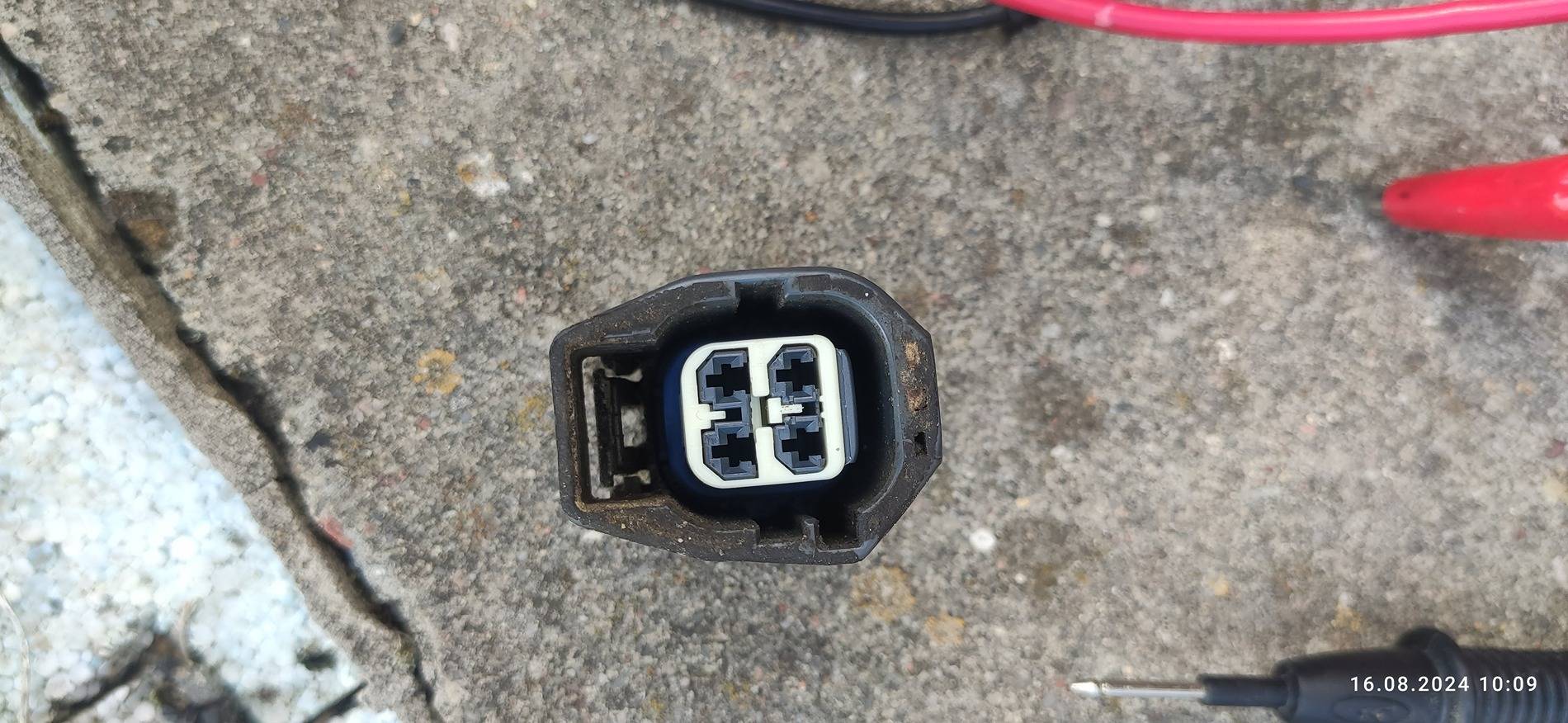

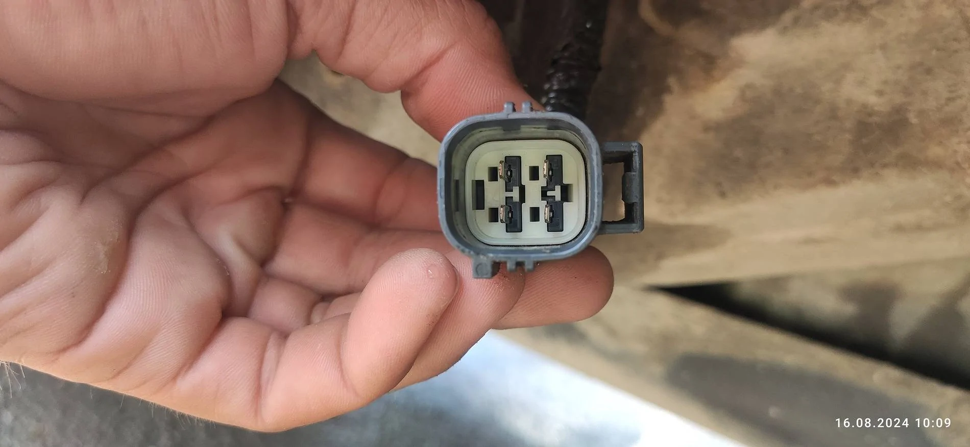

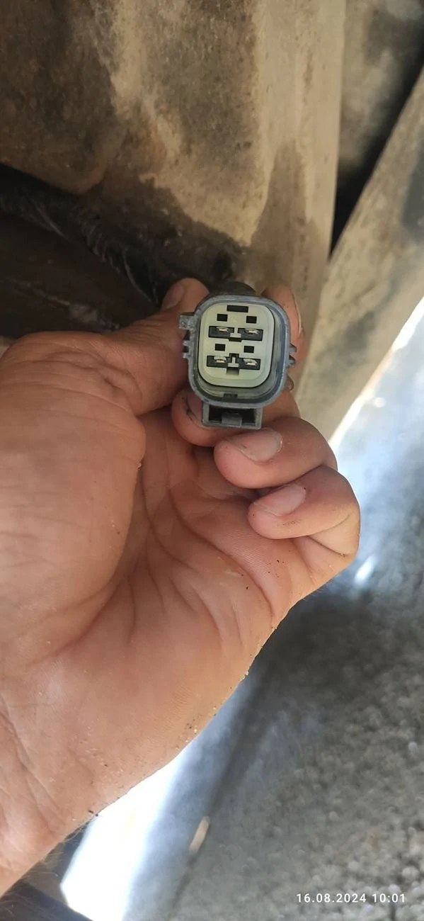

I've got it!
This free plug under the car is what I'm looking for! Today I took a meter and measured it and everything is correct, there is a brake light and cargo space lighting in this plug :) the only thing I need now is either the original harness connecting this plug with the plug in the rollbar or I can make it myself, I just need to have such plugs. Do you know where I can buy them, Amazon, AliExpress?
I found it on AliExpress, it's cheap so I blindly ordered it! I will let you know if they fit and what the quality was.
https://a.aliexpress.com/_EwZwpzX
https://a.aliexpress.com/_EIE3obn

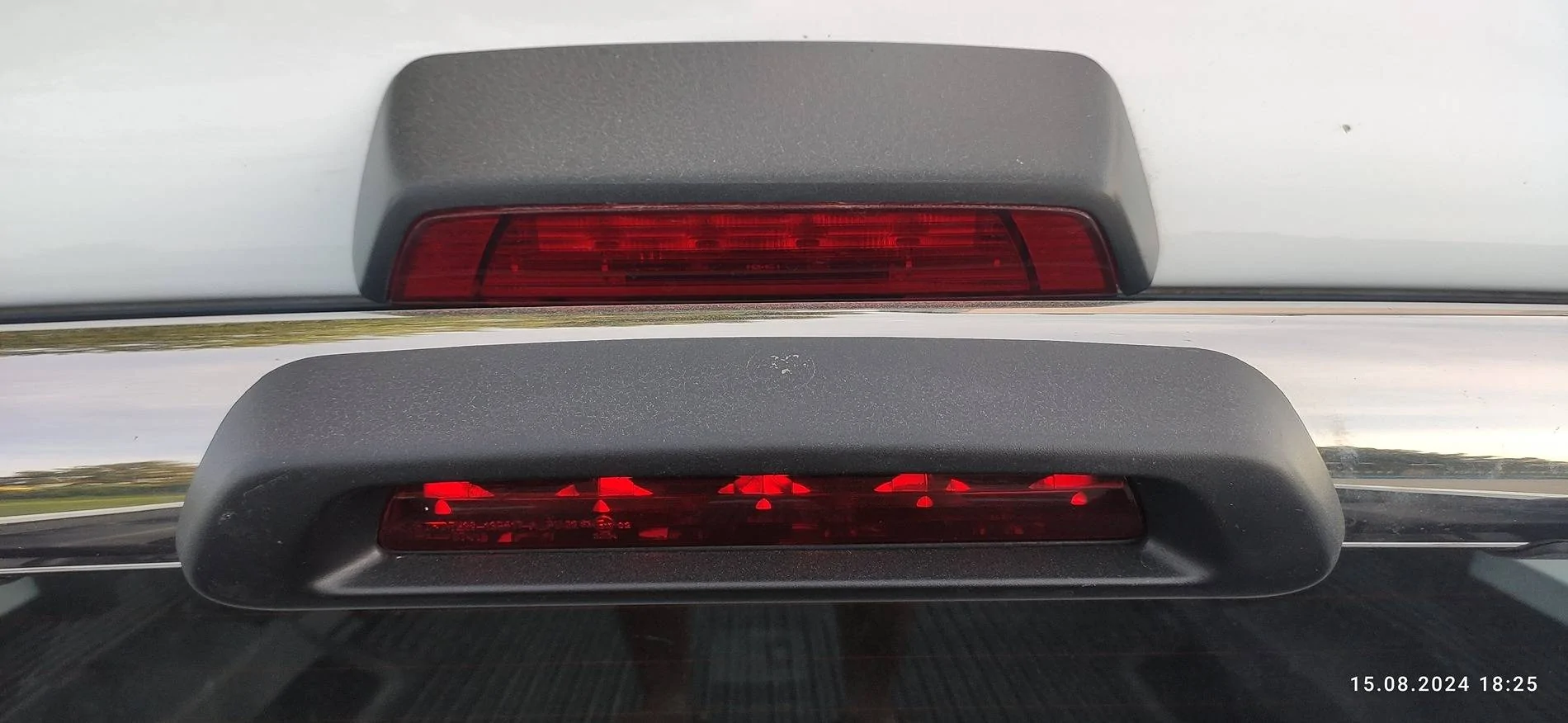

Problem solved, the third stop light and the cargo space lighting in the rollbar are connected :) These plugs from AliExpress are OK, fit like factory ones, good quality, I recommend.
