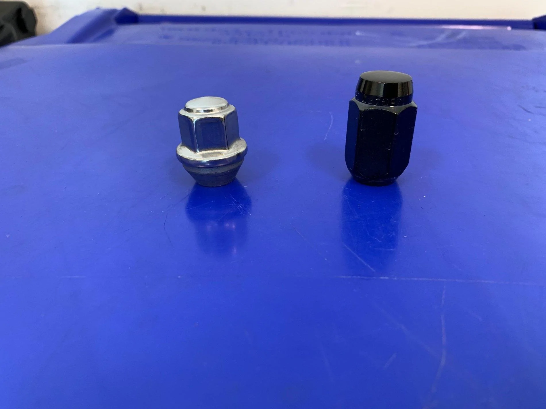

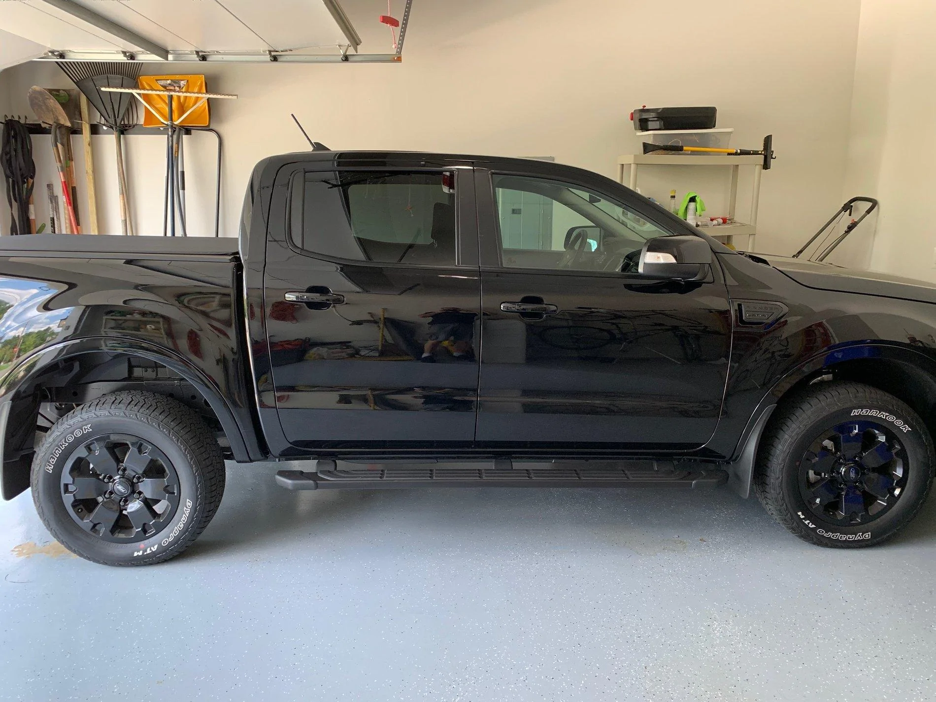

Ok, so interesting experience so far. I ordered the black lug nuts through Panda and it's the McGard set, with a wheel lock (bonus, I've used them before and liked them).
First, the lug nuts absolutely scratch up from the first installation. That was disappointing, but understandable.

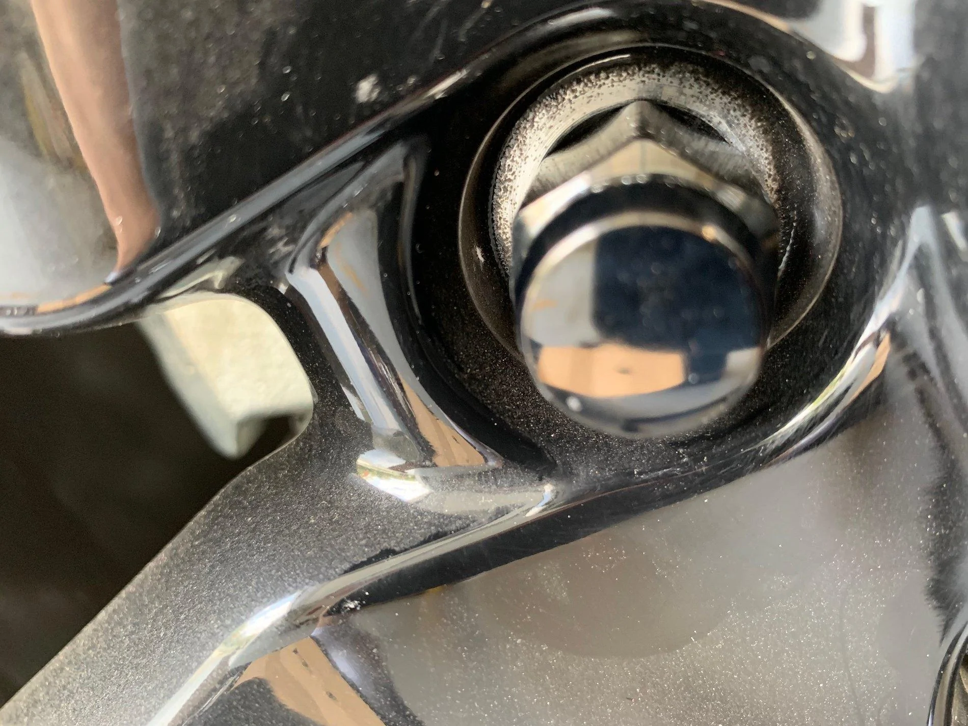

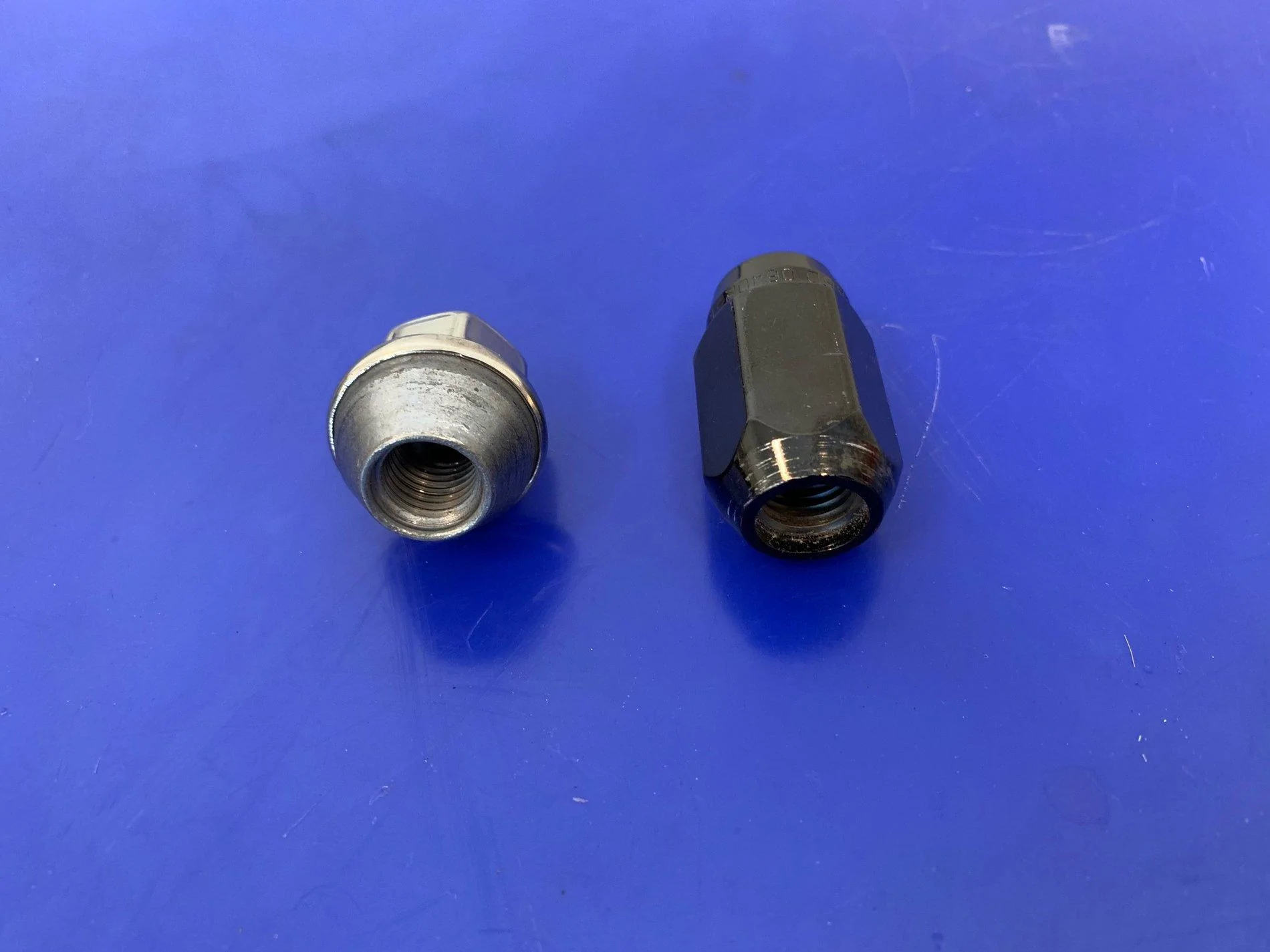

Second, though - the lug nuts I was sent leave quite the gap in the hole for the lug bolt. Enough that it's concerned me and I'm returning the lug nuts. And beyond my non-expert safety concerns, I also was going for the blacked-out look, so it didn't make sense to then leave a plain steel/metal looking ring around each lug nut. Bleh.
I contacted McGard and they gave me a different set of part numbers for the Ranger. And those would also be too narrow.

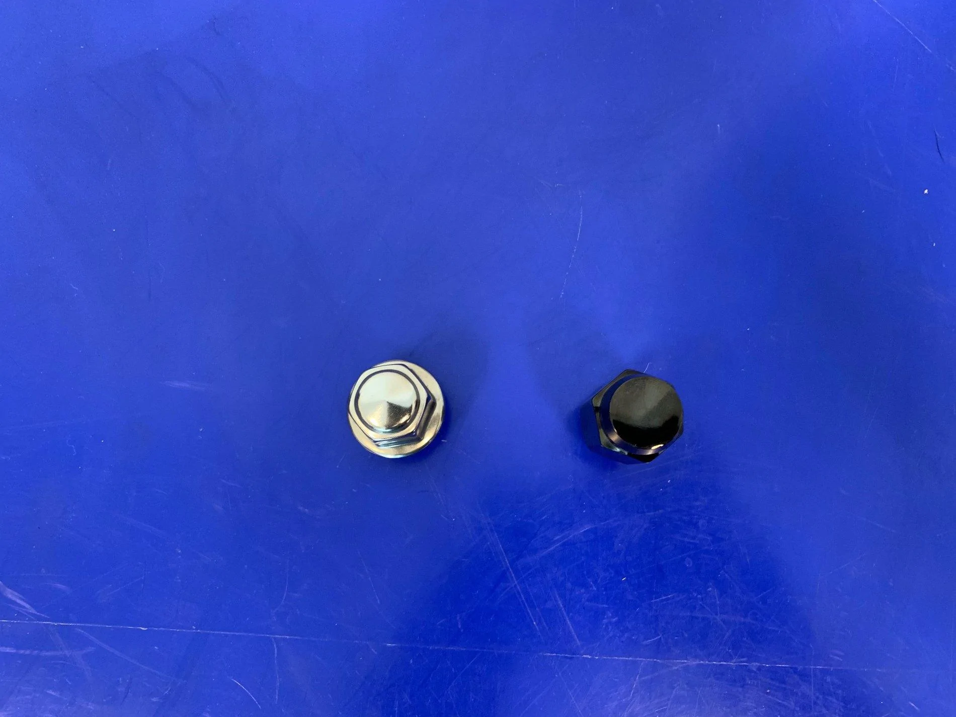

Note in the pics that the OEM lug nuts have a large flange & cone vs. the much smaller footprint of the McGard lug nuts....
Not sure what I'm going to do now - for the short while I had the black lug nuts on, I thought it looked great and could imagine how awesome it'd be if it complete covered the original lug nuts' spot.
Thoughts?

Hi,
Area is the square of the radius, so a small reduction in radius is a large reduction in footprint. I would avoid any lug nuts that do this. black tape can't help here, but may bandaid appearance.
Hope these reduced footprint lug nuts work for you

My concern is that looking at the scuffed area on the original lugs, there's a huge reduction in the area of the mating surface. Were the originals chosen at random, or do the wheels actually need the mounting force distributed over that much area? (That is, will the wheels be prone to cracking at the holes or some such if the force is concentrated?)

...It is a more complex joint than you would imagine.
Bolt preload and mystery are synonymous.

Since they're going to scratch anyway, just paint an OEM set. That would be much safer. Did you read P. A. Schilke's post in this thread?
Interesting - I would hope someone had a stronger coating then what I could achieve with just painting.
Yep, did see his post. I have no intention of using lug nuts not properly designed/fitted for these wheels. I'm not willing to take the risk (real or perceived) of using a lug nut that doesn't fully seat in the same manner as the OEM ones.

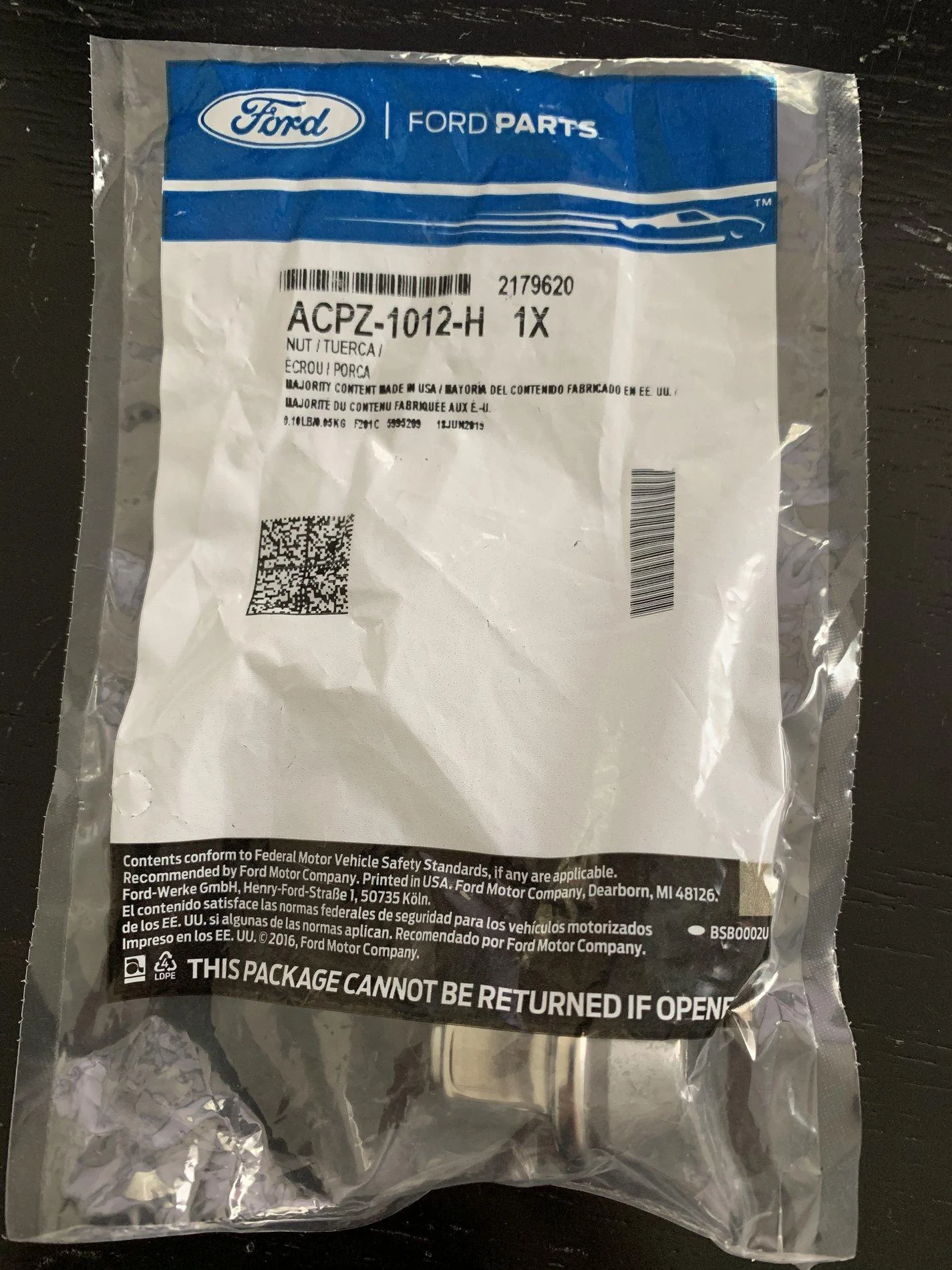

Update- my local Ford dealer had a replacement lug nut for $7.40.
Ford Part Number ACPZ-1012-H
They do not have any black ones.
