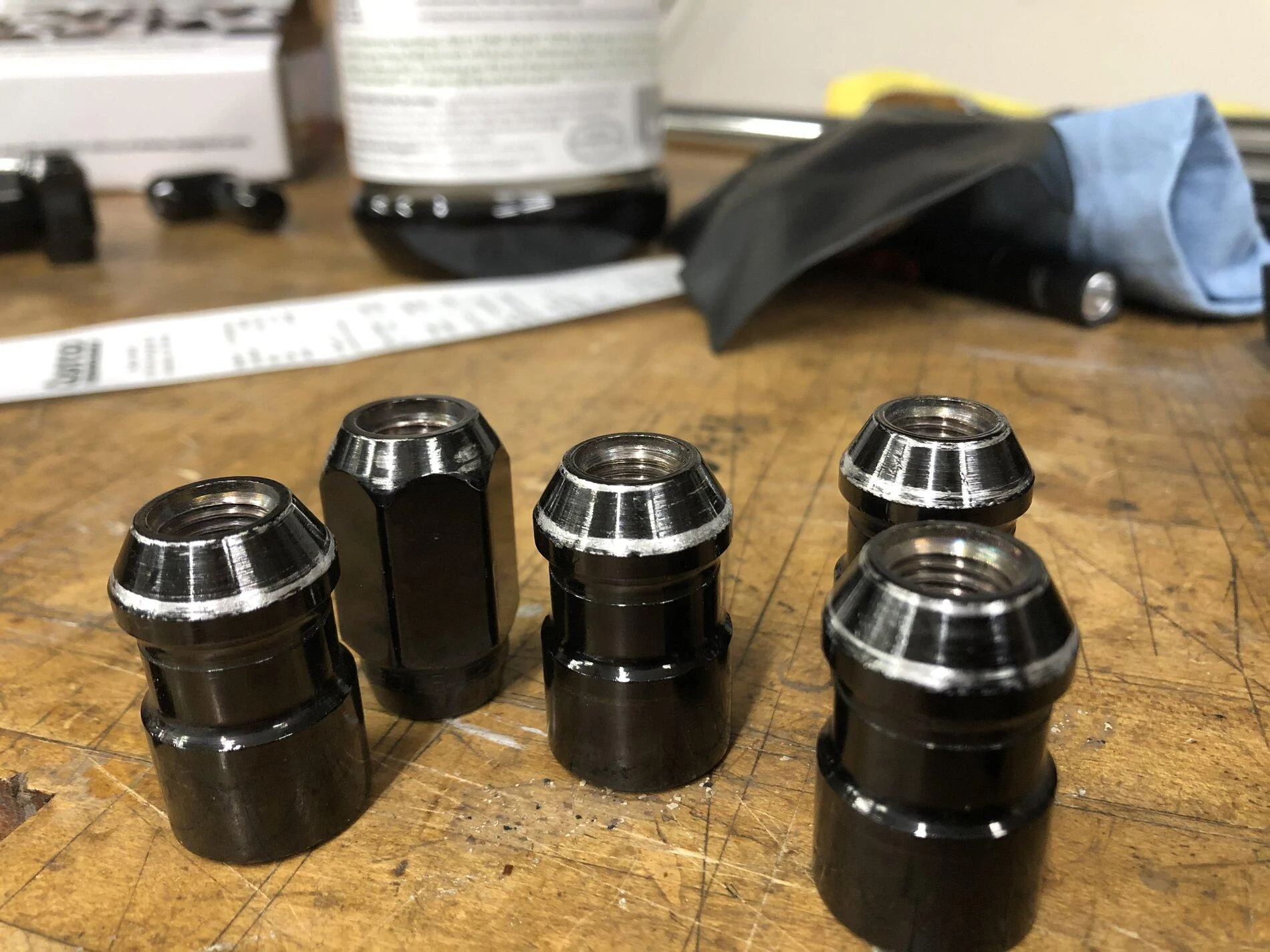

Just came across this thread. I replaced the OEM chrome lug nuts on my 2019 Lariat wheels with black ones purchased from Panda Motoworks last year. McGard Premium lug nuts had the correct thread and cone angle as the OEM. I confirmed before installing them.
After reading this thread, I went out to my truck to examine the lug nut installation to the wheel. I didn't like what I was seeing. Unfortunately, I did not take photos. I decided to remove a sample and attached is a photo of several of the removed lug nuts and the "wear" patterns on the cone surface. The locking lug nuts exhibited the worst condition of the interface between the lug nut cone and wheel cone surface. Subsequently, I removed the McGard and re-installed the OEM chrome lug nuts.
I had about 15,000 miles on the wheels since installation of the McGard black lug nuts with no issues. The wheels had been rotated 3 times to date. That said, from an engineering standpoint, based on the "wear" marks, I was not comfortable with keeping the black nuts installed.
As an FYI, I had a similar less than optimum experience with aftermarket lug nuts on my 2019 Miata. I had installed black lug nuts and subsequently re-installed the Mazda OEM lug nuts.
