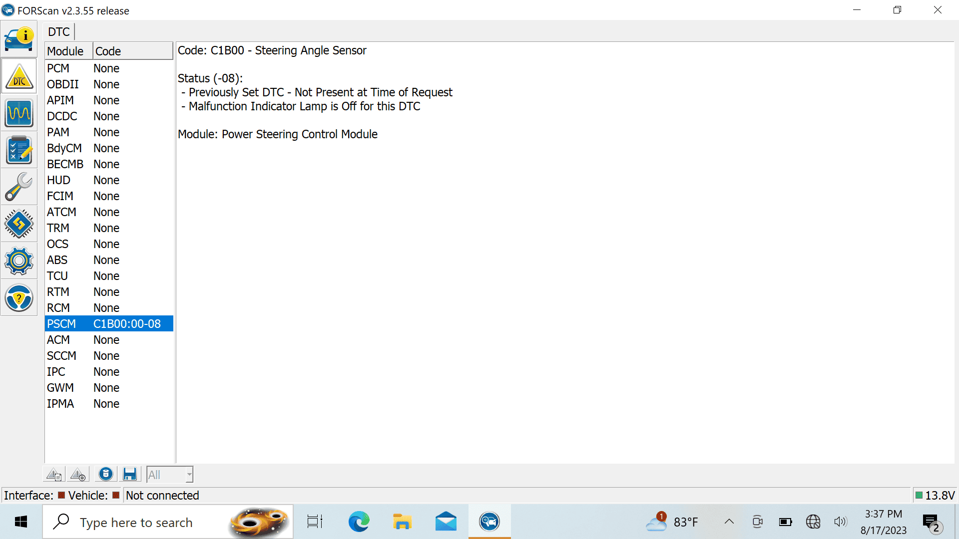

Code: C1B00:00-08
After replacing my DPFE sensor, I went to look at some EGR pids and found this. Seems this is some kind of history code(not sure just guessing off the wording in the description)I have no driving issues. Traction control is still active along with stability control or whatever Ford calls it, and no steering issues either.
Tried googling the code and didn't find anything. Anybody have access to service data for this code?
Thanks for your replies :)
I did look at the pids for the PSC module and the only pids available was the VSS and a Vehicle Mileage pid. Didn't bother to run them.

Sorry should of been more clear. Its the sub code of 08 I'm hoping to find the info on. I found this site but it doesn't have the 08 starts at 09 https://www.dtcdecode.com/Ford

The sub code (08) is just showing it’s not an active code. This code has nothing to do with code troubleshooting.
The base code : C1B00-00
If PSCM detects the sum of the two steering shaft torque sensors do not equal a specified voltage.
Seams like a Fluke glitch
it is common for various historical codes to show during a scan, it only matters when the historical codes become repeated and eventful enough to hard code. This is when the truck will throw the dash lights
So, the important question is did the DPFE fix your drivability issues?

Thanks airline tech
And so far I have had no issues since the replacement of DPFE.
