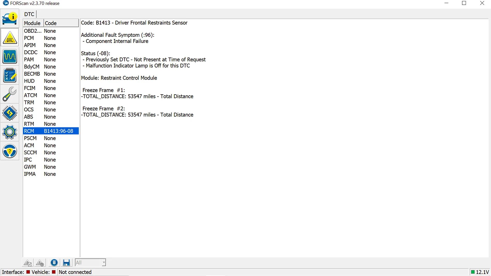

I like to scan the truck now and then checking for codes and came across this as a history code twice now. Once HERE back at my 50k oil change and now the other day

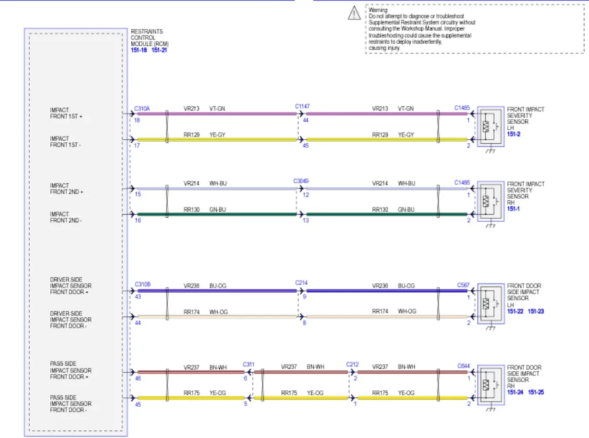

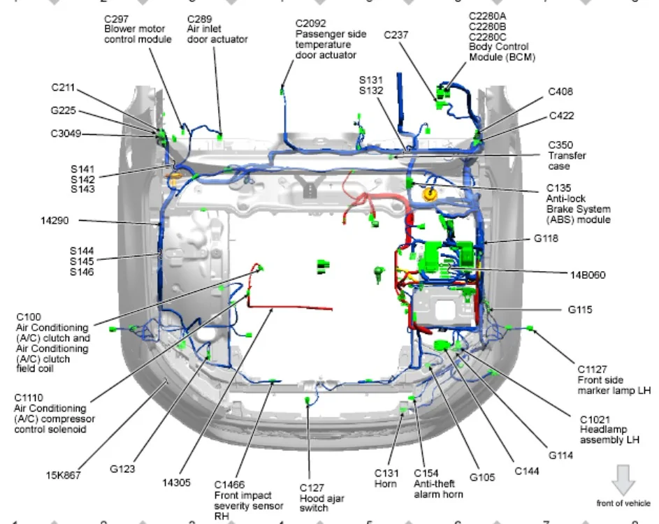

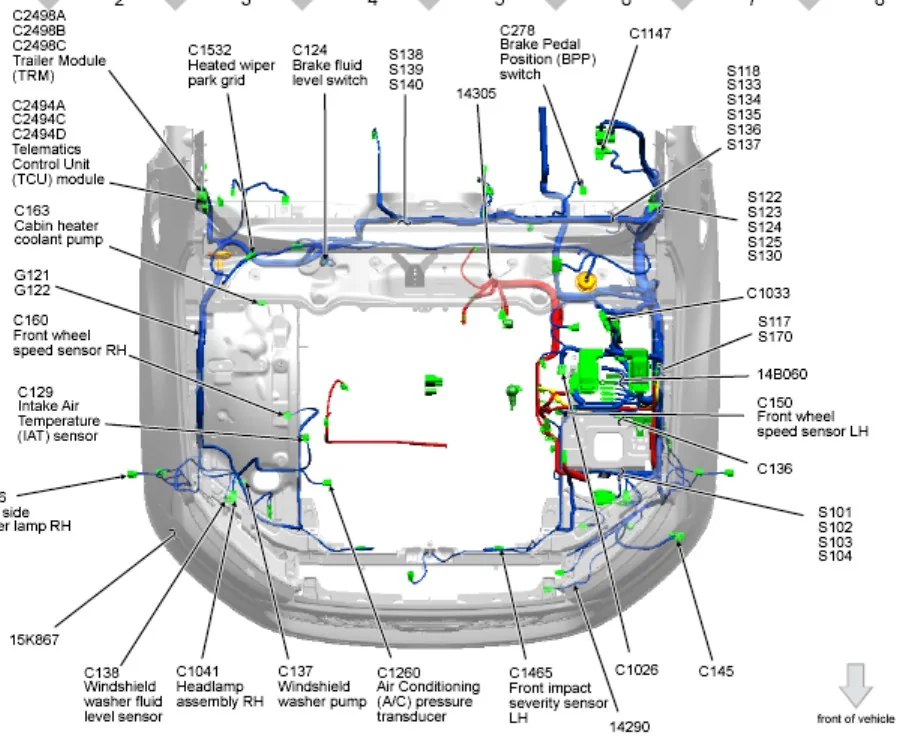

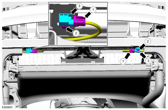

There are two of them.
airline tech
Aug 24, 2022
4,447
8,498
Midwest - KS
Aircraft Tech
The code is specific to the Drivers Front Impact Severity Sensor - the (-96) relates to internal sensor failure, but could be a bad connector (dirty) at the sensor and or its mating surface (the mating surface) acts as noise suppression for the internal sensor.

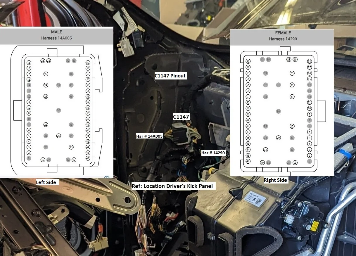

So, most likely a bad sensor, but check the connector for security and corrosion, the next inline connector is C1147 - however due to its location it's hard to access with the dash installed from that connector it feeds the RCM (located) under the center console.
The manuals give options for Depowering the SRS, and it depends on if the ABS Light is actively (ON) - If (ON) you pull fuse (BCM) 14 & 19 - BECMB - VBATT and VPWR - then disconnect the battery
Reason - if the light is on the RCM is powered
If the ABS light is (Off) then wait (1-Minute) after shutdown and remove the sensor.
Reason - If the ABS light is (off) then the RCM will depower after 1-Minute
Most likely - it's the sensor or its connector is dirty as these are both (outside) of the cab
C1147 - Location
With the dash installed - access is limited

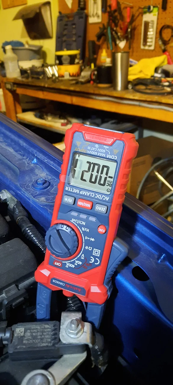

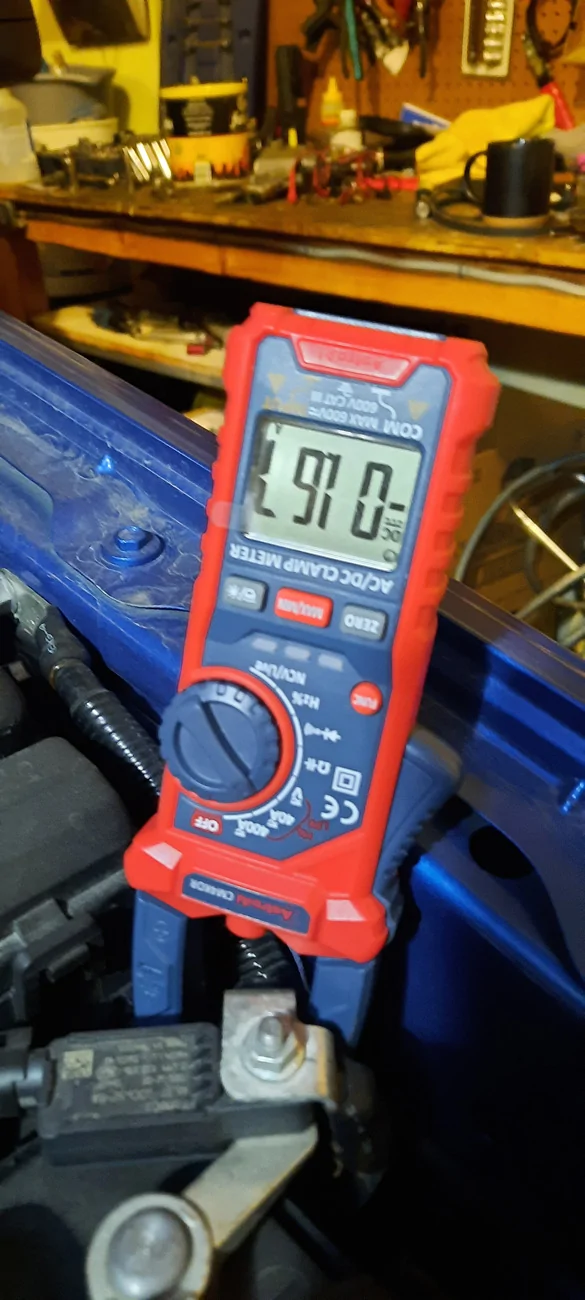

Just got back in from checking the sensor for corrosion and damage and it was fine. So I'm going to order a new one tonight.
Ended up just letting the truck go to sleep and nothing bad happened. I understand your concern. Debated with myself and well you can see who won.
Still awake
Asleep

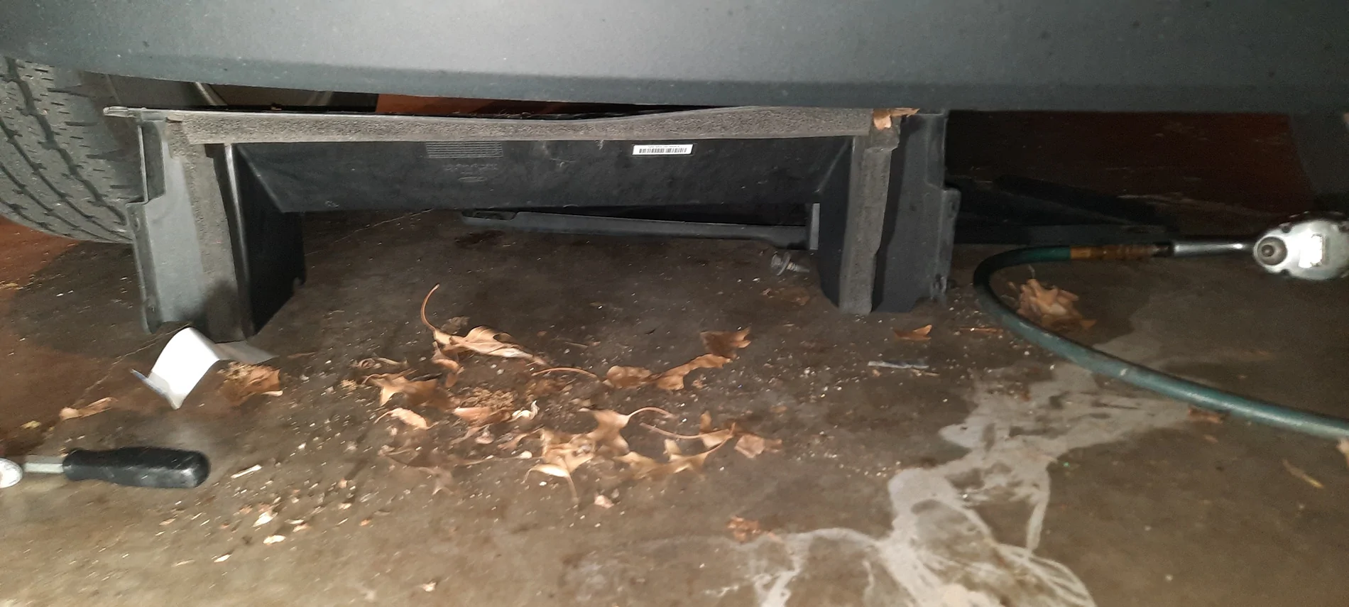

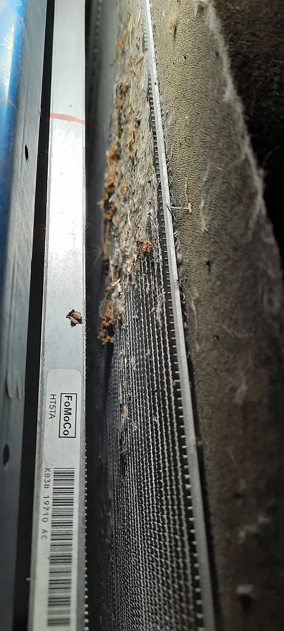

When I removed the bottom Skid plate and the bottom air diverter, I ended up with a nice surprise in my face. :curse:
How in the hell did all this crap end up between my condenser and radiator. I mean it seems like they had that area sealed pretty well. After that I decided to pull the top radiator cover and take look.
I cleaned as much as could with compressed air. I blew across the radiator and not directly at it. Didn't want to push the crap in to the fins

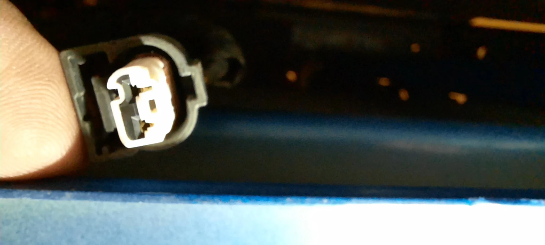

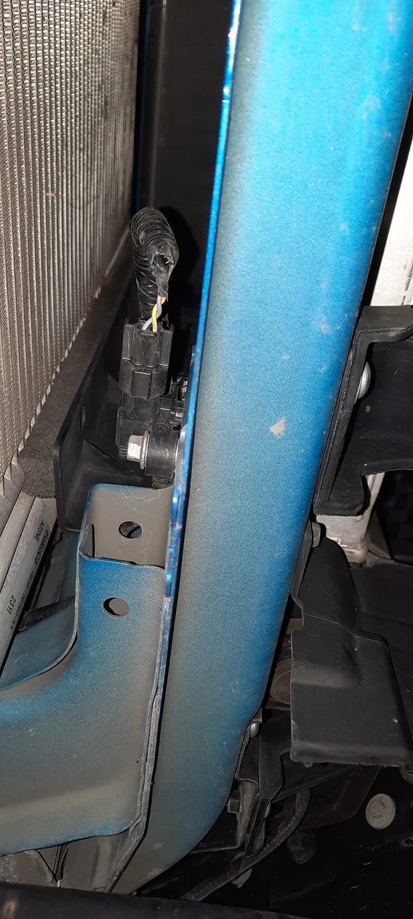

The impact sensor plug was fine and no visible damage to the sensor itself. Followed the harness as far as could and saw no damage.

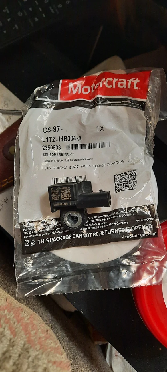

Changed out the sensor today since I was changing my oil.
I decided to measure the resistance between the old and new sensor to see if there was a difference.
New 4.90 M ohms
Old 4.58 M ohms
Don't know how low of resistance the computer is looking for before it sets a code, but there is a little difference between the two.
Here is the part # if anyone else needs it
