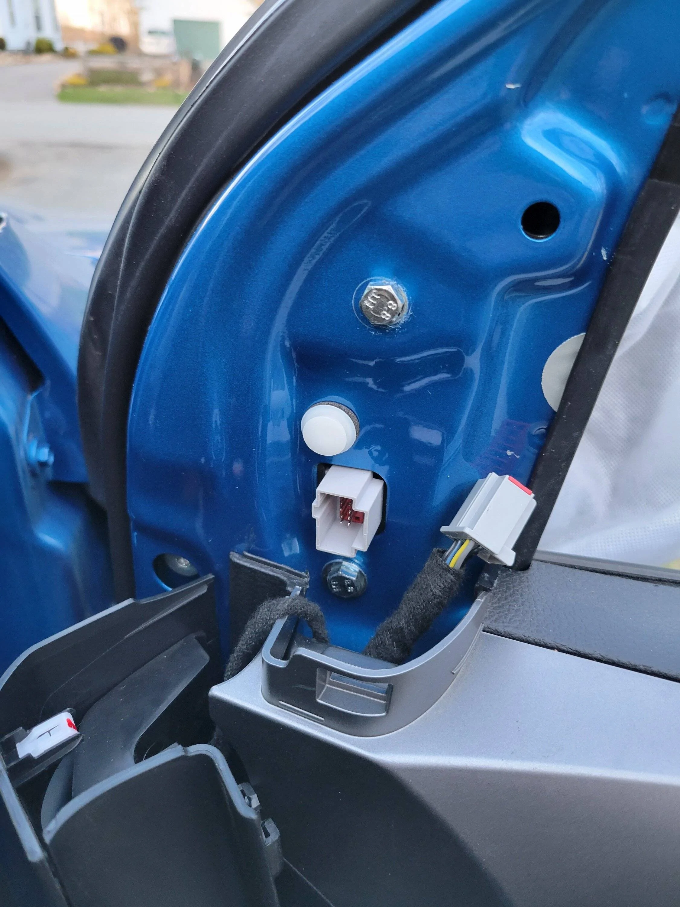

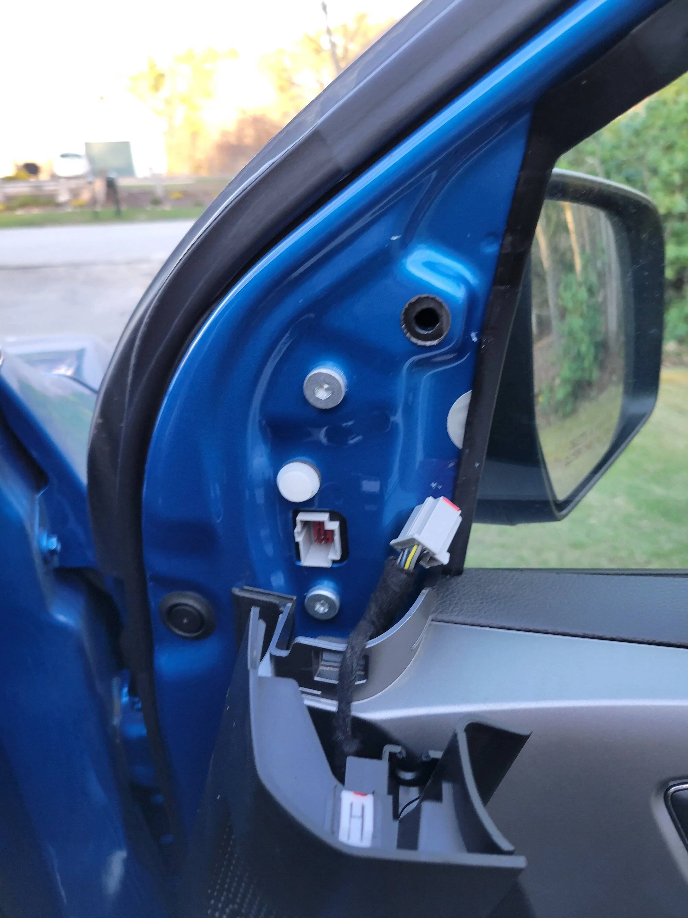

I got my new set installed. Took about an hour and half with a 15 minute toddler potty break and other various toddler stop work issues.
I used a T30 L torx wrench and only removed the tweeters. I figure the majority of my time was taking off and putting on the bottom bolts 1/4 turn at a time. I also replaced 2 out of 3 bolts with hex bolts M6x 18 and a fender washer. I didn't have a socket or wrench small enough for the third to be replaced as well.
Biggest issues is starting the bottom bolts getting them lined up, etc. On my passenger side unit the plug connector pushed 1/4 farther into the truck. Not enough to plug or cause issues other than making that bottom bolt that much harder.
Also there is a rubber gasket on the tweeters snap cover that is now inside my door along with a fender washer.
Not sure if I should worry about the gasket.

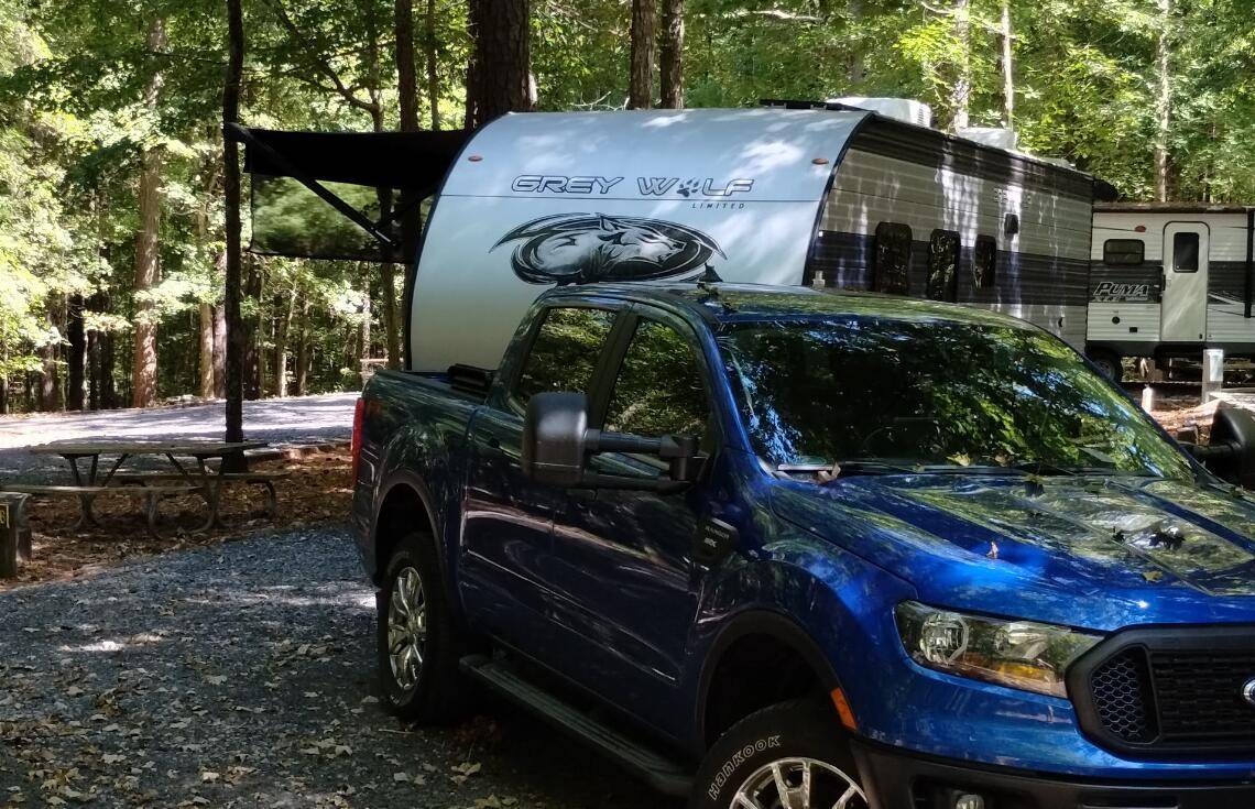

We have 6 trips booked since Jan. Most semi local, and longer trips for the kids. I was dreading the thought of losing more clamp on mirrors.

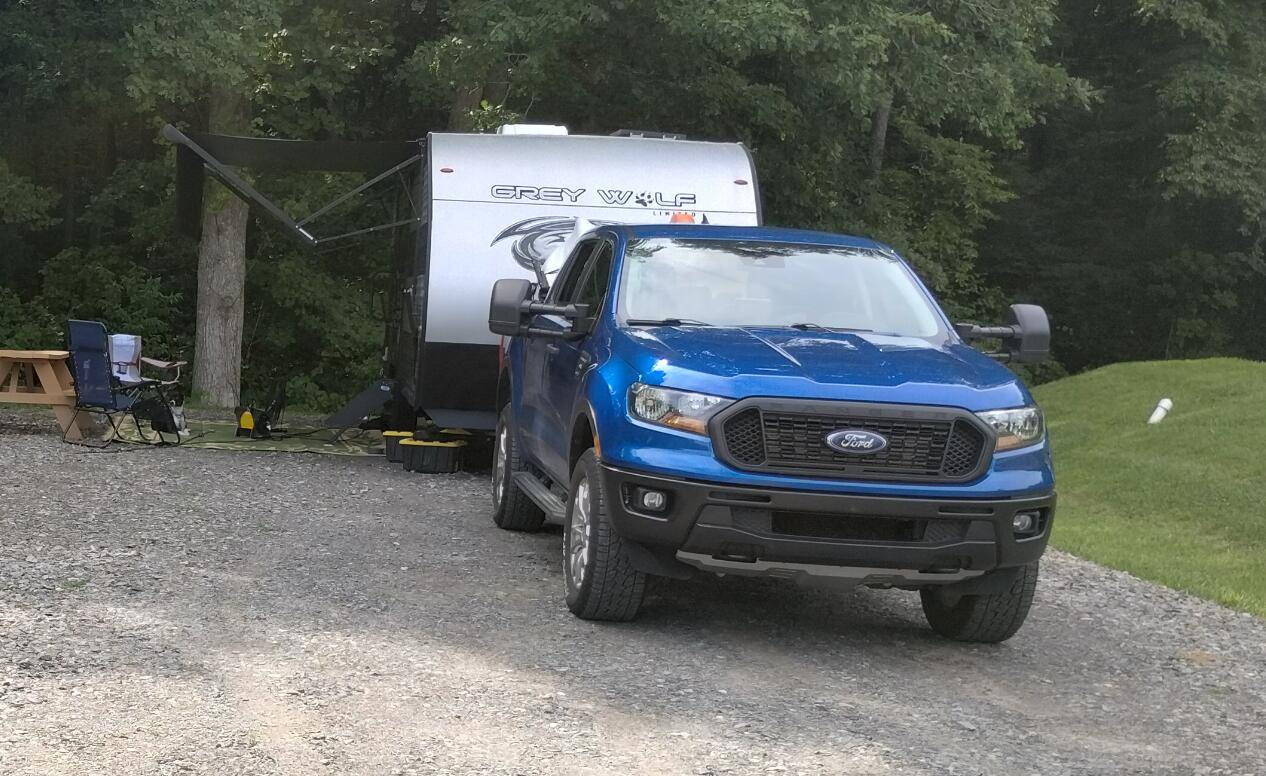

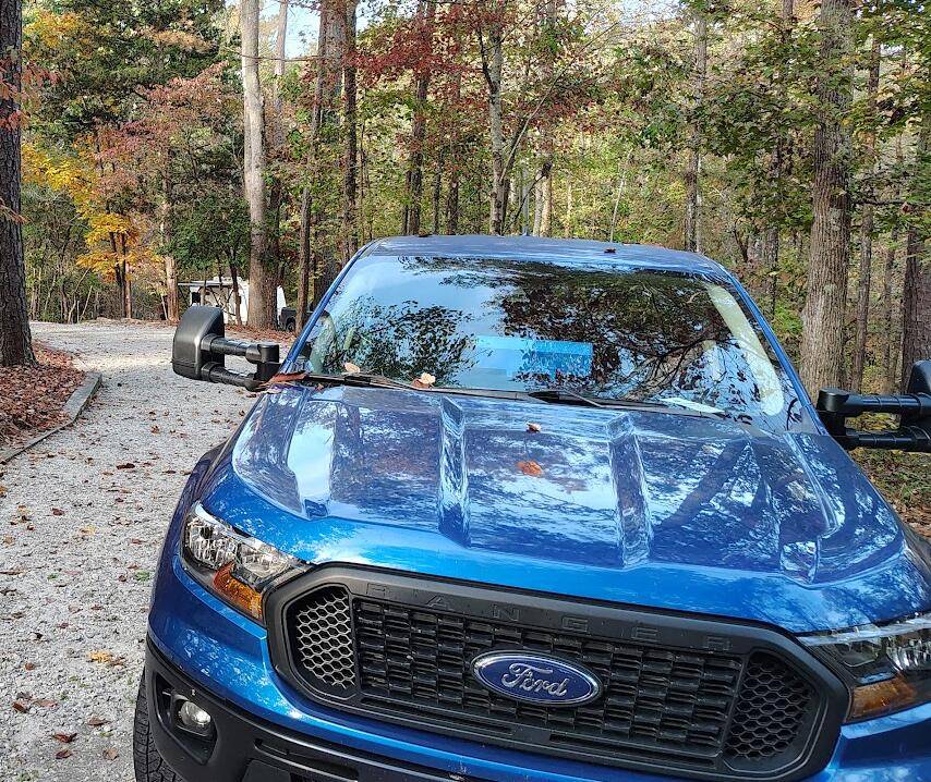

I finally got around to buying and installing my ClearView Compact mirrors. As I stated I planned on doing over a year ago, I went with the Lariat featured version of the mirror and adding all of those functions to my XLT. The mirrors came with the correct connector already installed in the mirror when they arrived. I still have to finish the vehicle side wiring updates to enable all of the additional features though. But I did rush to get enough working that I could mount them before a work function Saturday and then use them yesterday.
I know @tccoastguard stated that his were flat on both sides, well mine came with convex on both sides. I'm not sure I like the convex on the driver's side, I switch vehicles enough that I am not sure I'll ever get used to "objects are closer than they appear" on that side of the car. But I pulled the enclosed trailer 3 hours yesterday evening and had no issues.
There is some vibration of the mirror at idle too that was not there with the OE mirrors, but not so bad that I can't use them.

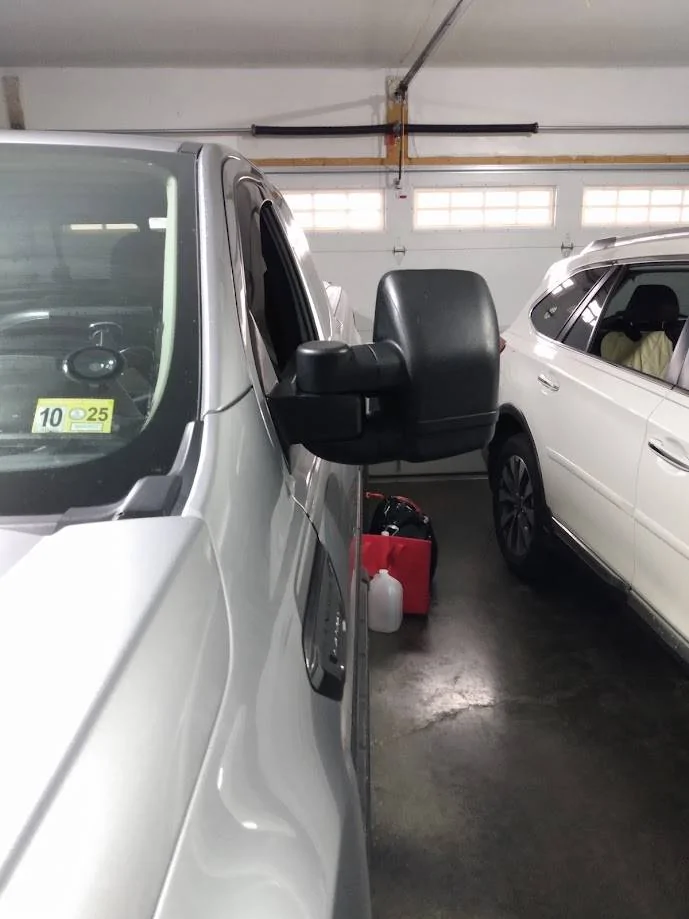

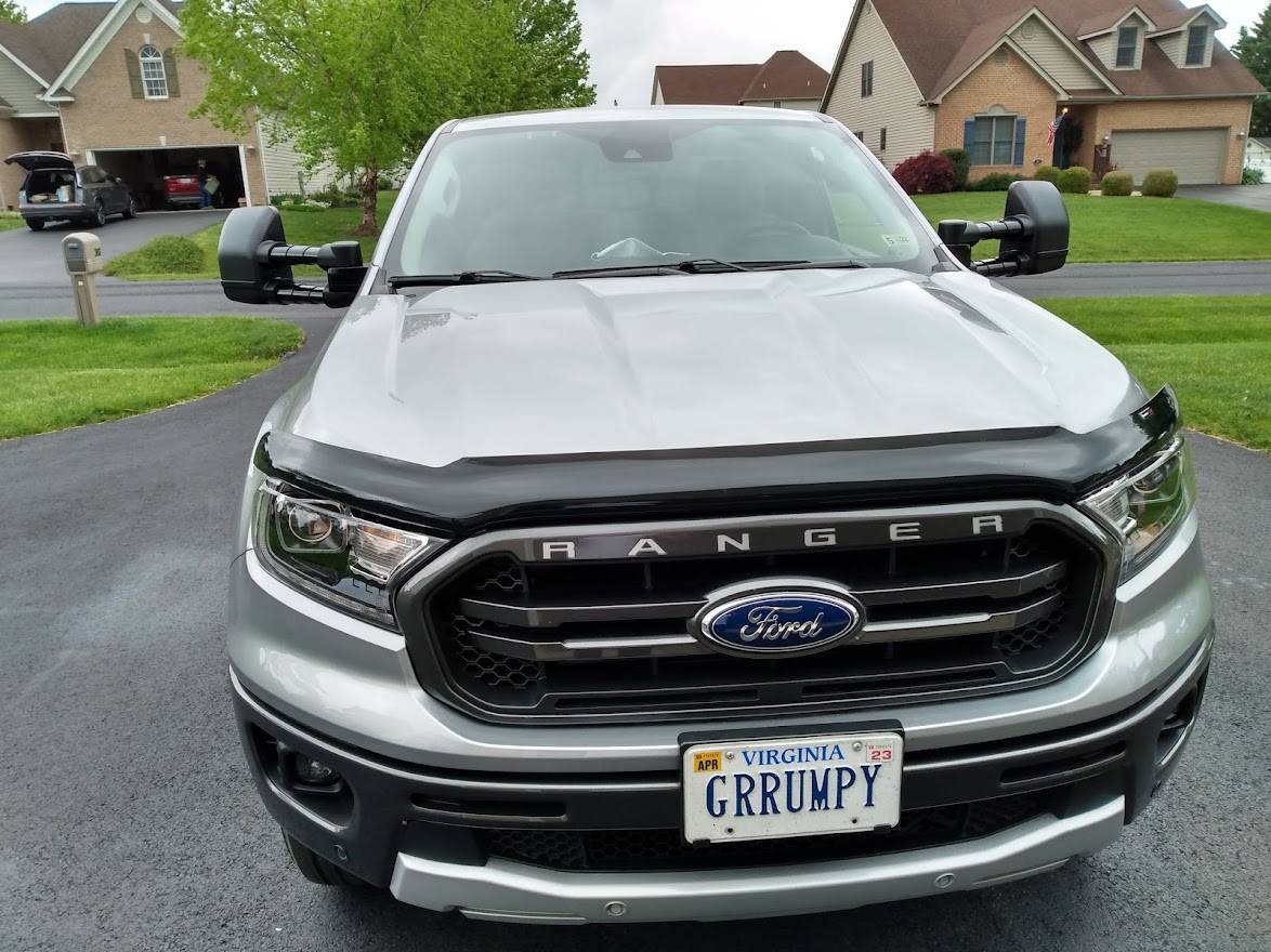

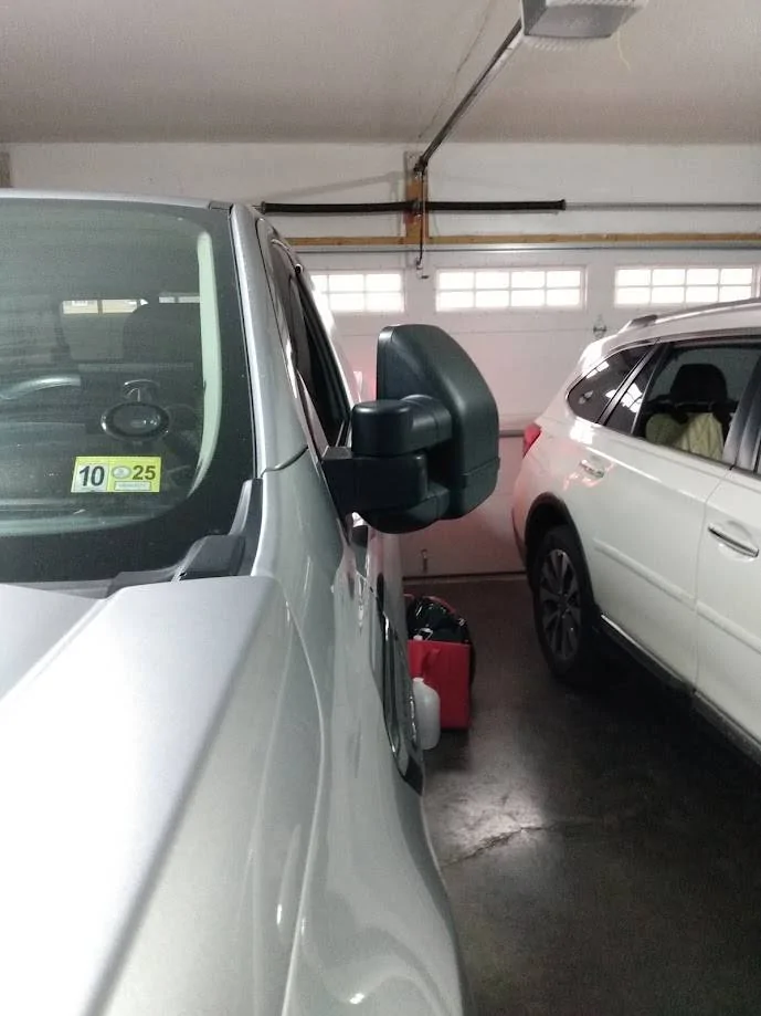

Since you have a Lariat, do your mirrors have the power fold feature? I need to fold mine when parking in the garage, since we have it pretty loaded up with stuff we'll never use. That, and my wife's smaller daily driver needs more room. I assume they fold in close like the OEM's, but just want to make sure.
5,861
29,202
Love the plates! :)
Yes, they do fold. But, because of their design, they don't fold in as far as the OE mirrors do.
Give me a few minutes and I'll take a pic of them folded....
Here....unfolded and folded.....
WhyNot21
Apr 10, 2021
578
1,720
IL
2021 Ranger Lariat FX4 Screw 501A ...
EE
Thanks for taking the time to do this! I really need them to fold tighter, I decided to try my luck with some cheap clip-ons from Amazon for now. Worst case, I hate them and go with the Clearview's in a few weeks. I'm only out $40 if they don't pan out.
