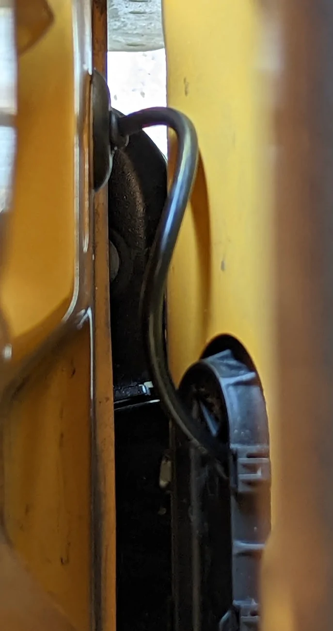

For the antenna I am thinking of drilling into the cab side of the bed and putting a bracket, running the antenna wire through one of the cab vents.

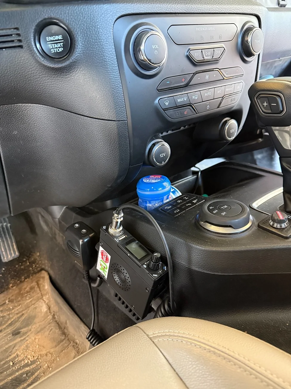

This is the smallest/thinnest CB I have seen, it's great
https://www.amazon.com/dp/B07HFHFXYB?ref_=ppx_hzsearch_conn_dt_b_fed_asin_title_2
Used some 3M foam tape and drilled 2 screws for each mount so it is very solidly mounted and won't ever rip out

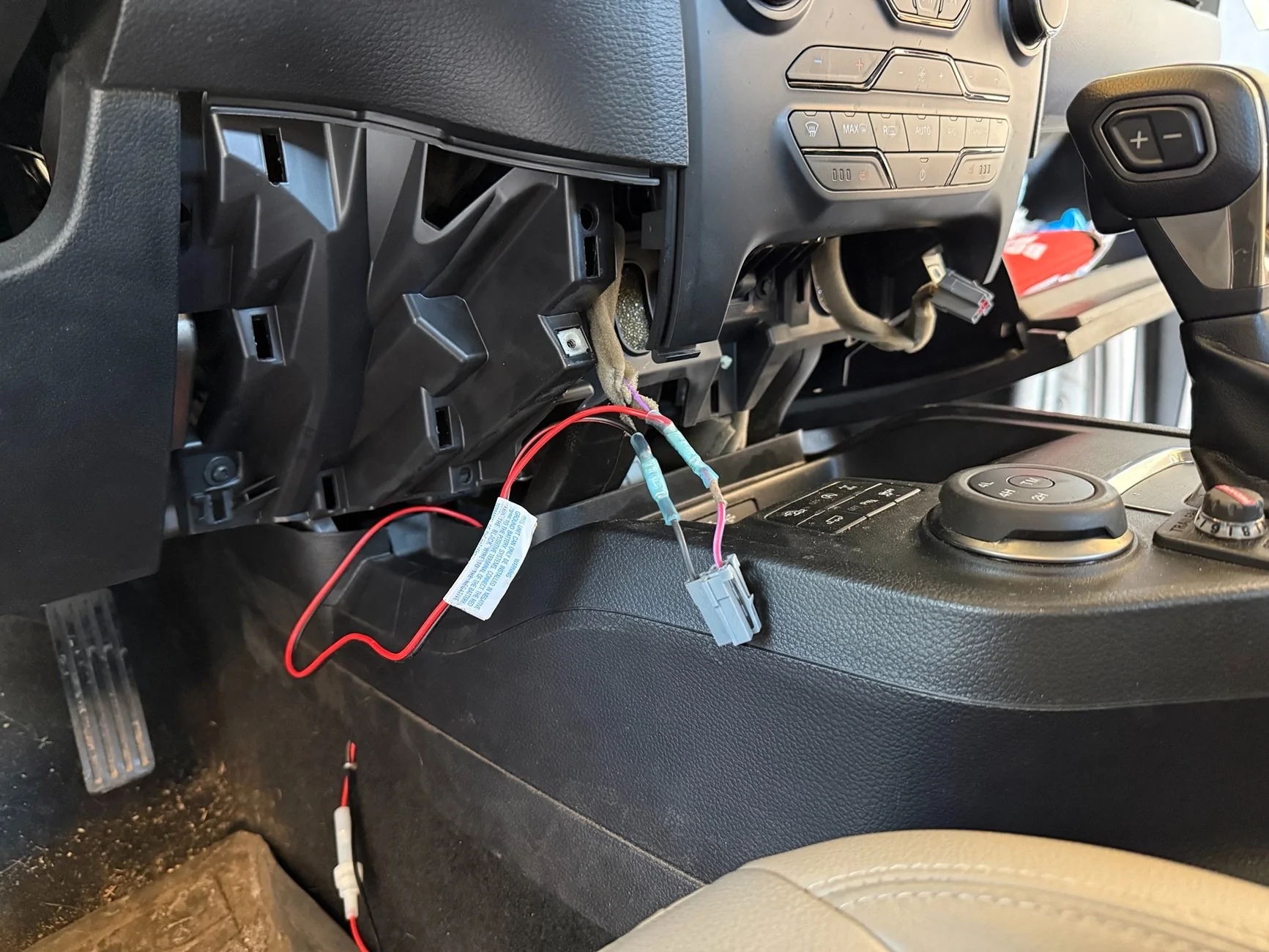

Power is tapped into the back of a 12V outlet, which has a 20 amp fuse upstream in the kick panel, CB has its own 5 amp fuse. This is a great spot because the 12V power stays on for 75 minutes after key off, so CB can stay on whenever you park, but also CB will never be left on and drain the battery.

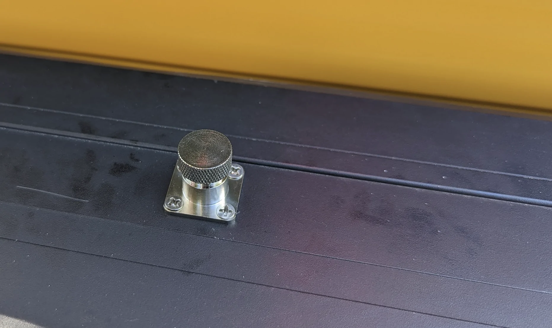

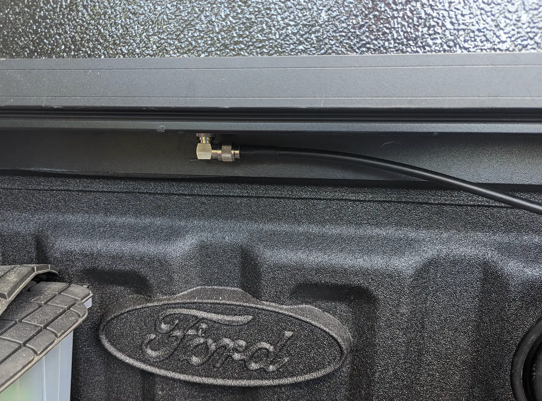

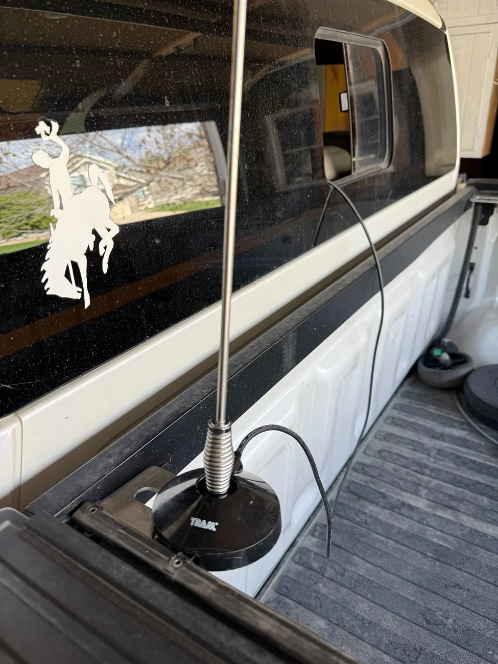

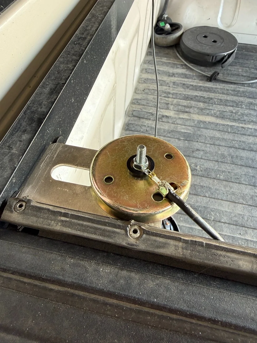

Antenna test fit, seems to be working great:

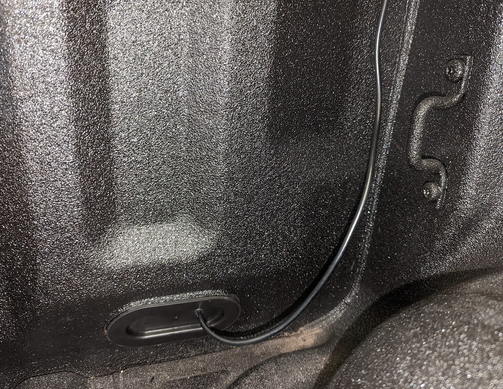

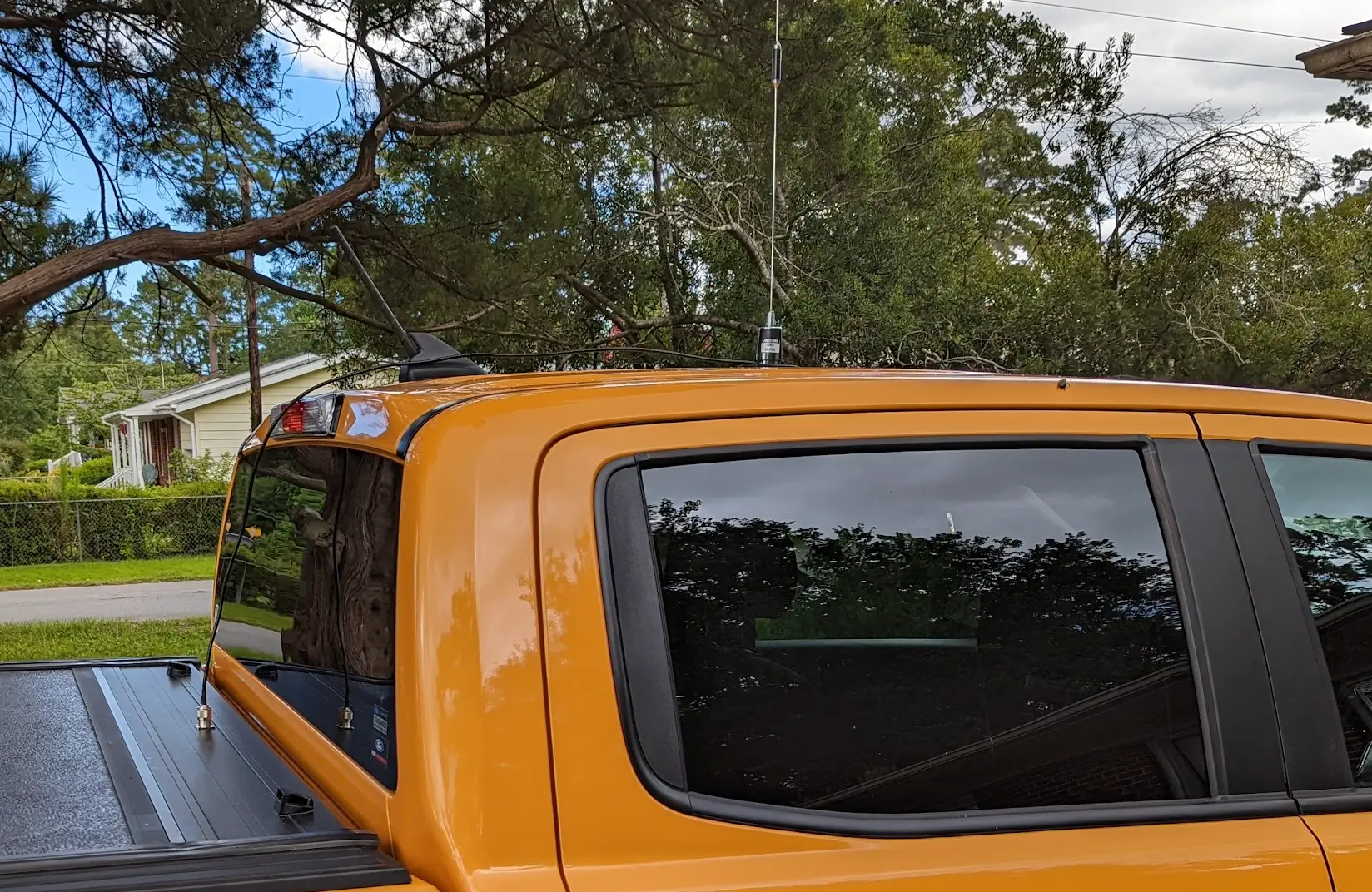

I wish I still had my old CB radios from the 90s. Had the Wilson 1000 on the trunk of the 67 Lincoln and later my 72 Caprice. I don't remember selling them. But they are nowhere to be found. I got my GMRS license and have a 50W in the Ranger, a 15W Micro mobile I move between the Focus, Jeep or the house as well a a couple of handhelds at 4 or 5W.

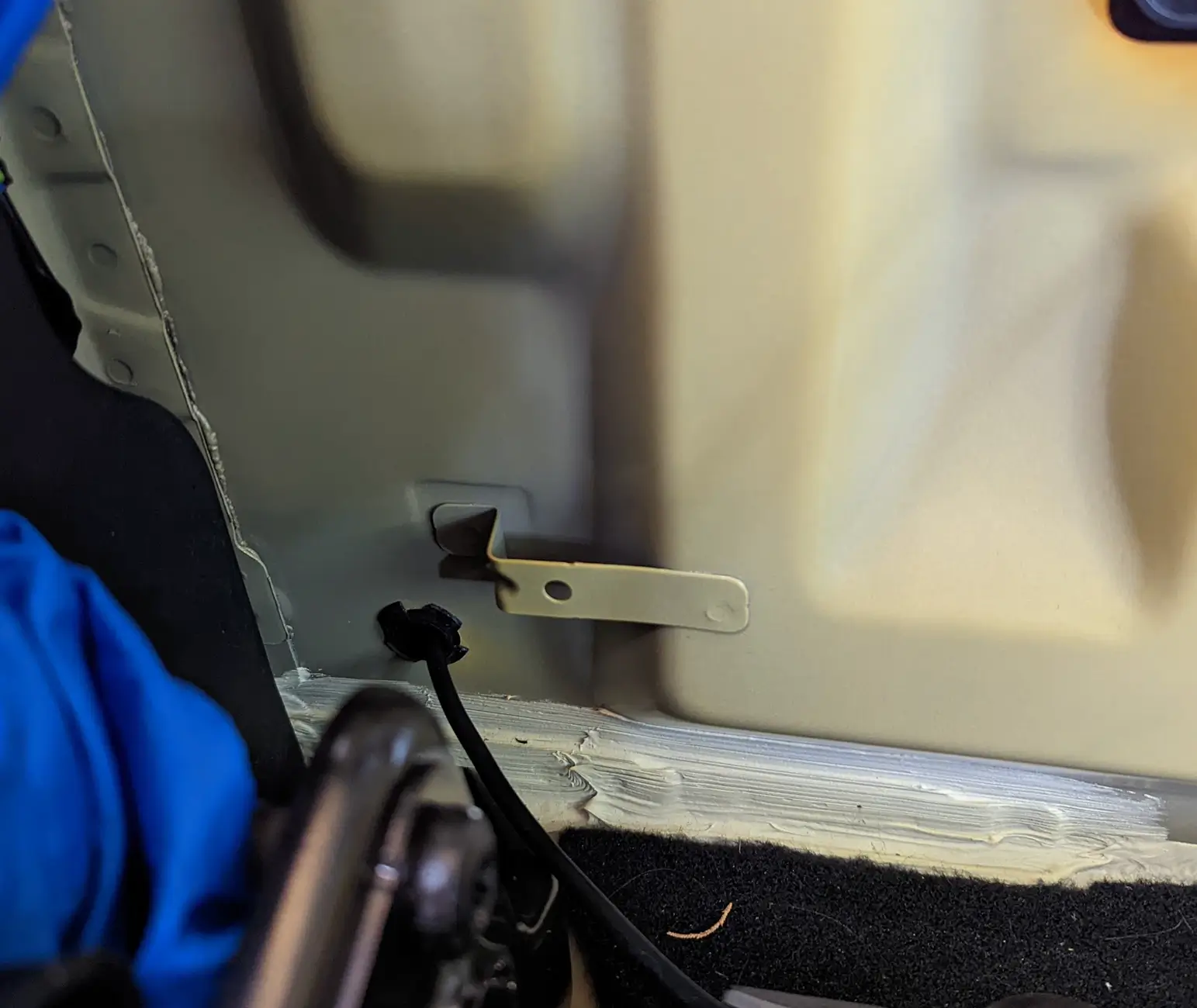

There are plenty of OE grommets in the lower rear of the cab that can route into the grommet in the at the lower front corner of the bed.
