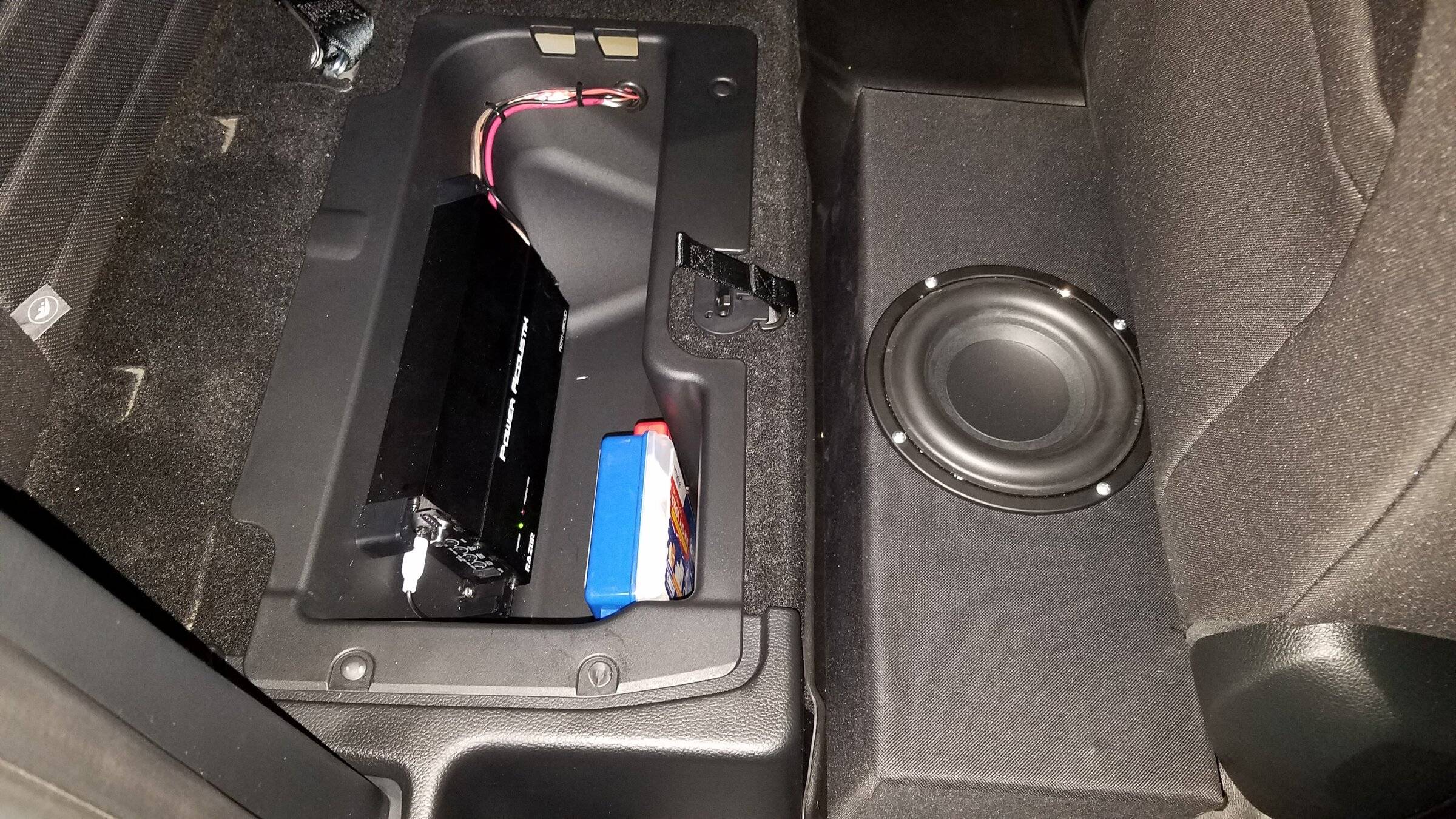

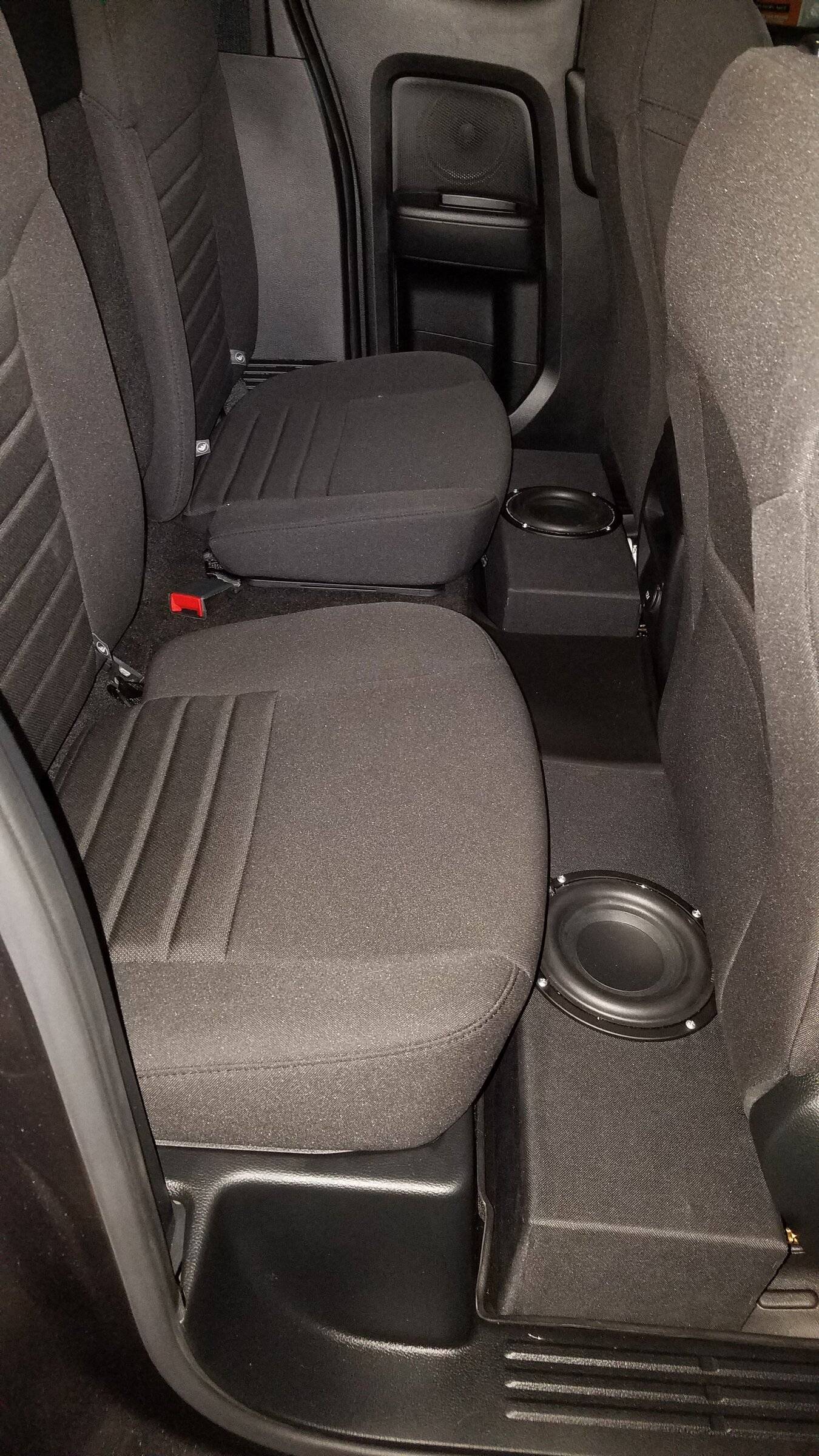

I built two custom boxes for behind the seats in my super cab. Put the amp in the under seat storage. Used 2 Tang Band W6's.
are those sealed boxes, it looks like it? good fit!
