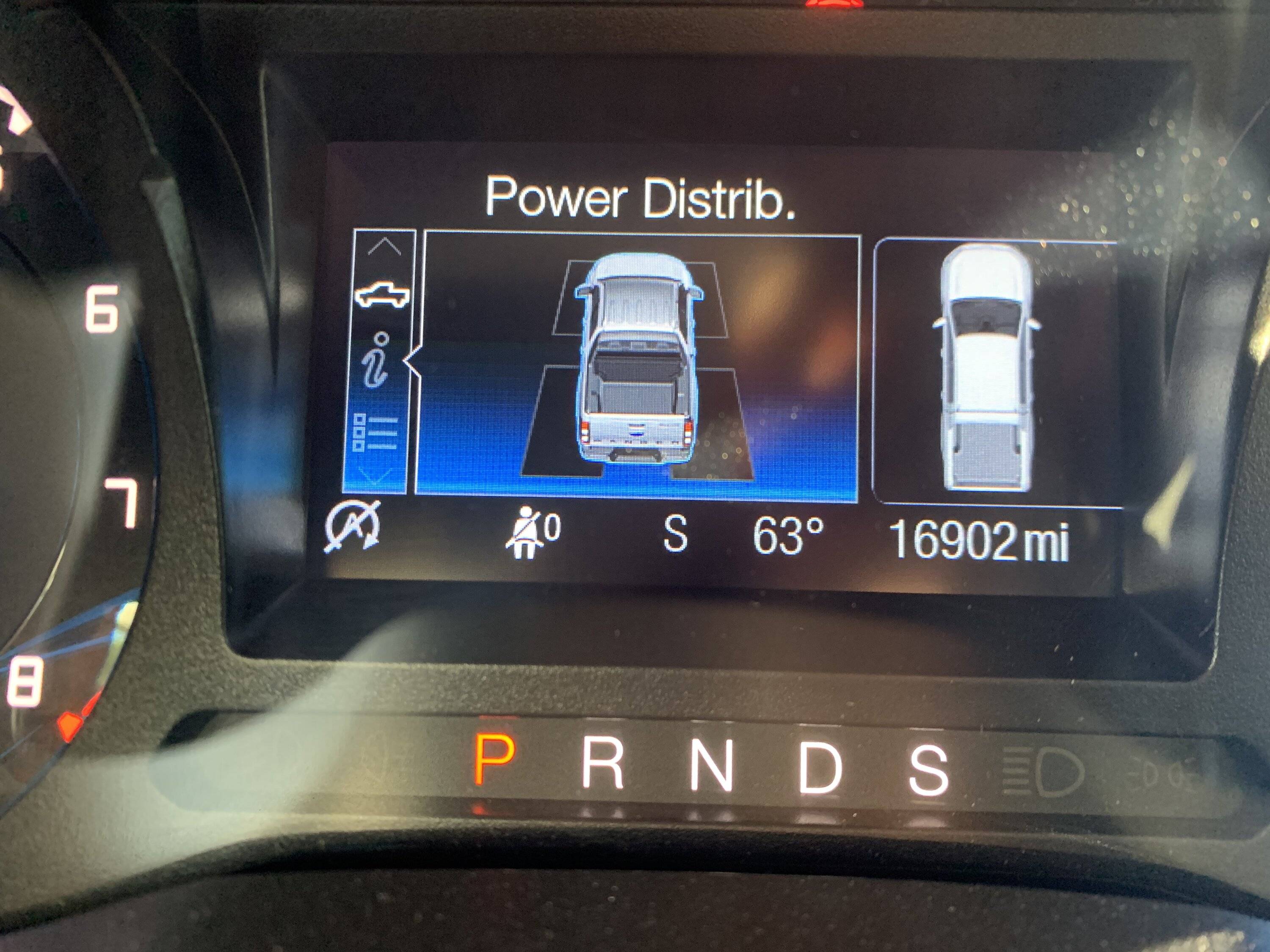

I read something about the Maverick that said you could add drive modes to lower trim levels via forscan. Would that be possible on the Ranger? Also, would it be possible to add that traction screen on the instrument cluster? The one that shows where the traction is going. I have a 2019 lariat, and don’t have that option.

Do you have a 4x4? If so, you can add Terrain Management if you purchase the switch and replace your existing one, and then enable the feature via Forscan. I did just that to my 2020 4x4 XLT Sport.
You will be able to see and enable the terrain options, and you can also enable the angle views (how steep the hill is that you are on and how much the truck is leaning to the side). There are threads discussing the details... do a search on enabling Terrain Management.
There is no wheel traction screen.
