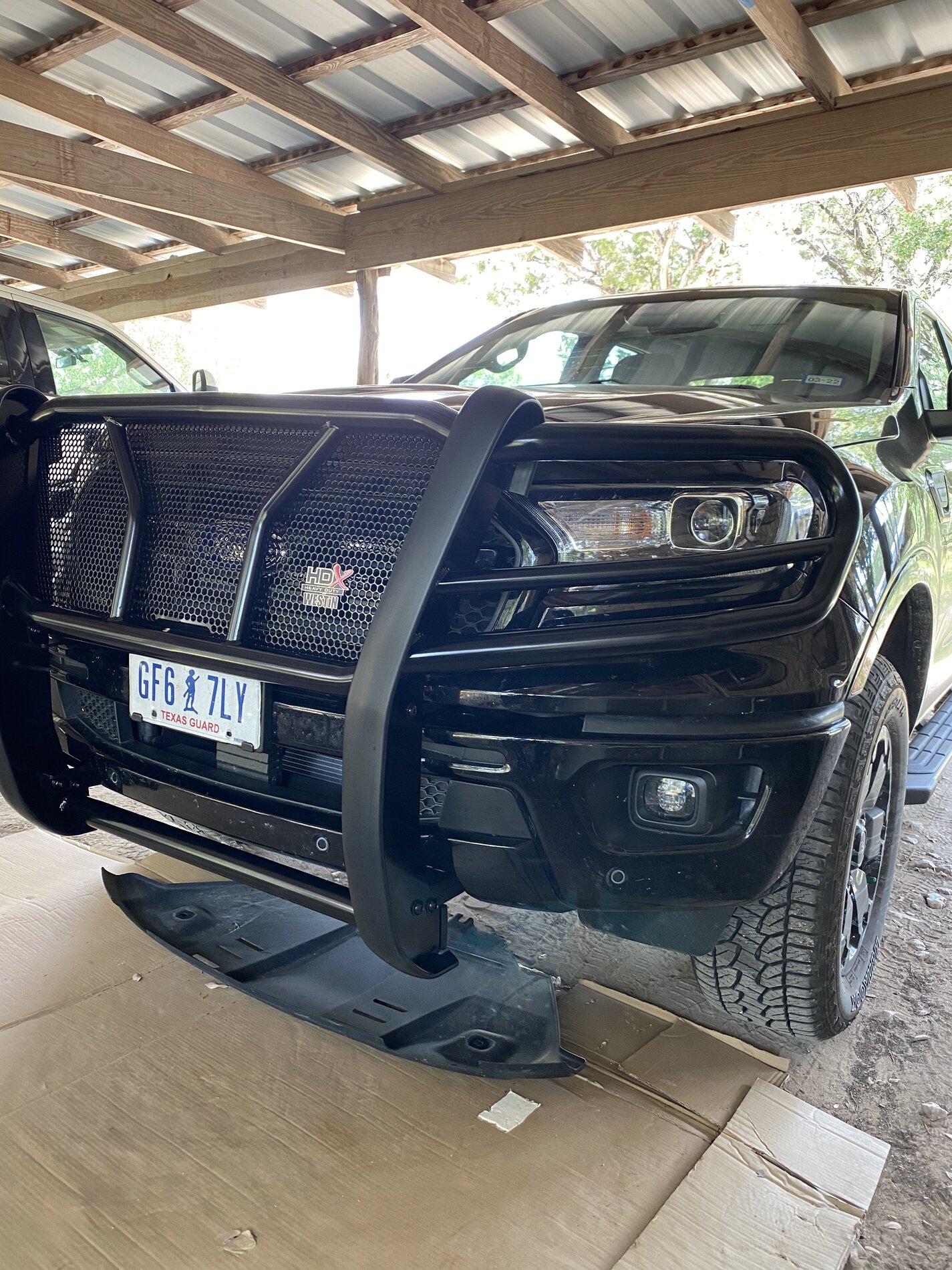

Westin sent me two brackets to replace the ones that came in the package, that allowed re-installing the skid plate. The only remaining issue is the parking sensors. I haven’t taken the time to look into re-aligning them, but the button in front of the shifter turns them off.

Yes, they should. I think I was the first skid plate reinstall customer to call them. They had to send me a couple of sets of different brackets and my skid plate was off for a few weeks until their engineers got a solid set of brackets.
here is a pic just after installing the brush guard and before I received the replacement brackets for the skid plate.

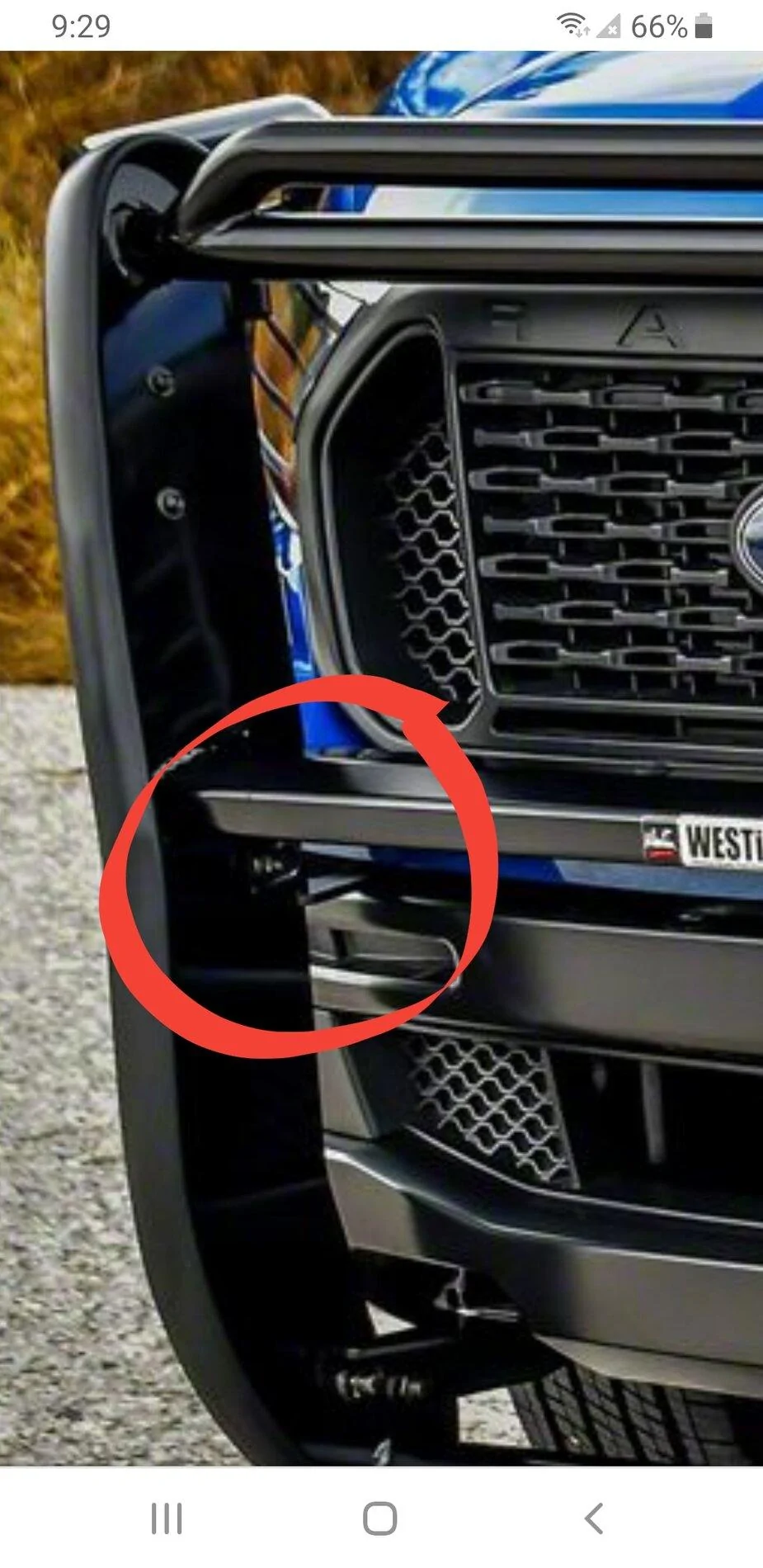

Are these brush guards only attached at the tow/frame area? How is this going to hold up to any resistance from folding in against the facia the second it collides with any obstacle?
First Ford
Tim
Aug 14, 2019
46
36
South Carolina
2019 Ford Ranger Lariat Fx4
So the Westin Brush Guard I have is attached at same location the tow hooks were and then there are secondary brackets that are attached above the bumper to provide additional crash support and prevent it from just crushing the front end.
9,230
28,578
NWO Robot Polisher
That's good to know...do you know where the secondary reinforced mounting is located and what it's attached to?
First Ford
Tim
Aug 14, 2019
46
36
South Carolina
You will have to zoom in on the Westin Website Photos but you can see the bracing brackets that attached right below the light plate and they attach behind the dumper. The bumper has to come off first and install the brackets, only to reinstall the bumper and then add the brush guard. It has been a year since I installed mine but I'm pretty certain they installed in between the bumper and the frame.
