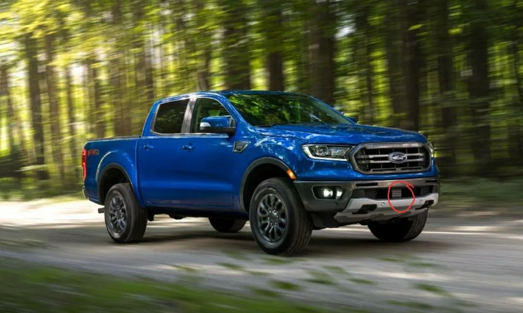

I have adaptive cruise control and break assist on my 19 ranger. Are the sensors in question also responsible for those features? I had a car pull out in front of me that I didn’t see the other day and the truck stopped on it’s own, so I’d hate to mess with that feature at all.
No most of the collisions portion and the adaptive cruise control is all handled by the radar device that is behind the plastic on the lowest air intake in the front. The plastic housing looks like grey vinyl siding. See the item circled in the picture attached. Hope this helps.

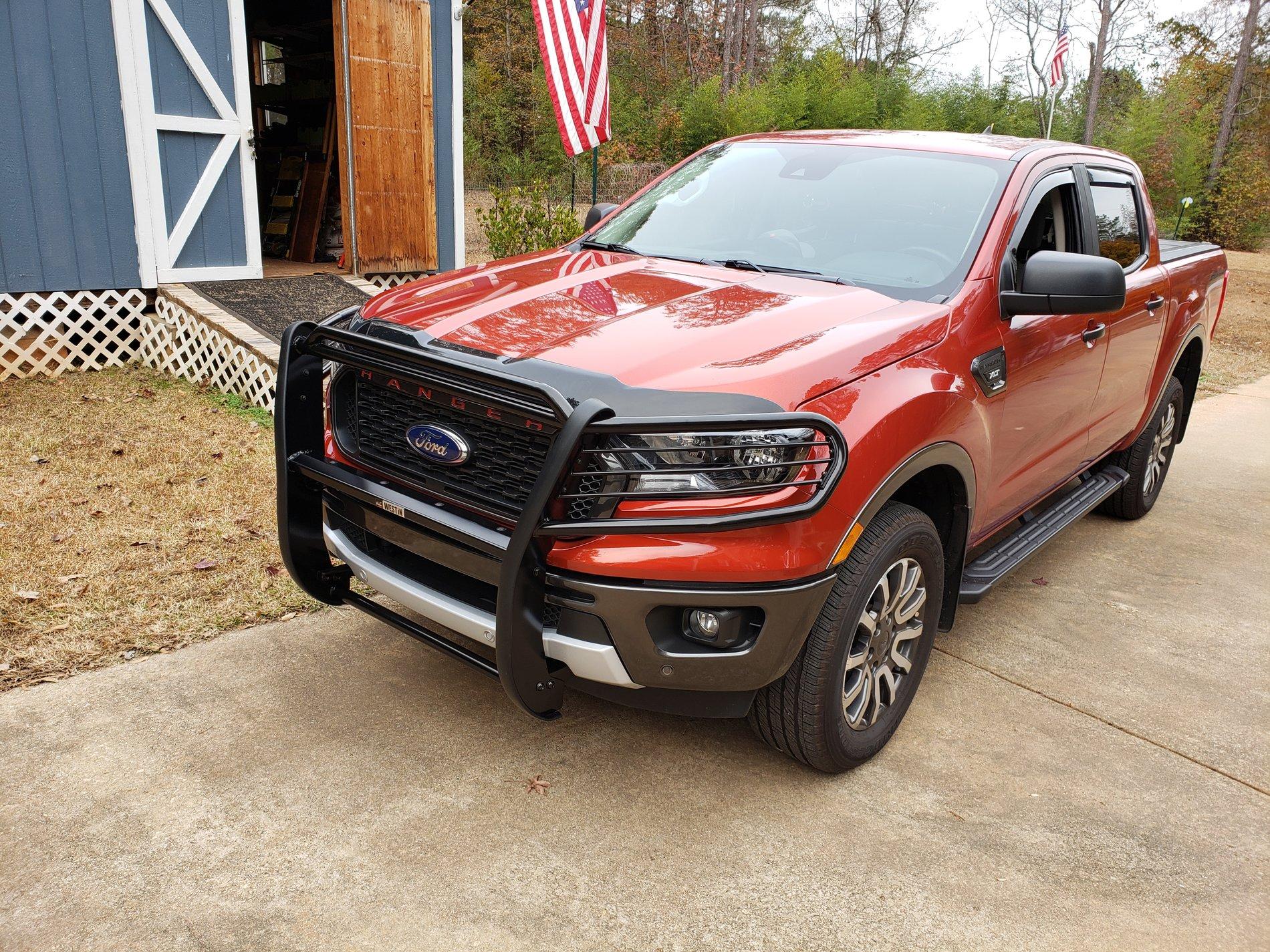

So I installed it, looked like the sensors would be clear.... But they are not. The front 2 sensors alert every time I go to drive..
I've looked in the display menu's settings and can't find an option to turn off the parking aid. Of course that's what it says in manual.
I'm open for ideas.
I thought about something like this and figured you could relocate those two sensors into the front of each side of the bar. Drilling a hole and plugging them in and then tapping into the wires going to the original sensors to hook up to those, but disconnecting the wires to the original sensors. Would love to see your feedback on this idea.
I'm open for ideas.
