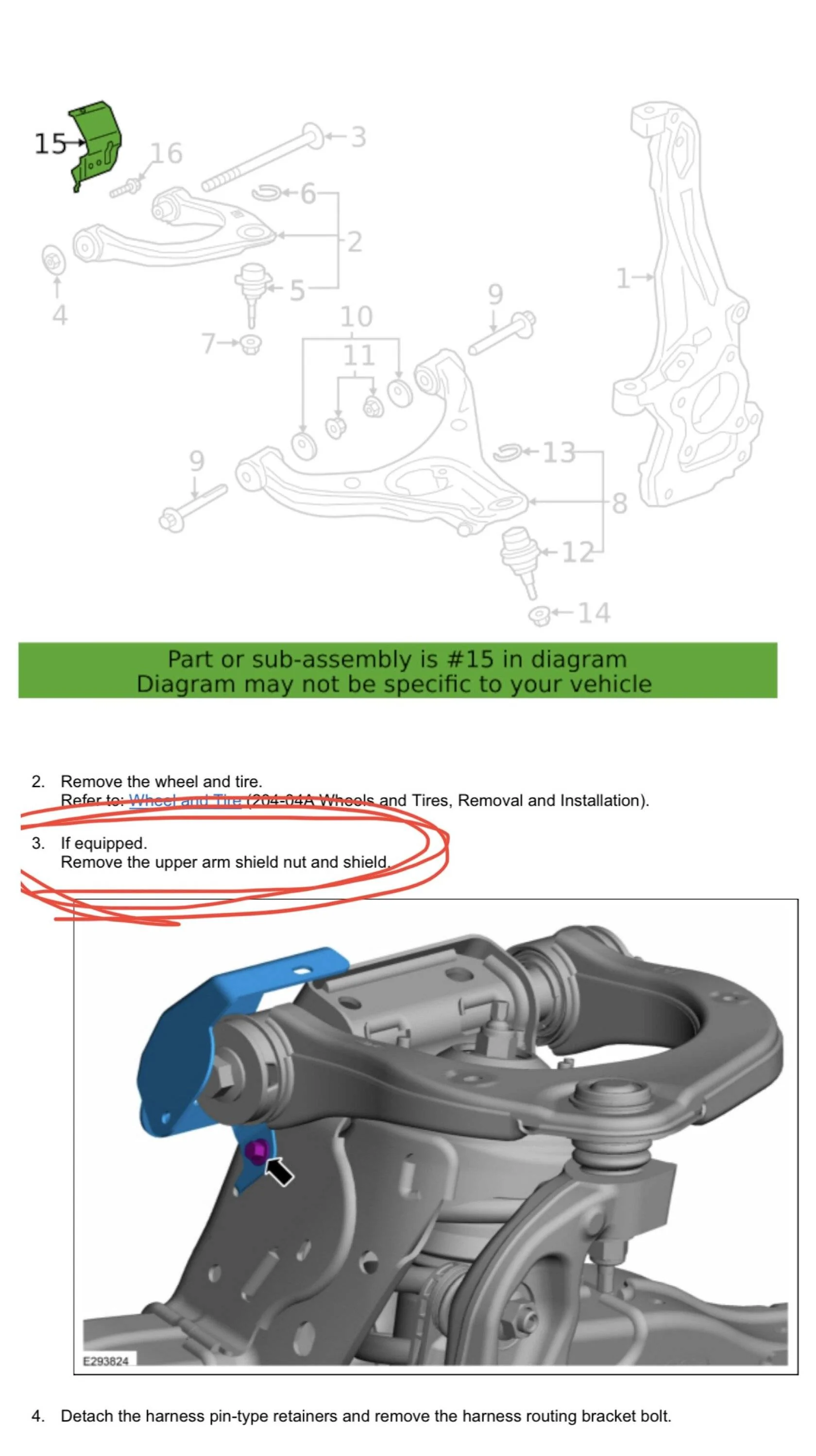

The shop manual and Ford parts site suggest this is specific to certain vehicles only, such as FX4-equipped vehicles, which the OP has. These are the hints…
”If equipped”
”may not be specific to your vehicle”

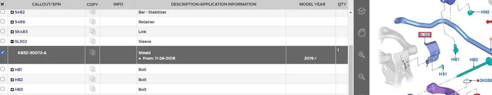

Maybe our good friend Benny @LevittownFordParts.com has a way of knowing if it is FX4-specific or not.
Shield - Ford (KB3Z-3D072-A)
