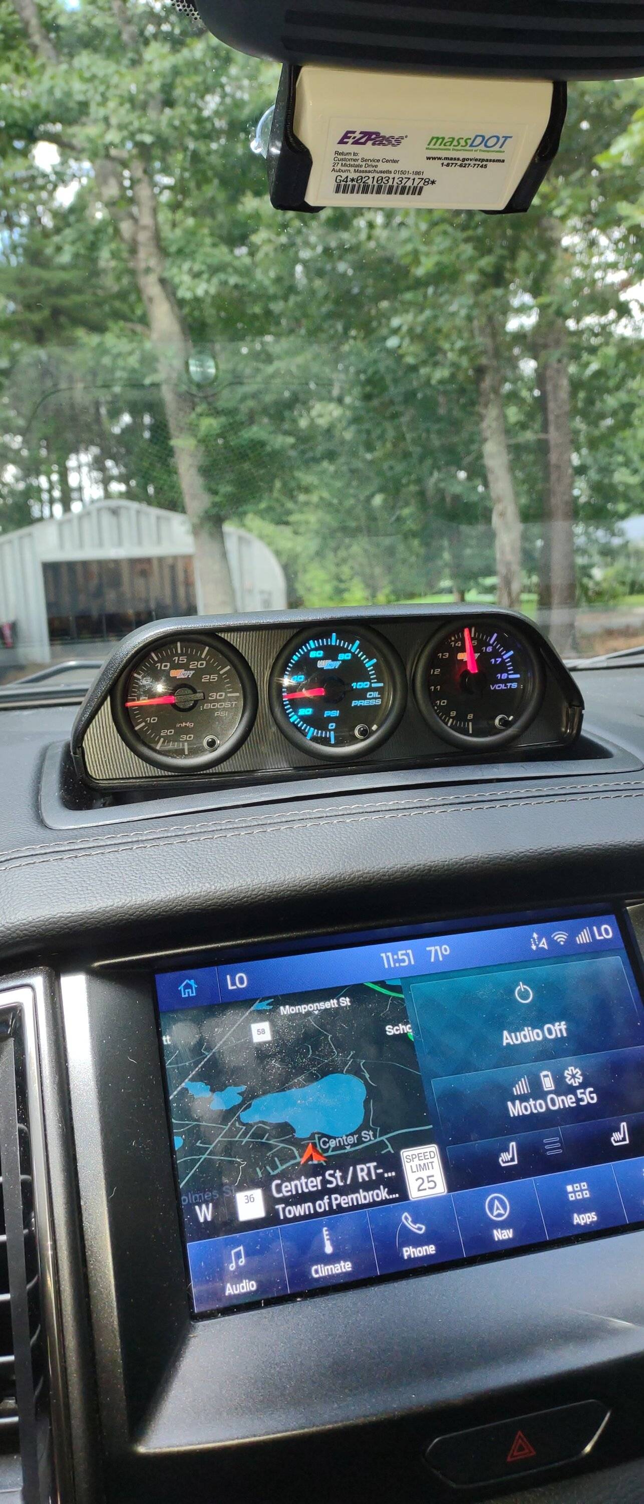

I had a Focus ST and the gauges in the dash top pod were so small and with so little resolution they were pretty useless.
I went this way for gauges in my Ranger. Pardon the back lighting. My camera and the refresh rate in the LED back lighting didn't play nice together. All of them were set to the ice blue of the middle oil pressure gauge (these gauges have 7 colors you can choose for the back lighting).
Curious: What is the peak boost you are seeing on the gauge?
20 psi. These engines are tuned using torque targets. So if the air is good and 17 psi will allow the engine to reach the target that's what you will get. On bad air days you will see more boost in order to reach the torque targets.
Also, I am running an 87 octane performance tune so I may be seeing higher boost.

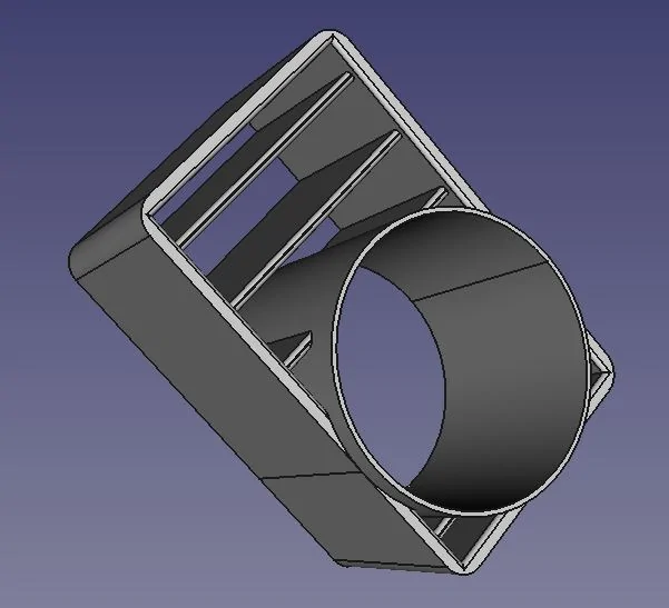

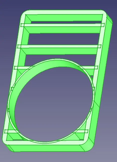

Anyone have a 3d print of a boost gauge mount for the ranger? I'm thinking of printing something to install one in the drivers side vent.
Just trying to get the fitment down (not the final rendition) as I will radius the vents, make it much longer to look the factory part (6 baffles, 14mm apart, etc). I also wanted to keep the vent at the top of the gauge.

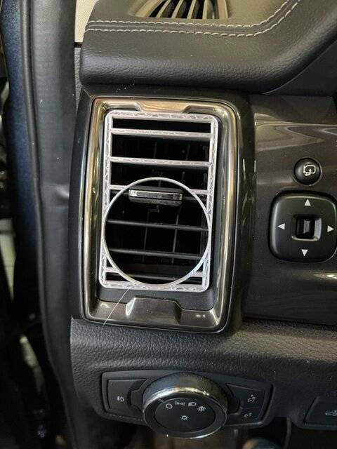

I did a template checking size and fitment. Still working on the design. But the goods news is a 52mm gauge fits.
Made it 40mm deep with the gauge coming forward 5 mm. beveled airflow edges, should work. It's just 89mm long so should print on most 3d printers.
