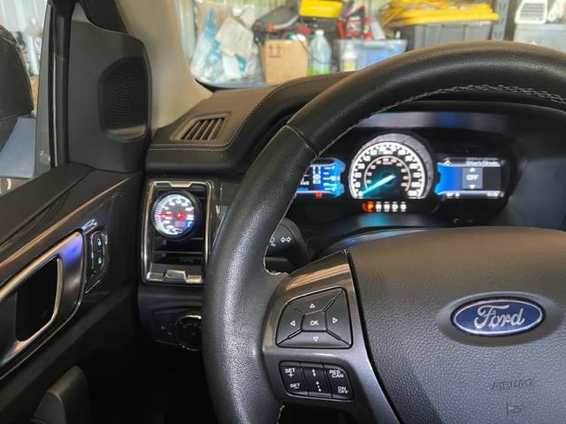

Patiently awaiting my new gauge (below) as I couldn't find one with a blue pointer. Now that it's in the dash, I wish I would rotate the gauge slightly towards to the drivers seat, But the 52mm gauge can only go in straight, there is no extra room and it's serves it's purpose.

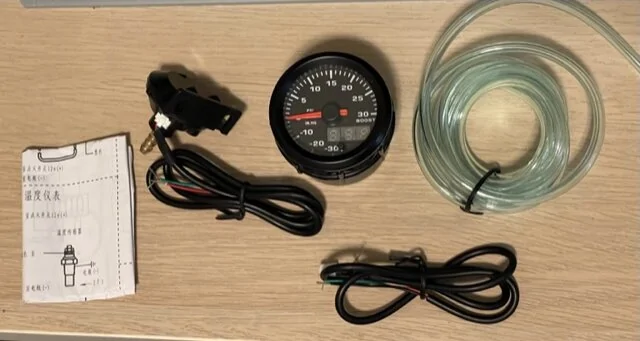

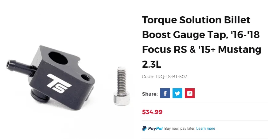

Well my new gauge came today, and to my surprise it is electronic (with a transducer), Which means the vacuum hose/boost hose stays in the engine compartment and all I to do is run 3 little wires through the firewall. Now to find a "Boost Gauge Tap", I don't really want to drill a hole, or cut a oem part. I found a Billet part that looks like it will work for $34, waiting to hear back from the manufacture.

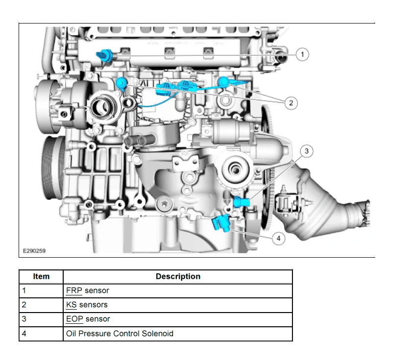

Hi guys. I don't know if anyone will find this information relevant at this point, as the thread is kind of old, but there is an Engine Oil Pressure (EOP) Sensor on the engine. There is also an Oil Pressure Control Solenoid, so I think there is some fancy electronic pressure control going on here. Maybe due to Auto-Start/Stop function? I have not done any additional research into the oiling system, but here is a location diagram showing the component location. (Item 3 and 4) If interested I can tell you the Diagnostic codes that can possibly be thrown due to sensor problems.

Thank You, I saw that one but was looking at this. I haven't even looked under my hood, so I'm not sure it will work. I am waiting to hear back from the company. And since I am using a boost gauge with a transducer the plumbing will be pretty short.

I called Torque Solutions and they haven't tested it on a Ranger so were not sure of the fitment. Shipping is $23 to me, which makes for a spendy TEST piece.

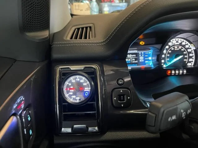

Threw my gauge in... It does the needle sweep when powered on and if the need was blue it would be perfect. My Boost Tap shipped and will be here next week, hopefully it fits. The digital and analog all in one gauge looks great
The display is well let and you can select from all the typical LED colors.

The location looks good but idk if I would get past it pointing offset from your sight line like that
