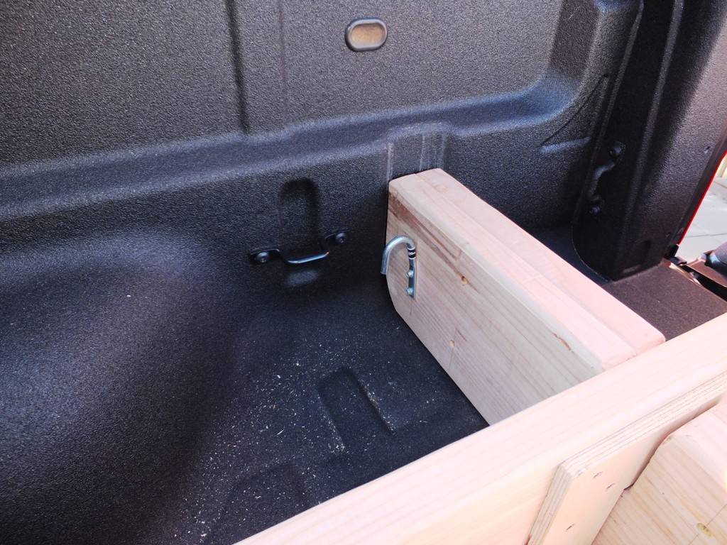

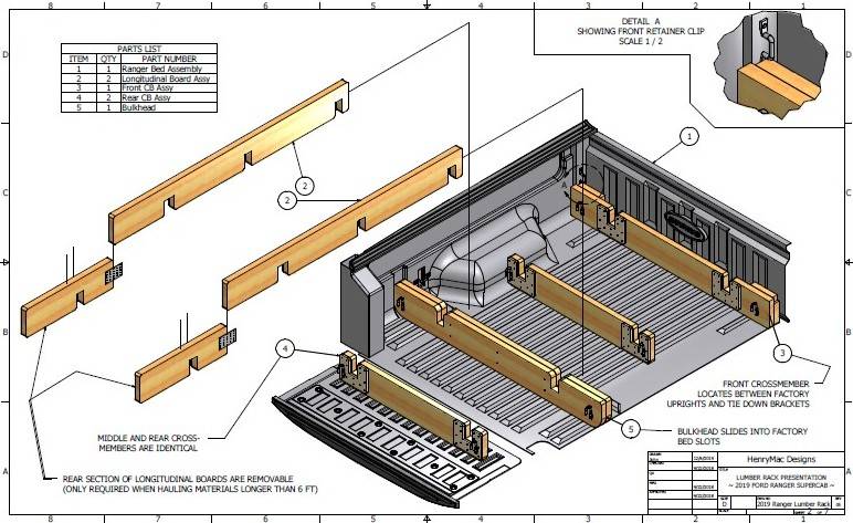

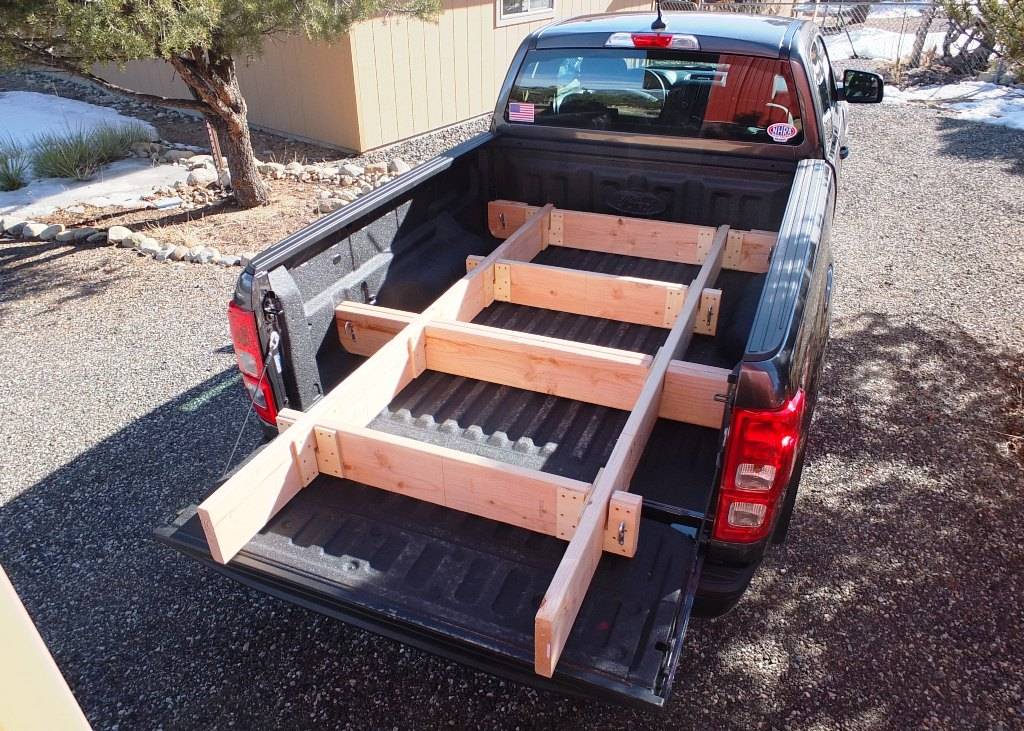

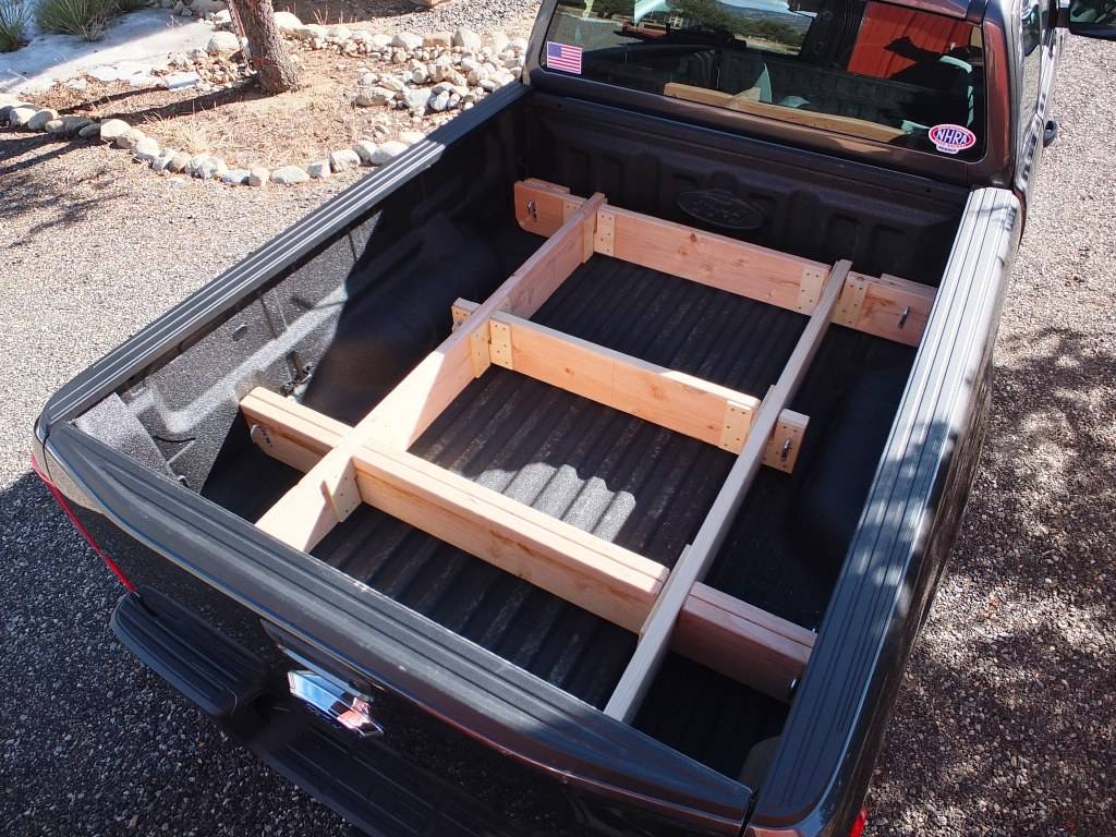

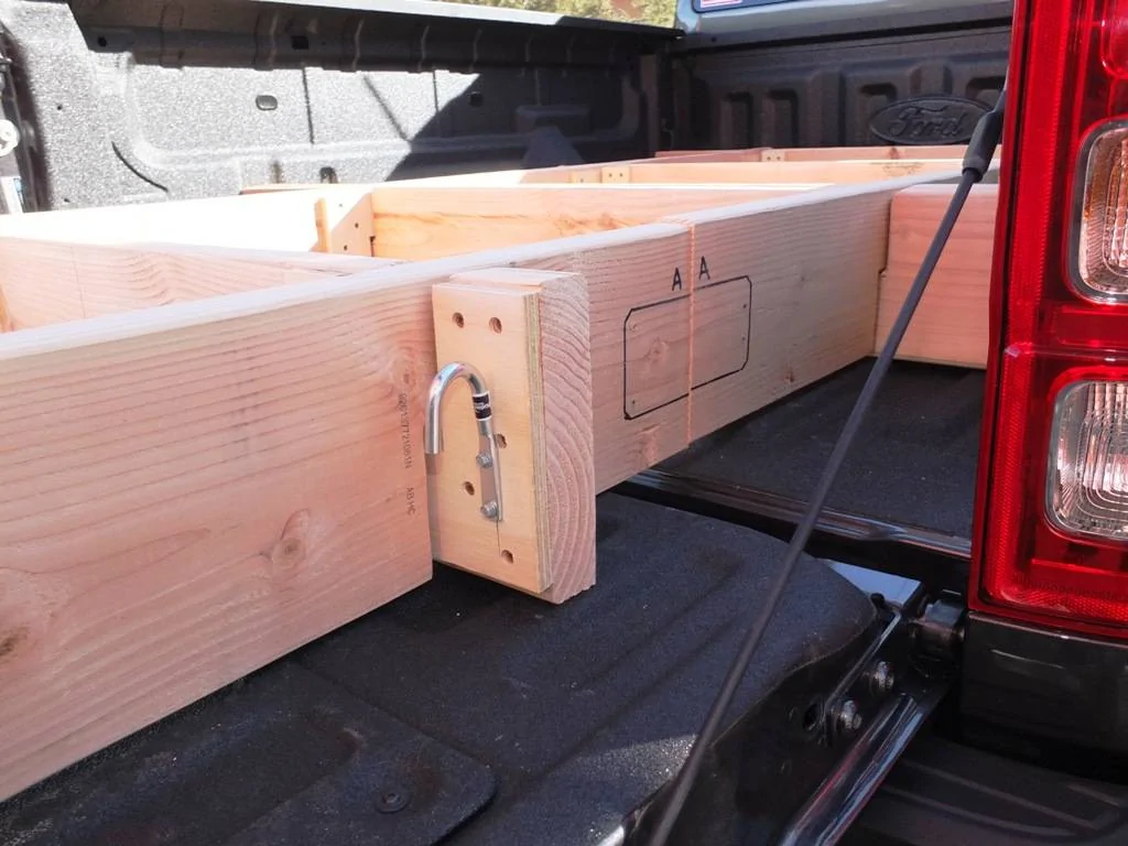

Is this meant to raise the bed height since the sides were designed too tall from the factory ?

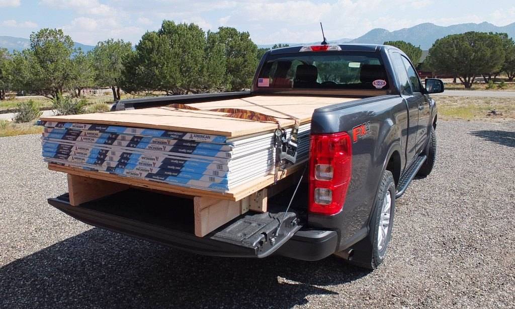

The design allows the user to load 4' x 8' sheets of material into the truck and to safely secure it.
Yes, it raises the load above the factory wheel wells, but the height of those wheel wells is not the issue, it's the usable width of the floor between the wheel wells.

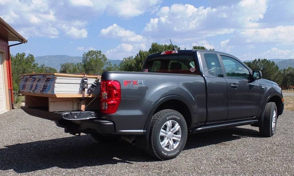

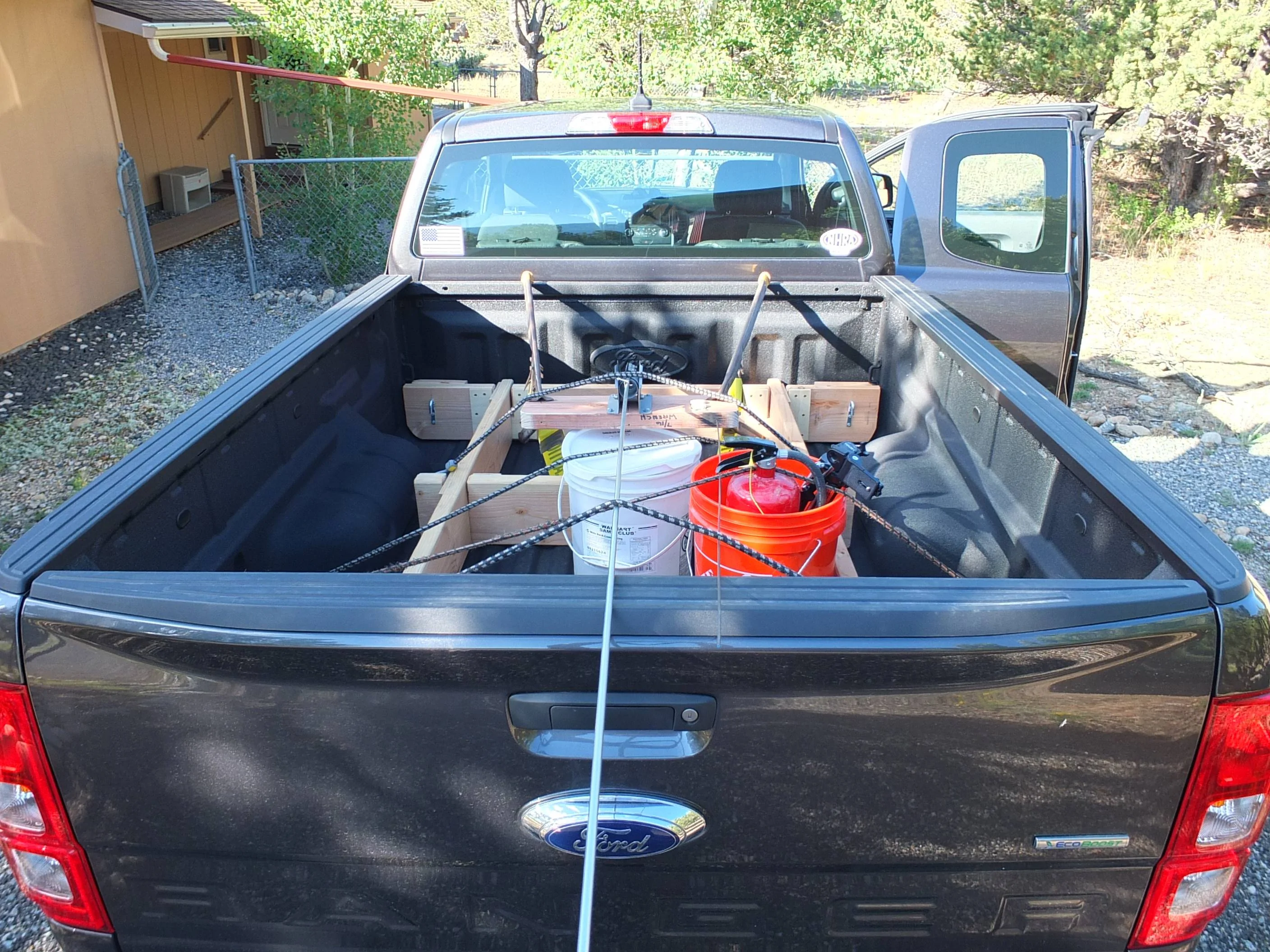

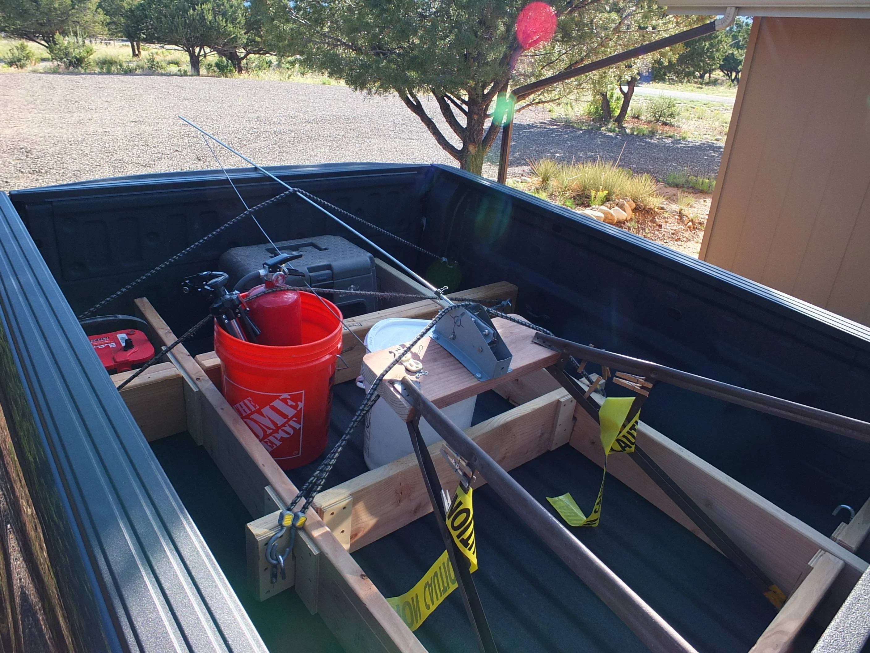

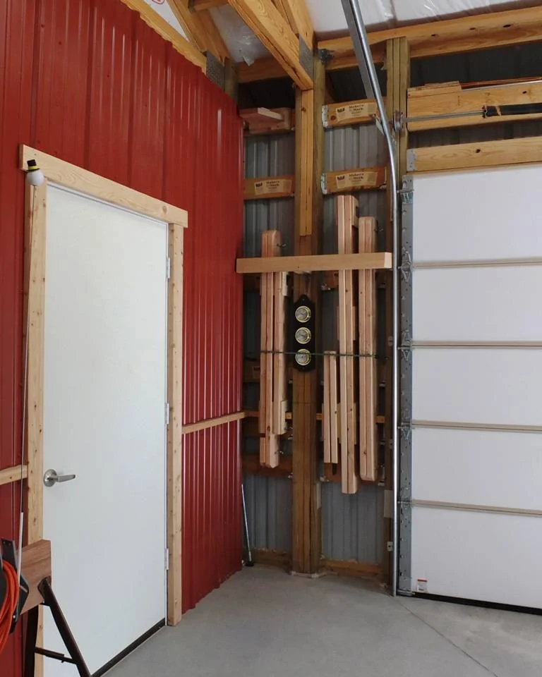

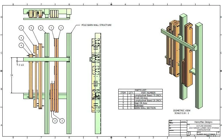

@Trigganometry glad it worked out for you. We've used ours quite often. the spaces between the lumber are ideal for placing items into before loading the 4x8 sheets.

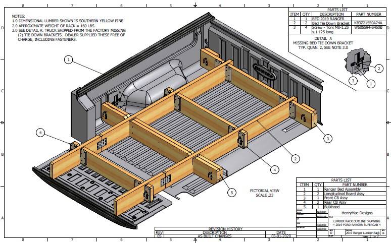

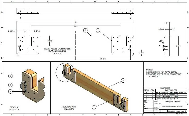

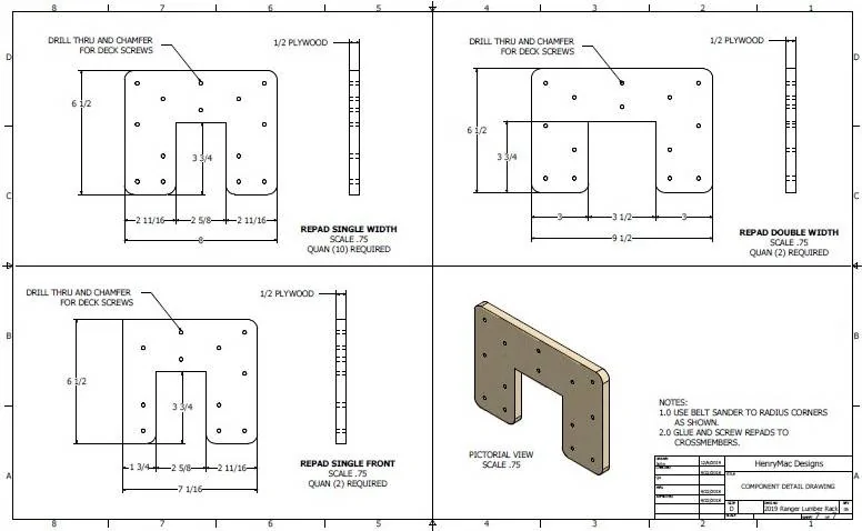

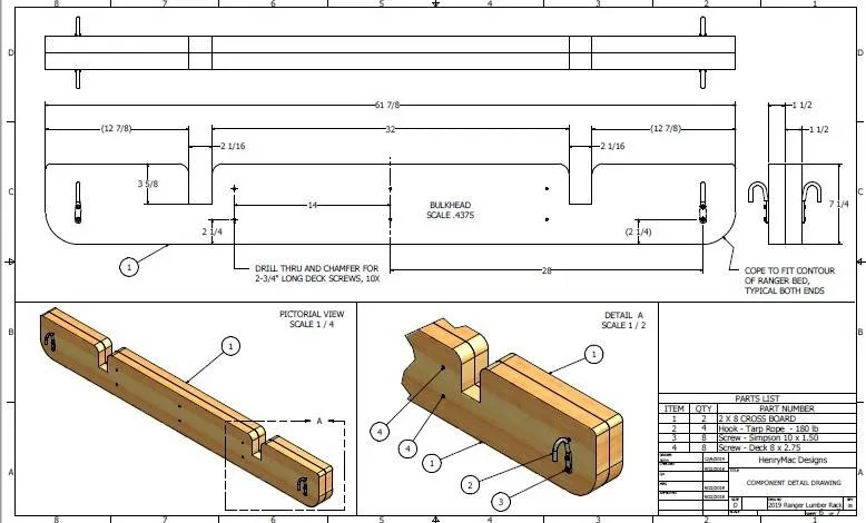

@LaBalbe Here's the original design in the event somebody else would like to make some sawdust.

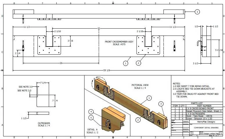

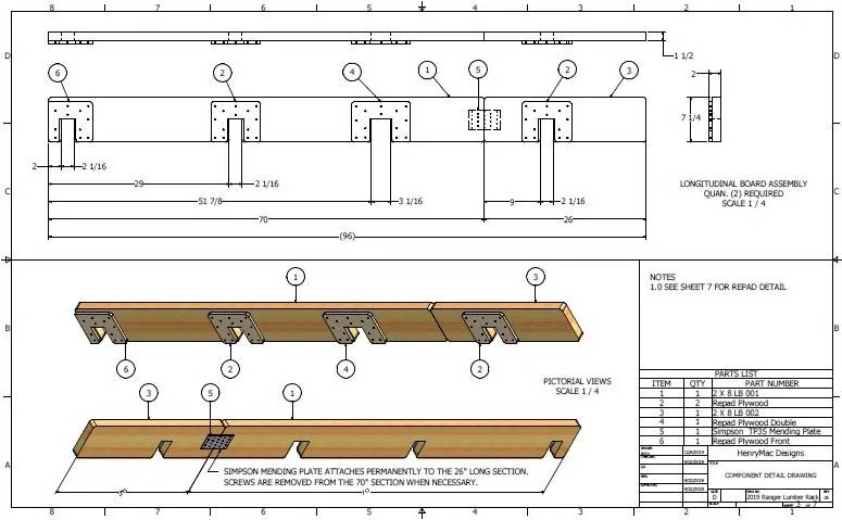

Well, I can appreciate the engineering and it looks like it could hold a lot more plywood than I'd want to load and unload! For Soupie's 1,882 pounds:
softwood 3/4" = 27 sheets​
hardwood 3/4" = 23 sheets​
That's one thing the Maverick did right with their two-position tailgate (I don't even know how a damper works on that!).

I just went hunting and all the photos from back then are dead links now. @HenryMac just went and picked up some 1/2 Sheetrock. That’s the bomb!

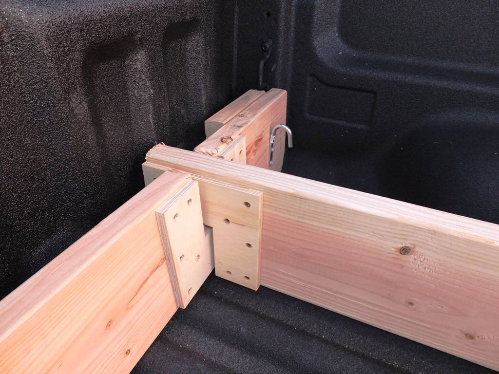

Thanks @HenryMac ; if I do end up building myself one, I'll have to tweak it a little since I have a SCREW with the shorter bed, but it's good to have a foundation to work from. I like how you've made it easy to take apart so that it's not a permanent fixture in your bed.
