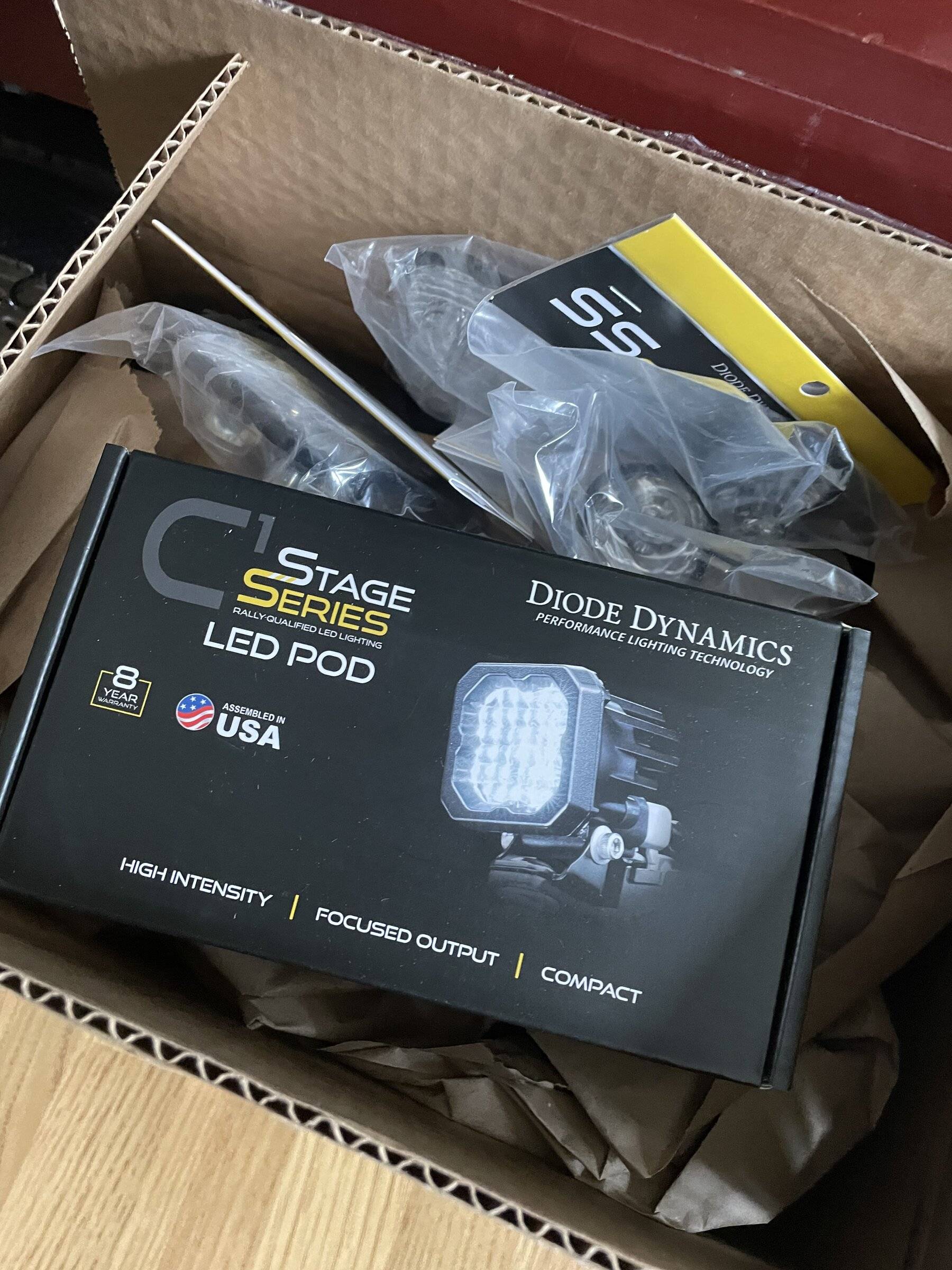

Wife texted, these arrived from Hot Shot just now. Hoping to carve some time this weekend to install them!!

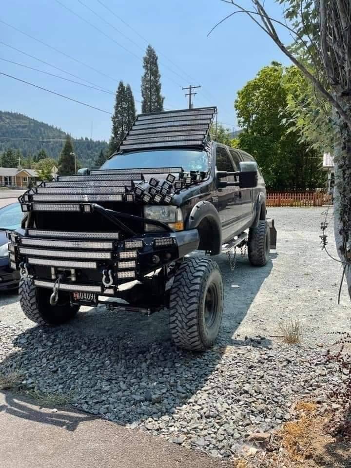

If your battery and alternator can't handle the power load, then it's enough.
That battery/alt has plenty more to give... ?
This is just one of four sides... ?

Of course. Pods doesn't draw as much power compared to light bars. A 42 inch light bar is around 224 watts. Just one of my MAX SS3s is 38.5 watts.
I can say this...... I used the battery alone to test out the lights when I installed more of them. One of them was flickering. I thought I did something wrong. Turns out the battery wasn't giving enough juice. I started the engine and all lights worked perfectly.

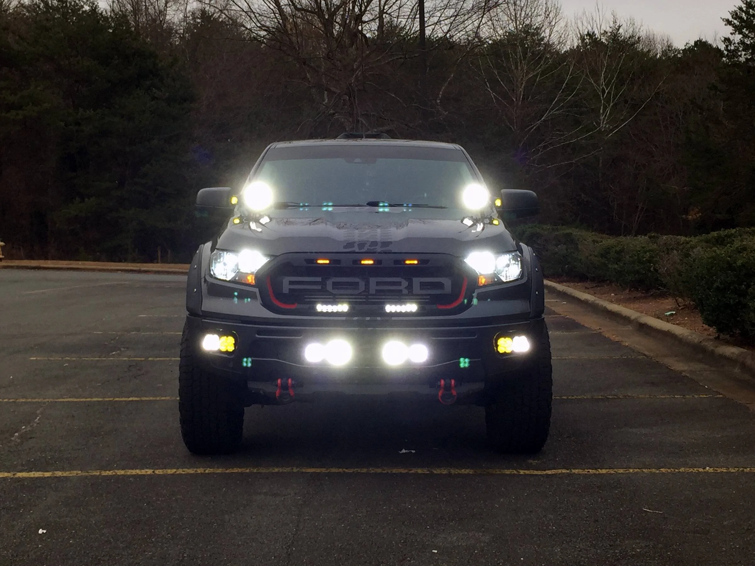

Each of the Rigid D-Pro are 36 watt x 6...that's not counting 4 x DD SS3 SAE + 8 x Lumens rock lights + 2 x BD S1 + 2 x BD S2 + 4 x 20 watt side pods + 2 x DD SS2 rear pods + 20" rear chase light bar...so yea...I have no idea how many watts total but I've had them all on (including Bambi mode) and neither the Ranger or Trigger has complained...I'm sure @OFC Ranger can top me with his watt count...?

Engine running....correct?
The alternator supplies...... Generator amps at 80.6°F (27°C) 105 amps at 750 rpm (min) to 170 amps at 2,250 rpm (max)
That's 1,260 watts to 2,040 watts @12volts ........ We're good. ?

I've done this for a few minutes with engine off...

A few minutes is ok. Any longer and it'll drain the power quick.
Not sure why one of my pods started flickering. I even switched pods to see if it was defective. Same problem with a different pod.
Nothing wrong with the wiring. It was rated to handle the power draw.
It was not enough juice from the battery. It was fully charged from the trickle charger.
[Yoda]Sensitive, these lights are.[/Yoda]
