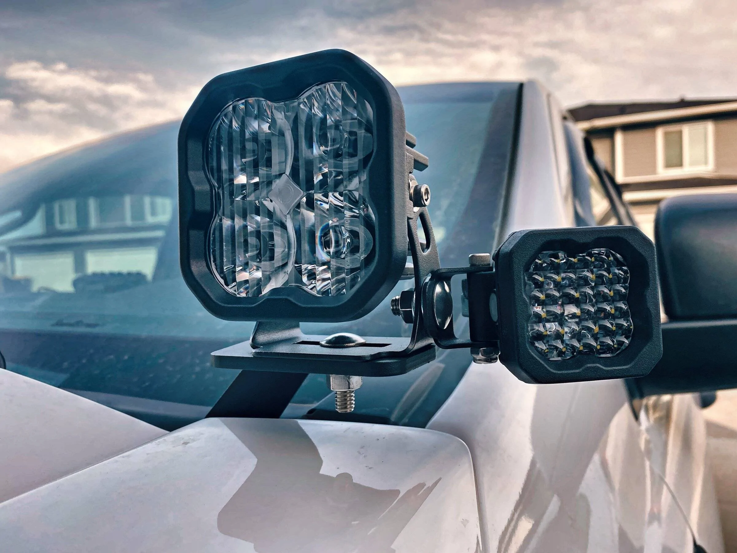

I have the Diode Dynamics ditch kit combo pro's in white and they are really bright, really well made, and easy to install. If you are worried about glare on the hood you can get driving pattern lights that have a more focused beam of light that wont reflect off the hood like combo patterns do.

I have the Diode Dynamics on order as well as their in-bumper 6" light bars X 2.

Baja and Rigid make some great products, but we love the DD pods. We have the SS3 Max and C1 Pro combo on our Ranger build and its been solid. We've tested baja and rigid before as well. And they both perform well! But DD is our best seller for sure. Feel free to message us if anyone has any questions or needs help getting an order!

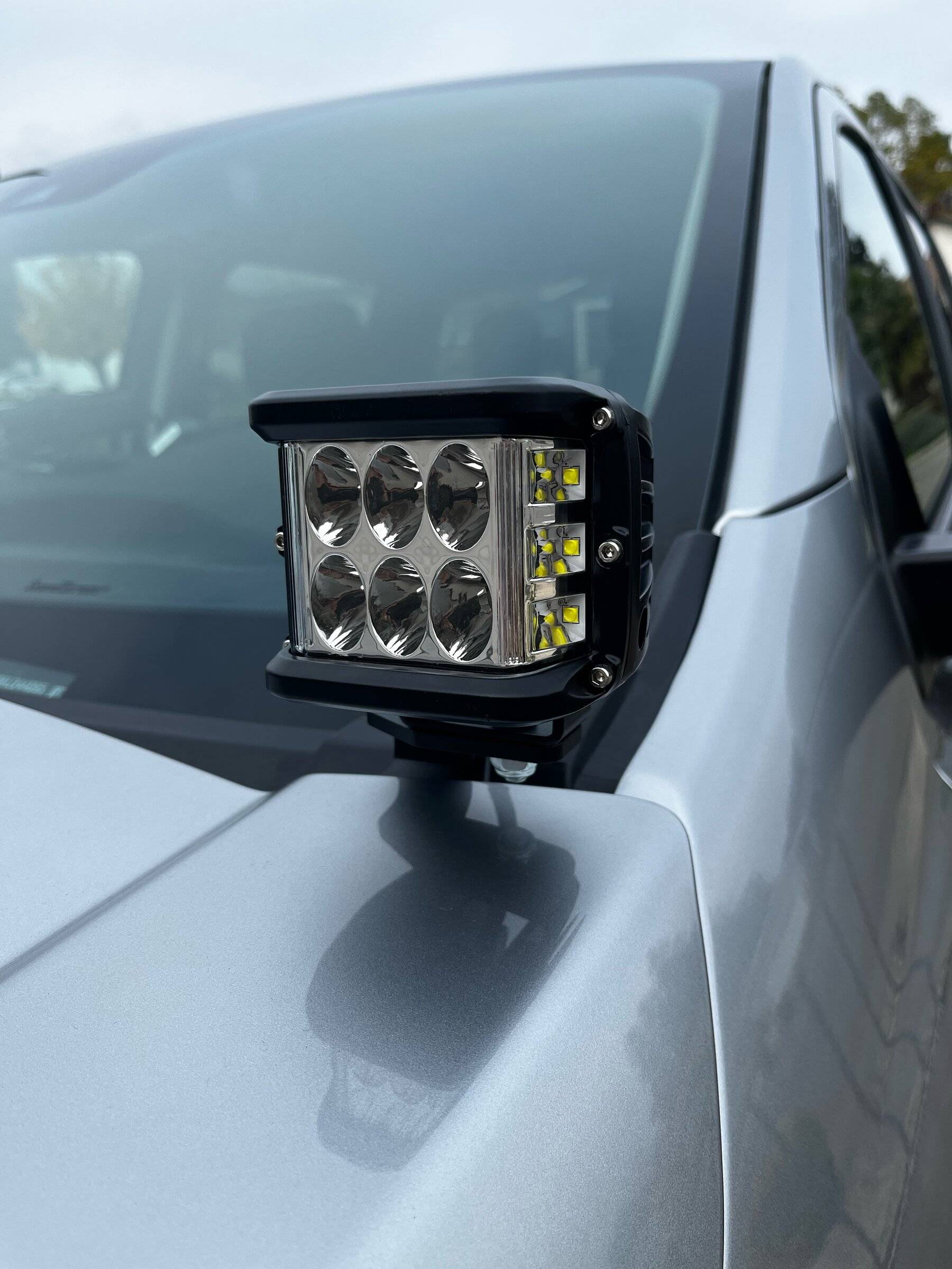

I am trying to keep a 'clean' look without looking like the Clark Griswald of the area, so I am testing out the Cali Raised LED 'Side Shooters', so far not bad at all for $150 a set w/mount. Bright enough for what I do in any case.
Can you send me the link to the light and mount please sir?
