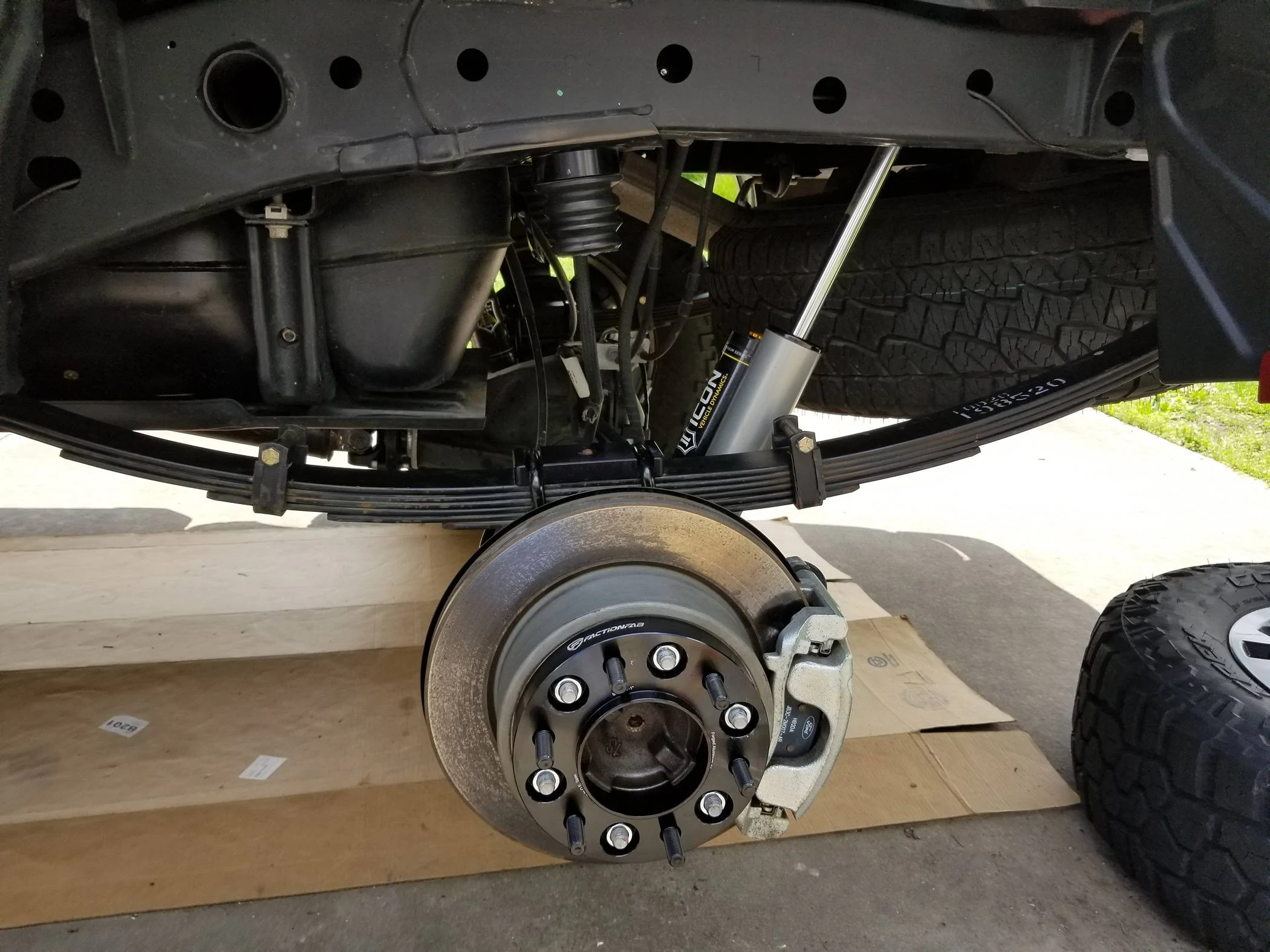

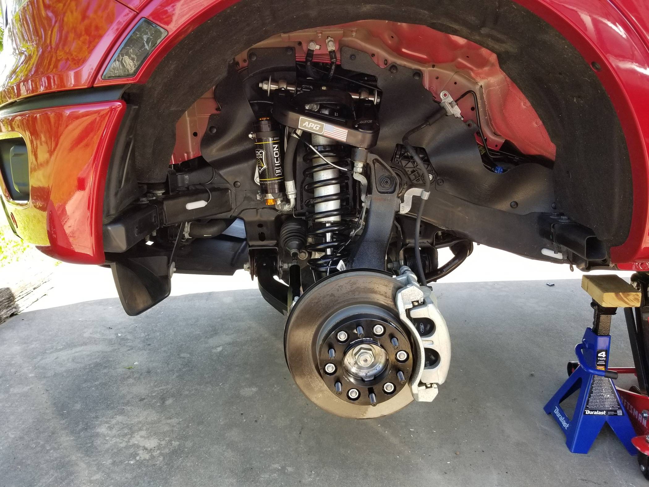

For "tearing up the desert" with minimal weight in the bed , a King/APG/ Deaver or ICON/APG/ ICON Mid-Runner system is the way.to go...
ICON 2.5 CDCV EXT RR Coilovers,
APG Billet UCA's and Billet Tie Rods
ICON 2.5 CDCV Piggy Back shocks.
ICON RTX Progressive leaf springs
ICON Universal foam bump stops..

I had sumospring, but then replaced them with the APG bump-stops since the sumosprings are too tall. The icon bump stops seem ideal, that or I just cut the sumosprings I have! Those APG UCA's look like mint.

The APG Billet UCA's are milled aluminum, with an anodized finish....I live outside a small city, on a secondary road that they don't treat with salt or brine when it snows. I also will put on a rain suit and take my creeper to the carwash for wand spray of suspension and under carriage after any offroad adventure that included mud...?.... I used 3 n1 Oil Dry Lube and Blue Locktite during suspension install, after 3 years have never had any squeaks.

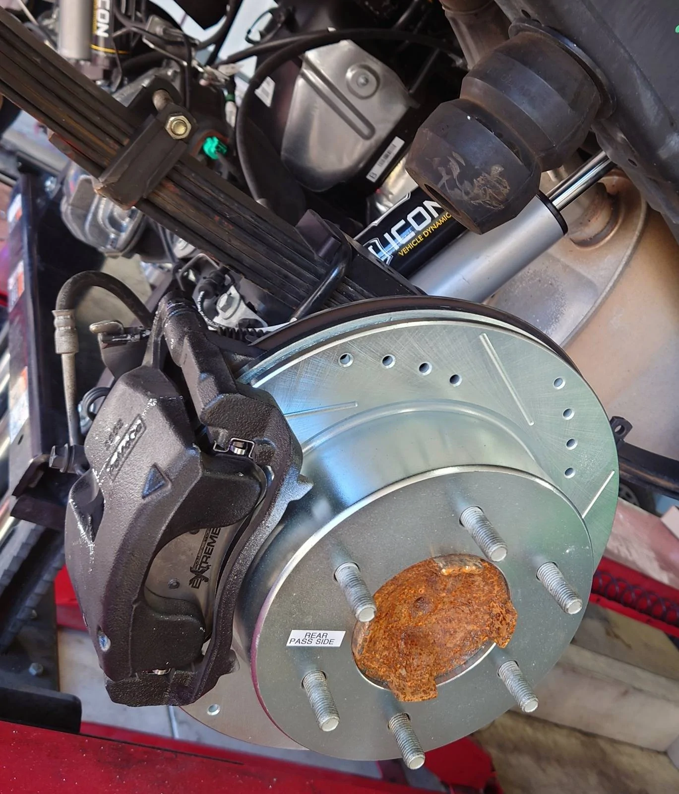

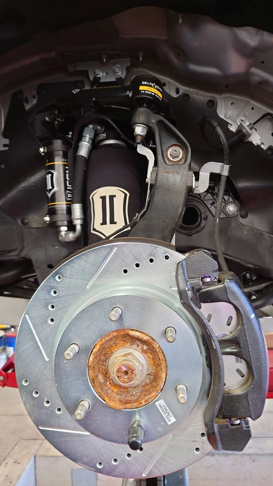

I went this way. A great upgrade, but not an unlimited budget. DId basically the ICON Stage 6 in phases.
I tow a trailer and upgraded from Bilstein 5100's up front and 6200's (w/Resi) out back. Pretty happy with the results.

I must admit that the coilover cover on the icon is a nice touch, especially if you drive in the mud often! Thanks for sharing. Nice brake kit. Is that also from icon?

Thx. Brake setup is from Powerstop.
