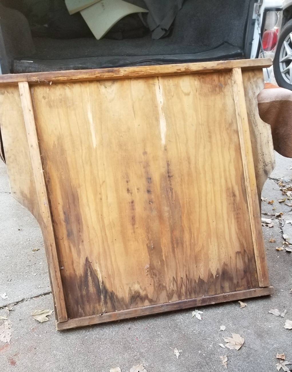

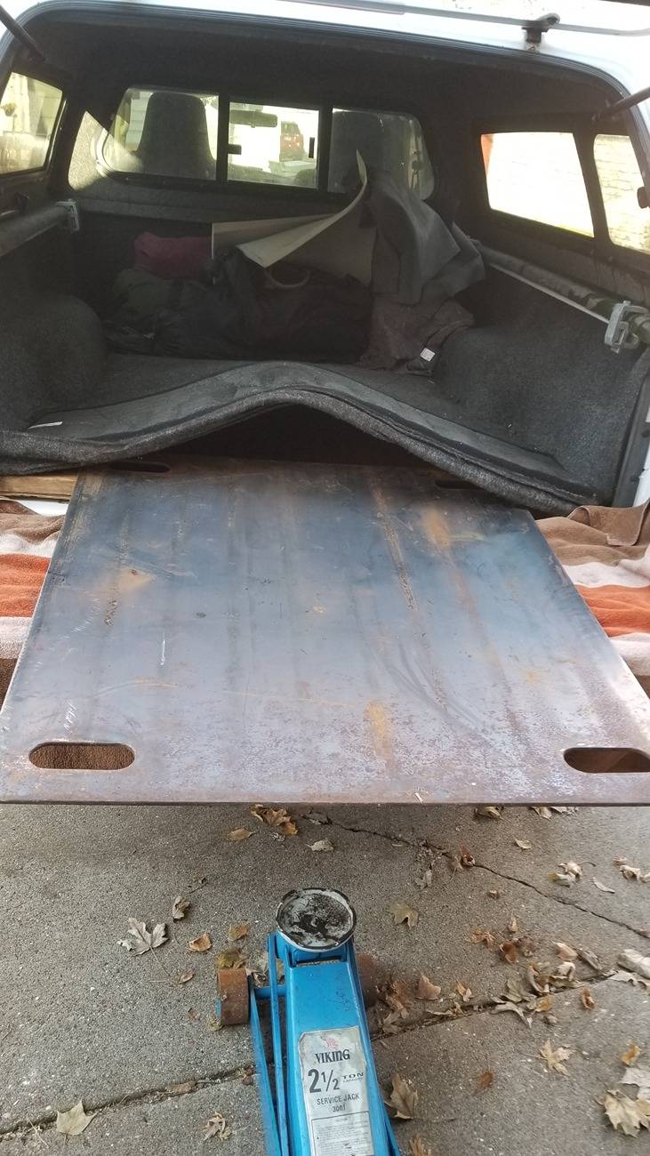

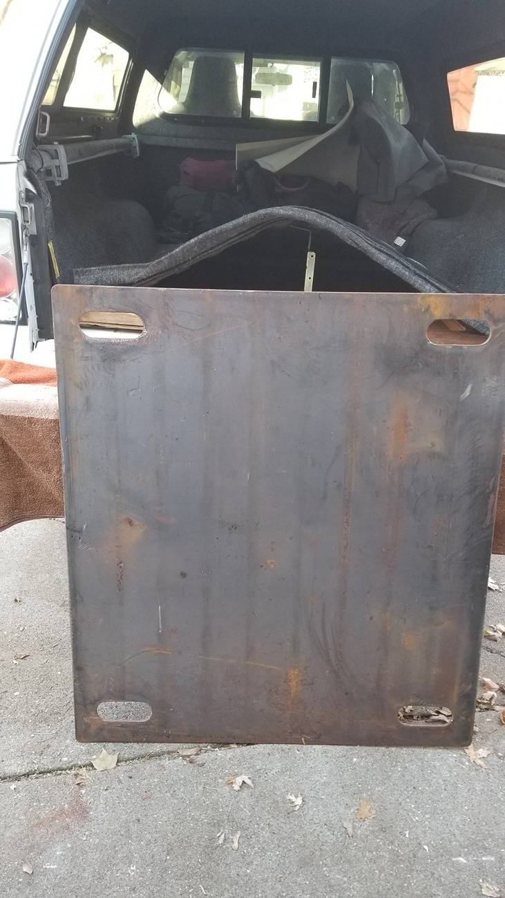

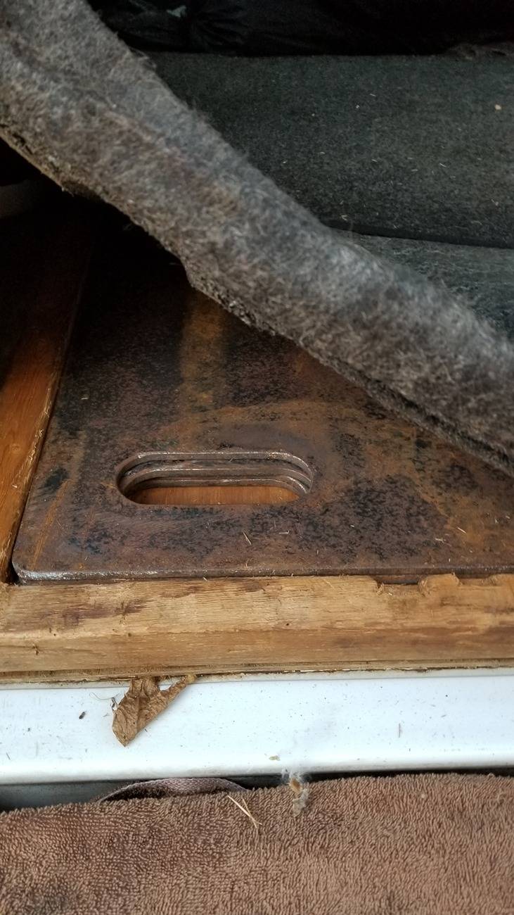

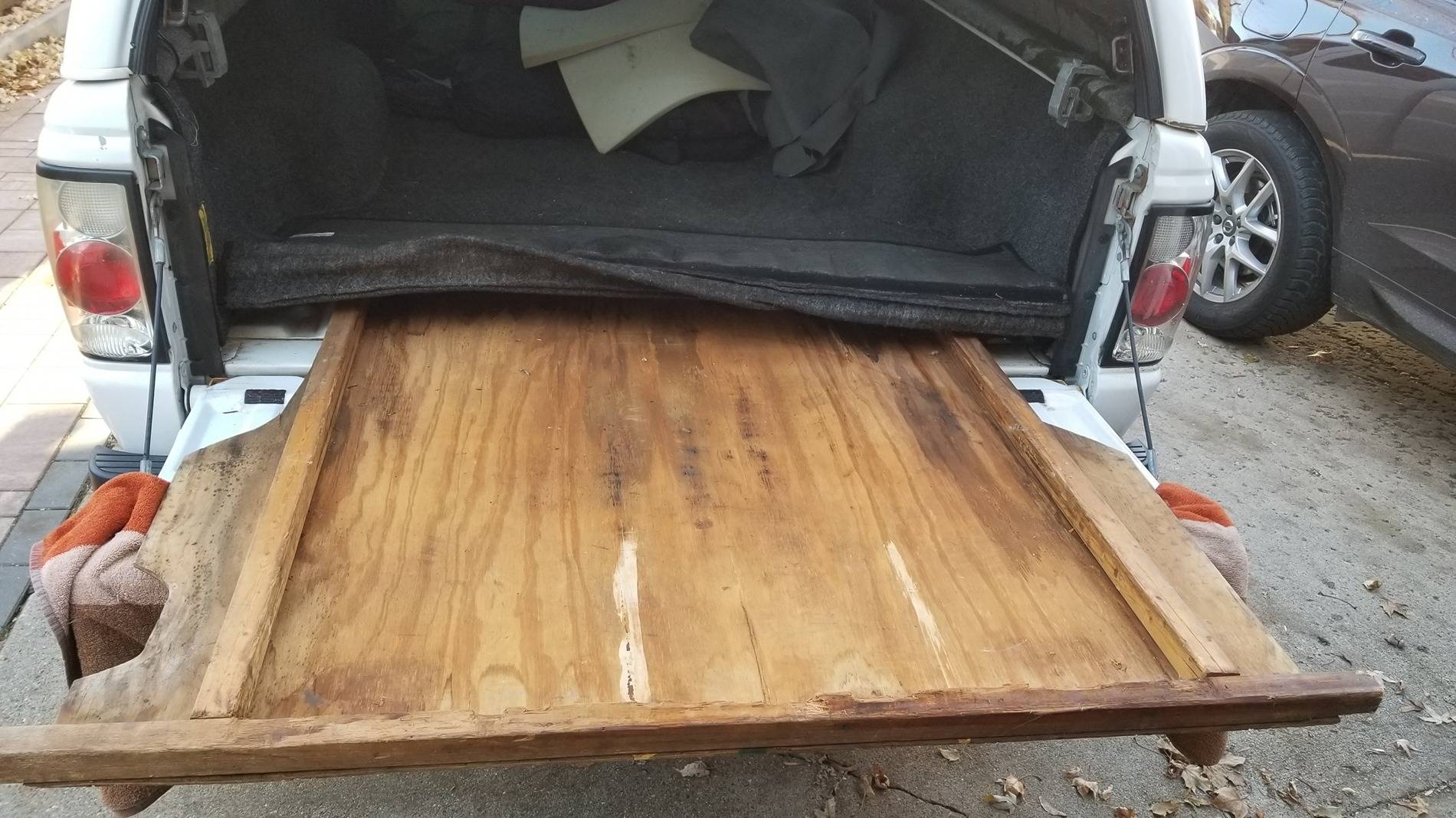

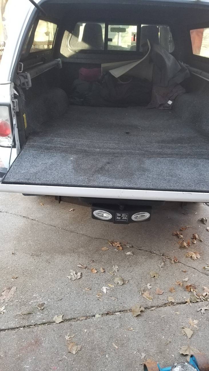

For my previous Ranger (a 2005 Extended cab) I built a 1"x1" wood frame on 1/4" plywood to hold 4 sheets of 1/4" plate steel. The frame just fit between the wheel wells. The steel was laser cut to fit the width of the frame and the length was calculated to make each sheet weight about 100 lbs.
Nov 1st, slide the frame in under the bed rug, slide in each sheet of steel. Done. Now in the best of all worlds, I would have drilled holes over where the bed bolts were located and used 1.25" longer bold to hold the plates in place in case of a large bump or rollover.
Come spring, reverse the process (get some mpg back).
Still have full use of the truck bed. No big lumps or bags of stuff.

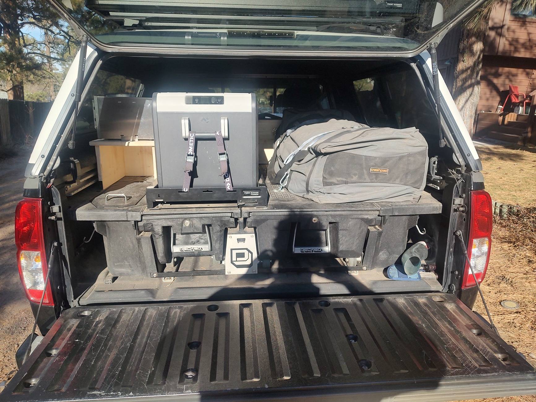

300lbs of tent, awning, and assorted overlanding and recovery gear is what I do
