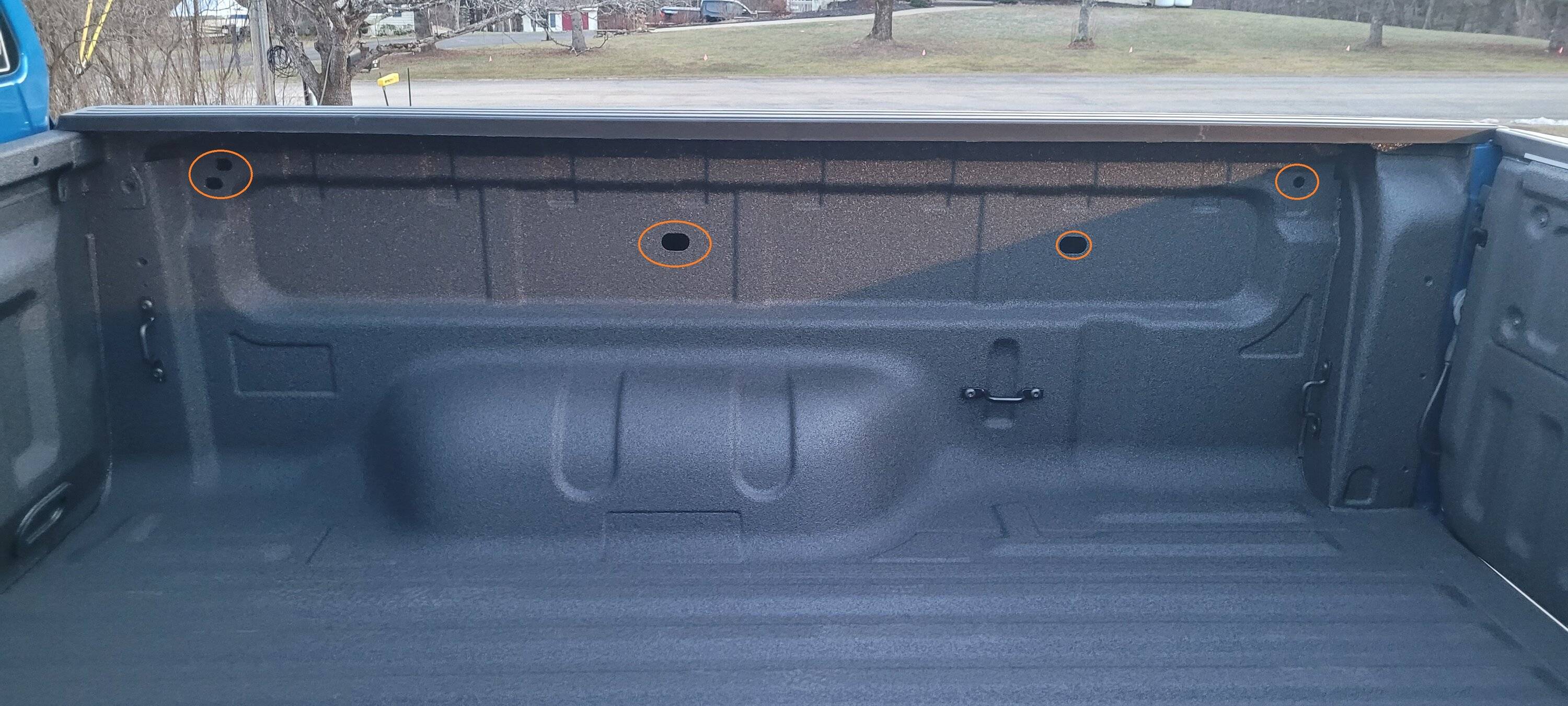

I had bullet liner pull out my factory drop in liner today and do a spray in liner. Looks like none of these holes had plugs in them under the drop in liner. I scrolled through the ford parts break downs but am having trouble find these. Any one else have to source these plugs?

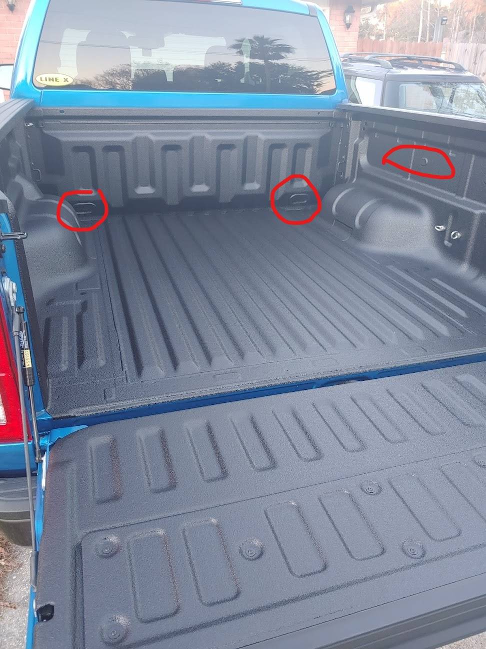

My 2021 has the plugs that are on the lower front bulkhead.
Annnnnd...I deleted my first post....mine does have the side plugs, but only the two that are on the sides....holes at the front and rear are not plugged.......had the truck for almost 2 years, and shows how observant I am.....

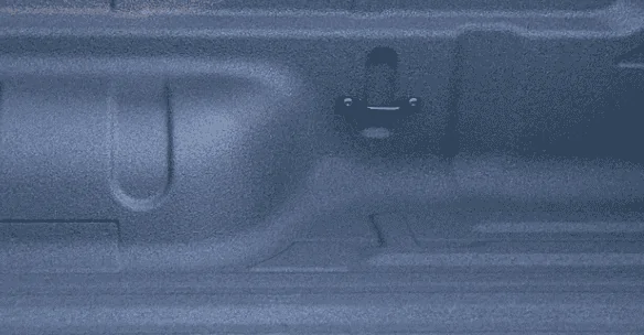

YOU GOT A MID BED SET OF TIE DOWNS ON A 2022?
I will trade you for my plugs.

They didn't come with the truck. I sourced them and handed them to the bullet liner guy when I dropped it off.
This was my EXACT reaction to spotting that tie down. I need to do this in my tray.
"HOLY JESUS... THIS MF'ER GOT MIDDLE TIE-DOWNS..." lmao!!!

Did some measuring and pulled some part numbers from the link below for any one else who finds this thread. Not 100% sure but ordering some will update once they arrive.
https://www.fordpartsgiant.com/parts-list/2019-ford-ranger/body_and_paint/plugs_body.html
Large oval holes in middle of bed - W717988S300
Small round holes to the rear - W706019S300
Small oval holes - None found from Ford
Large square hole on other side not shown in my photo - none found from Ford
