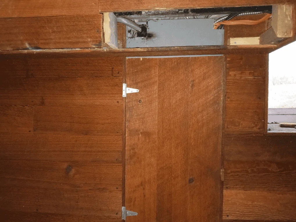

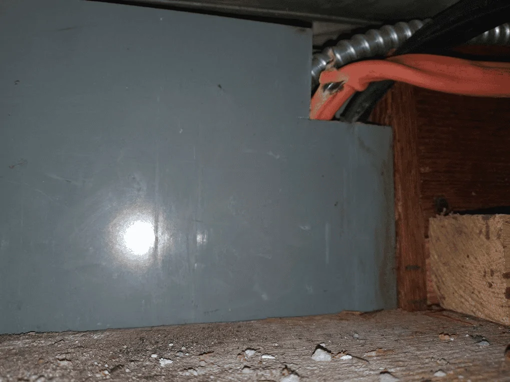

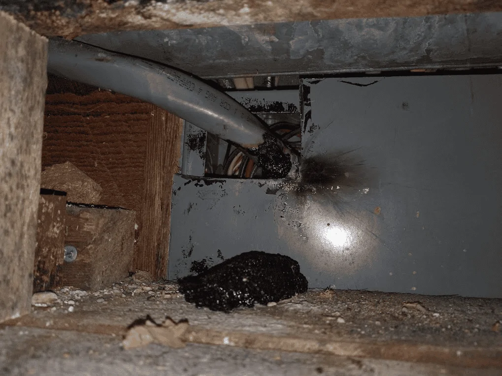

Just discovered what is looks like some dangerous electrical work. I realize accessing the side knockouts is practically impossible given the framed in wood work, and access through the top is difficult, but is this even remotely up to code? This is the front of my electric service panel.
I wonder how many times that has arced

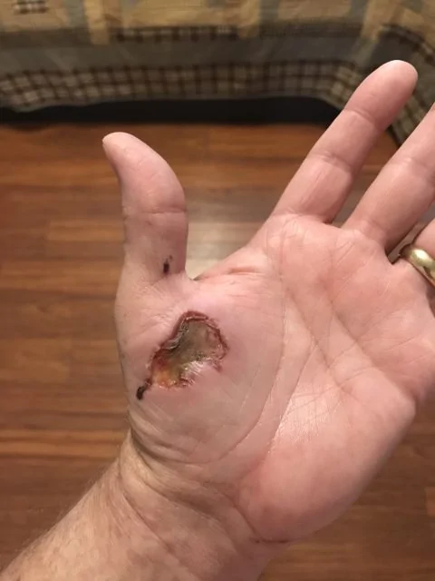

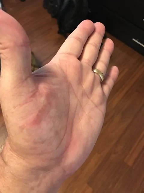

Ever get bit by 480? I did, and lived to tell the tale.
Took several years to fully heal, (still itches occasionally as nerves re-connect) and I have a scar today. But I lived, and the hand still works.
Impressive! It takes times for those nerves to calm down and reconnect. Had nerves damaged during surgery on my big toe joint. Took 3 years for the fire to go out in my toe.
At least twice. I am glad all contractors involved did not hesitate to correct their errors.
