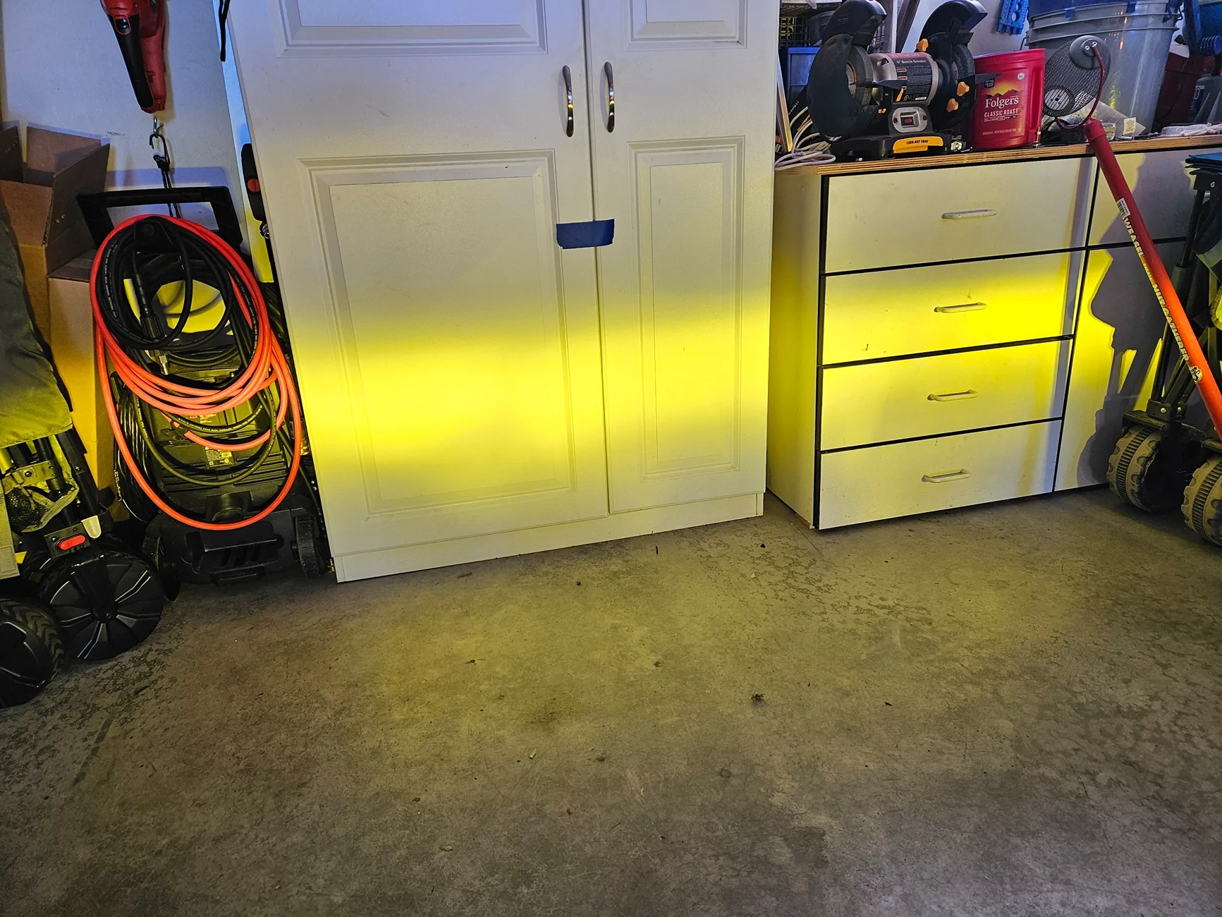

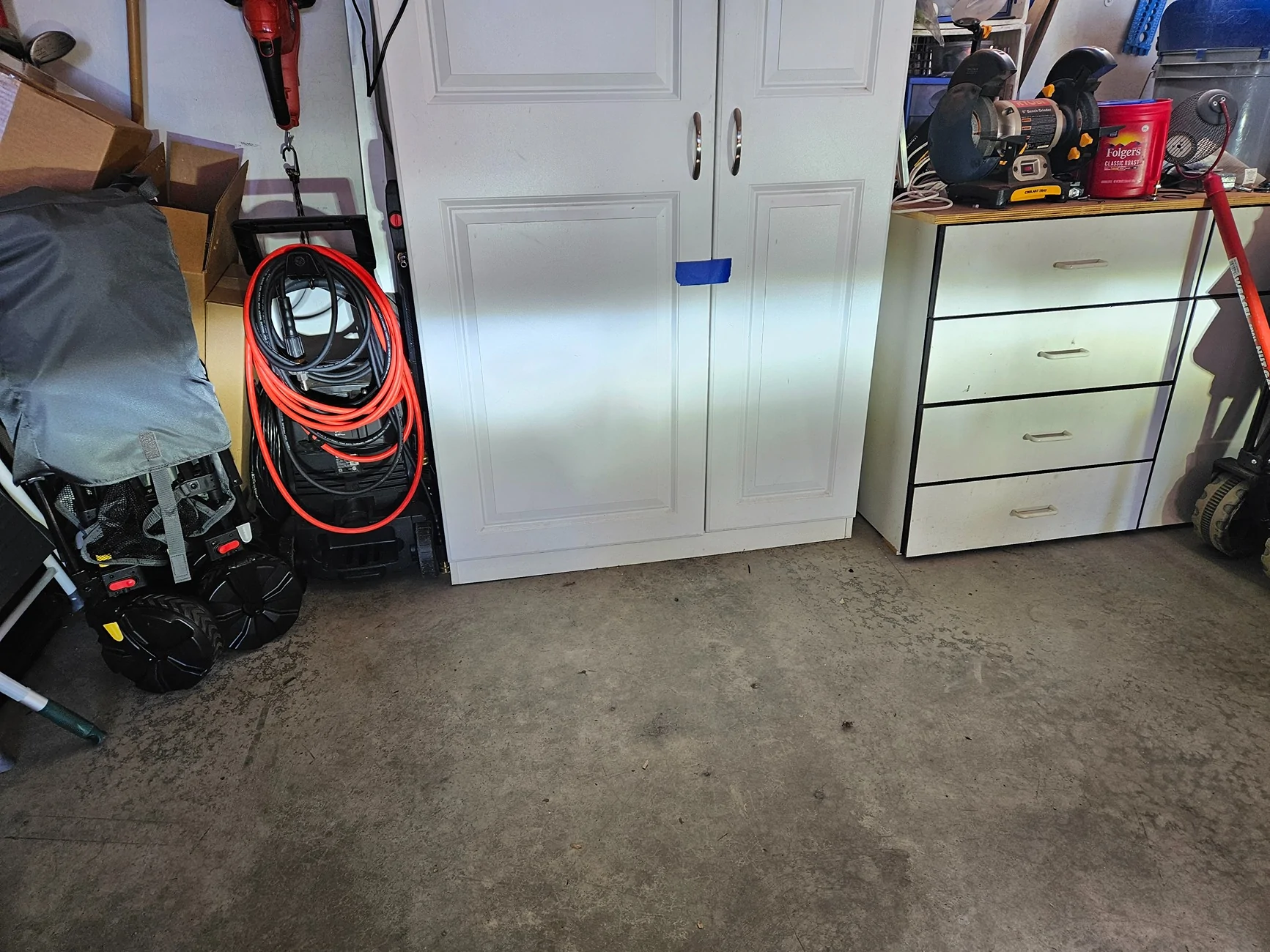

Now i need to find out how to do this. I would really like that. LOL. Here we go on another rabbit hole.
Another option. " Lasfit LDplus series led H8/ H11/ H16 switchback bulb with a brand new appearance provides a unique way to upgrade your vehicle's lighting. 2 Modes Switchback-3000K yellow/6000K white light increasing overall visibility and road illumination in rainy, snowy, harsh weather. " https://www.lasfit.com/products/ld-series-h8-h11-h16-led-fog-light-bulb?variant=28514963226708

wait, what?
So, I know I must have read about it here:
https://www.ranger5g.com/forum/threads/forscan-crowdsourced-wiki.2008/
That said, my only notes on the change are here:
"Daylight running lamp set to fog light (top of BCM set to all options),
switched low beam to fog light."
Hope that helps, I wish I had the time to get it connected again and verify it but time it tight right now.
