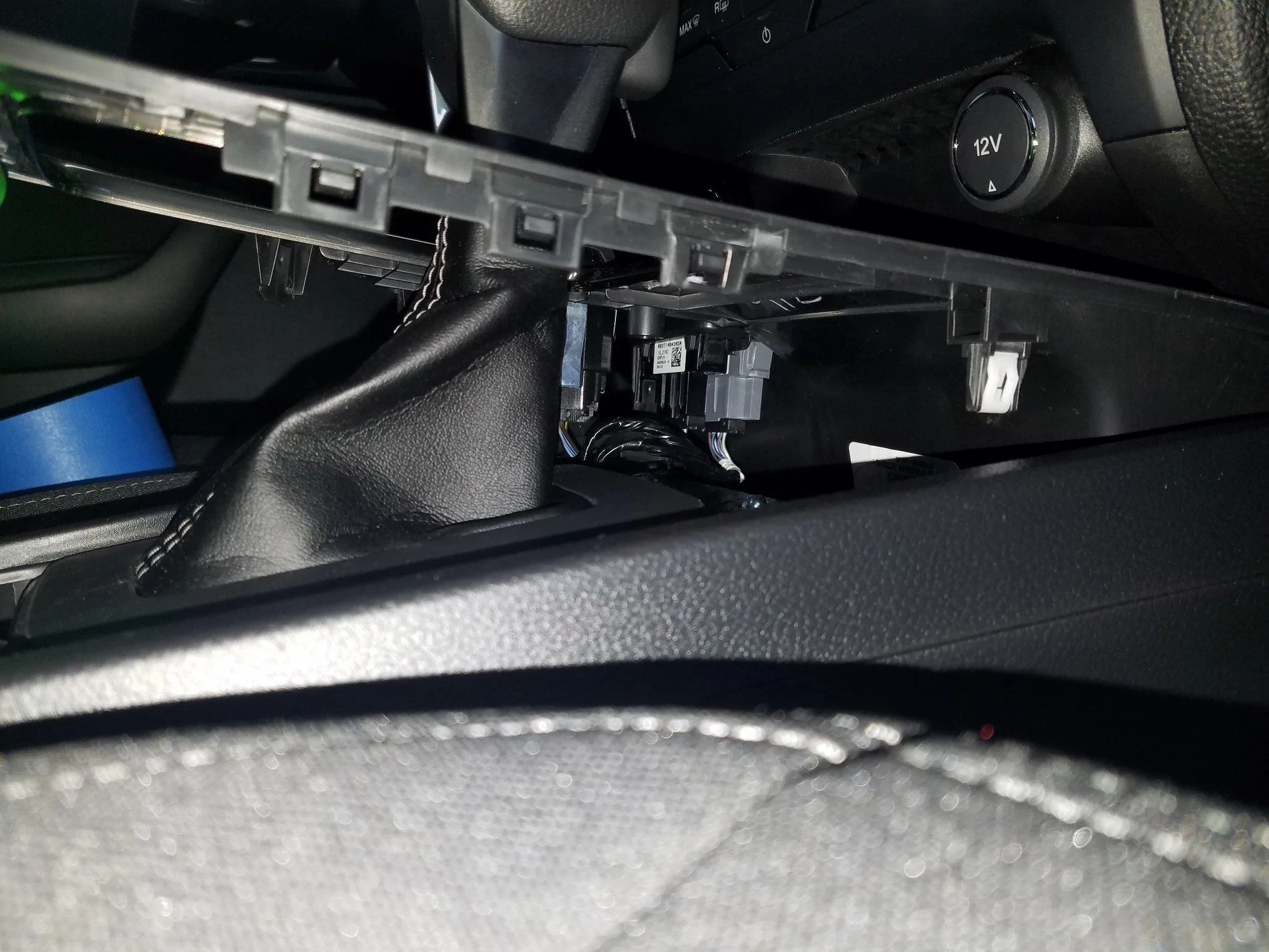

I finally had enough of my truck shutting down at lights and I got this installed. As I mentioned, their video showed them lifting the panel only on the end, but the online instructions showed them removing a whole bunch of extra panels. I used a door removal tool to pry the panel up on the sides and it popped up fine. I didn't need to remove the extra panels. Thanks to Mr Schilke for the tip.

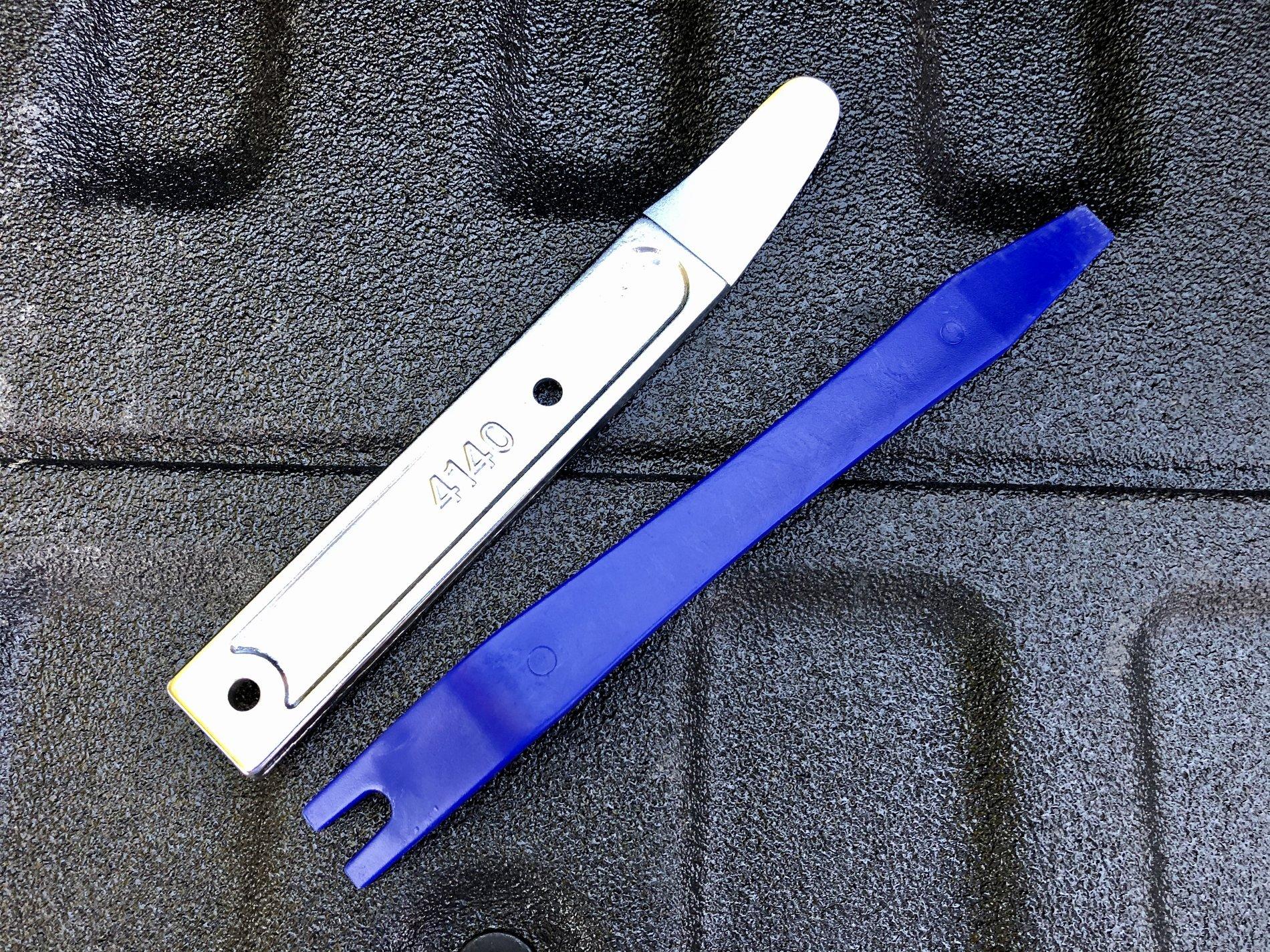

Something like this that I've had in my toolbox for 20 years:
Harbor Freight has a more appropriate set of non-marring plastic tools for $10 though.
It's still hard to get my big hands in there and unclip that little side clip to pull the plug out though. So I took a wire hanger to cut up and bent a little L to stick into the tab area of the plug to push while I tug on the plug. I could reach the tab from the outside them. Then it popped out.

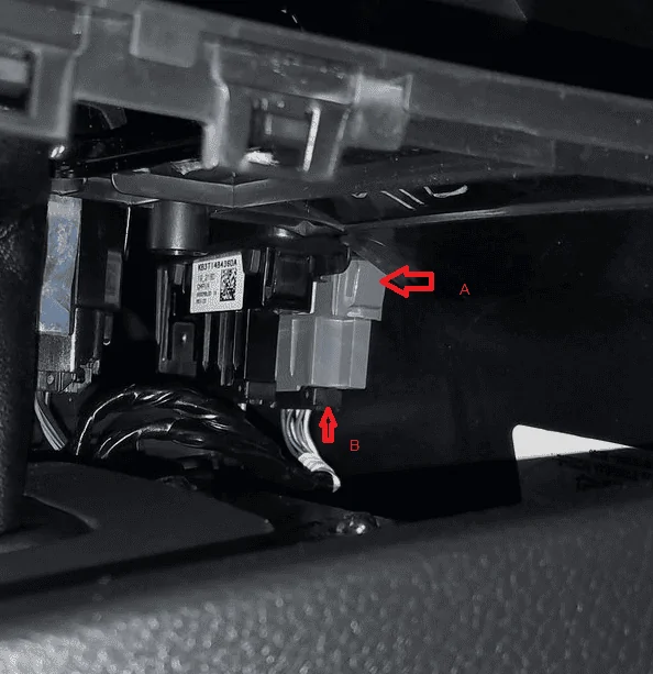

Just installed eliminator, very happy with its function, however this kind of customization should have been available from the factory. I got sick of having to depress the button to activate every ride when using D (drive) instead of S (sport) mode.
For myself it was easier to push in the side tabs on the larger grey connector and push the entire switch (A) up and out rather than pulling down and out the inserted wire connector (B). When I tried to push the tab to the side on the smaller connector B my fat fingers just didn't work so good. Plus there is a higher level of difficulty working on the smaller inserted connector blindly.

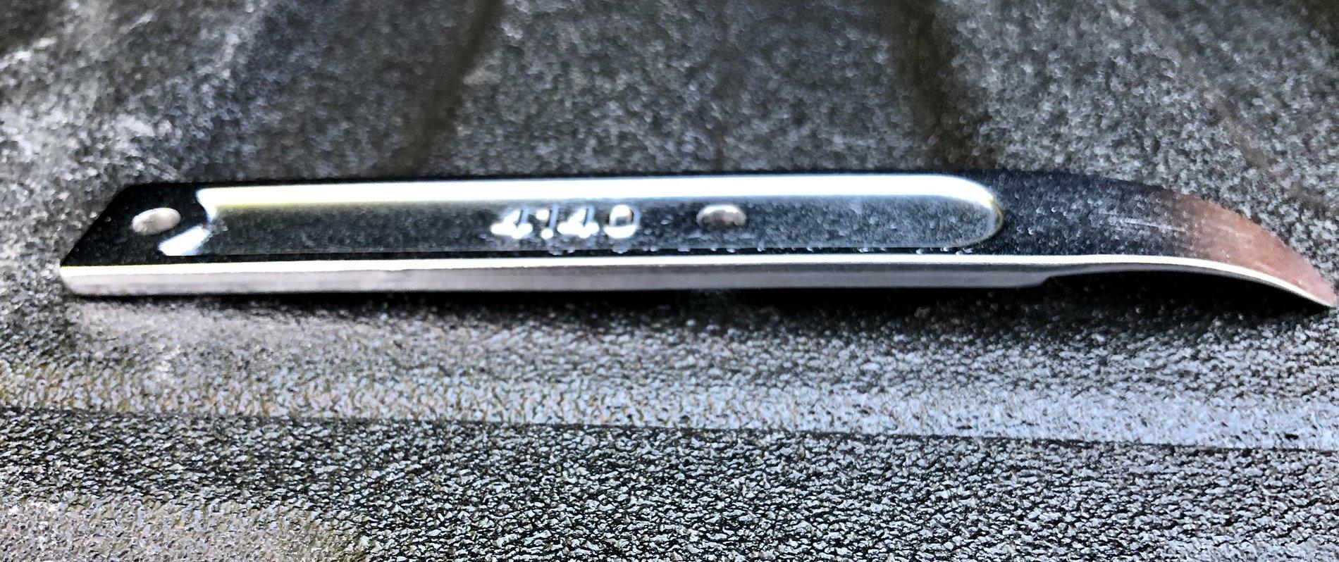

Great panel tool. The best.
Metal one. Search aircraft panel tool.
that looks really nice=, but I think it would scratch up the dash. especially this hard plastic. I do car stereo and I have never seen metal panel tools for cars.
It is designed for aircraft industry.
I have used plastic tools and they still scratch plastic. The metal too is very smooth, thin and rigid. You can better control and get better force with it. Worth a try. One could add tape to back prying surface to help. Even felt could be taped on. I find it a better tool than all my plastic ones. Like an extended thumb nail.
