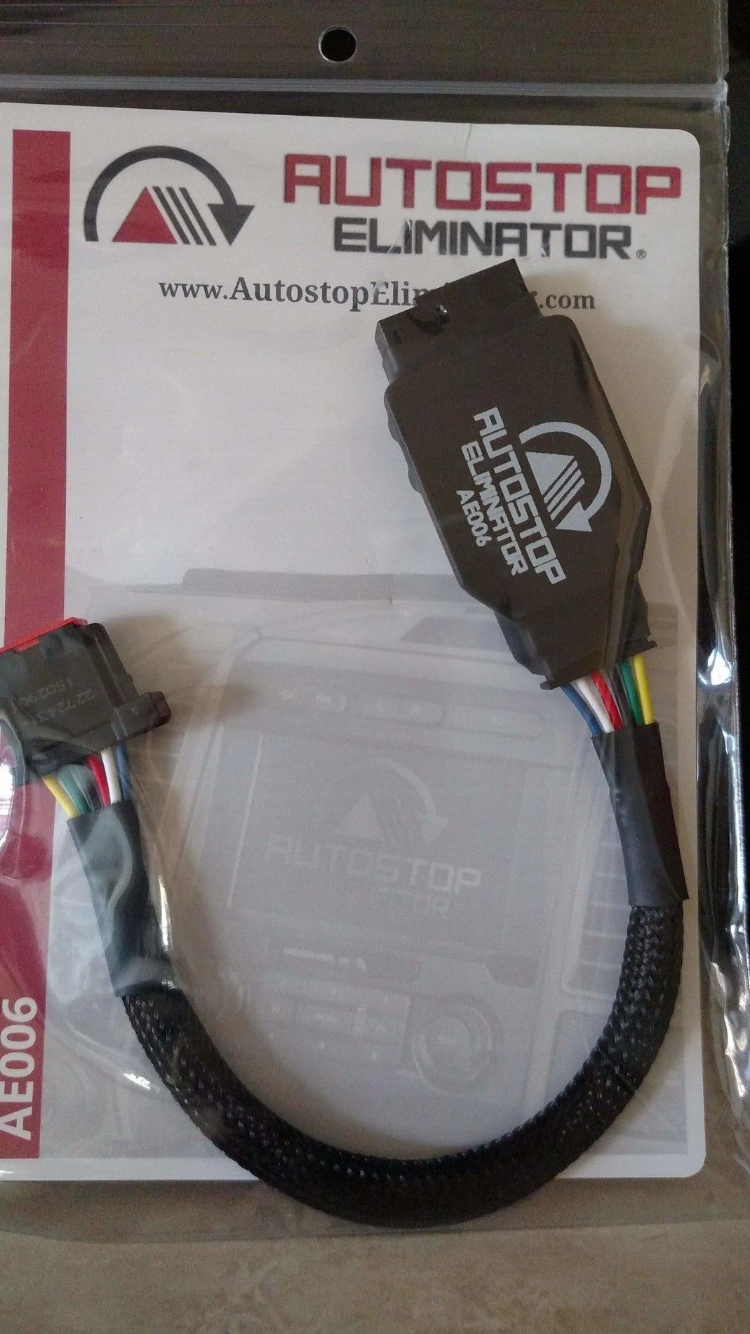

Ok....Figured it out, I had to open the panel under the steering column, which is hinged at the bottom and exposes the fuse panel. Once this panel is out of the way the LH finish panel popped off no problem.
The instructions say:
"Remove the finish panel to the lower left side of the HVAC controls by gripping the edge with a firm grip
and gently increasing pressure to release the 6 fasteners. There is an alignment dowel molded into the
plastic in the upper right corner, so be sure to only pull straight back in this area."
What they dont say at all as (you can see in the pictures), the finish panel is retained by a seventh clip that is part of the under steering wheel trim panel. So before you pull on the lower left finish panel OPEN the trim panel under the steering wheel by gently pulling it towards the driver and it will hinge down freeing the lower left finish panel.
The right finish panel was as instructed with six fasteners and is not interference fit. It was easy to remove if you open the glove box to help bring it off straight back.
I apologize for bumping an old thread, but the installation video looks like a 2 minute job with only 1 panel to snap off. What's up with what looks like about 30 extra steps and extra panels? Is it because you have the 300a equipment group package? I have the 301a equipment group so maybe the video method might work for me.
Bumping my own thread. The center console panel doesn't want to come off, and if I try harder I am likely to break some tabs. That must be why the instructions have been amended to add the other steps to remove the other panels. The tabs in the back have to be pulled up, not angled up to pop out.
The vendor should really remove or update the video though if it doesn't really work well.

Hi Z
I just popped off the center panel. It will come off Took me all of 15 minutes to install. Good Luck! BTW...I do have plastic Trim removal tools to keep from marring the trim.

Zaph
Nov 28, 2019
768
2,110
Thanks for the info. To clarify, I can snap off the panel on the rear side of the truck as shown in the video, but when I stick my hand under there to pop the rest up, they don't want to pop up.
Would it help to stick a removal tool under the sides to pop those up also? I have some removal tools but I wouldn't say my panel removal tool collection is awesome.
Hi Z,
Yep! Come in from the sides...

Got my autostop eliminator today. Less than an hour to install. Works as advertised. No more trying to remember to push the button every time i start up. Autostop eliminator.com. Use code AUTOVLOG for an extra 10% off. Total $76.
