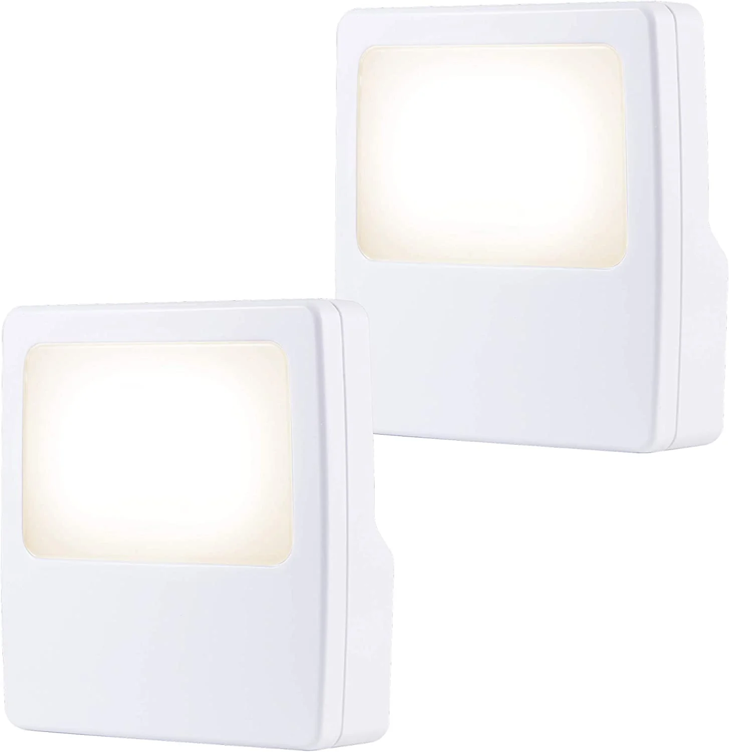

It will default back to "on" whenever you restart the vehicle. I don't believe there is anyway to turn it off permanently in the regular vehicle settings. Get used to hitting the on/off button, putting it in Tow mode, or put a cheap night lite in the plug in the back seat. Or Forscan?

And a nightlight is not something I want sticking out of the 110v outlet with my 70 lb. bird dog moving around back there.
