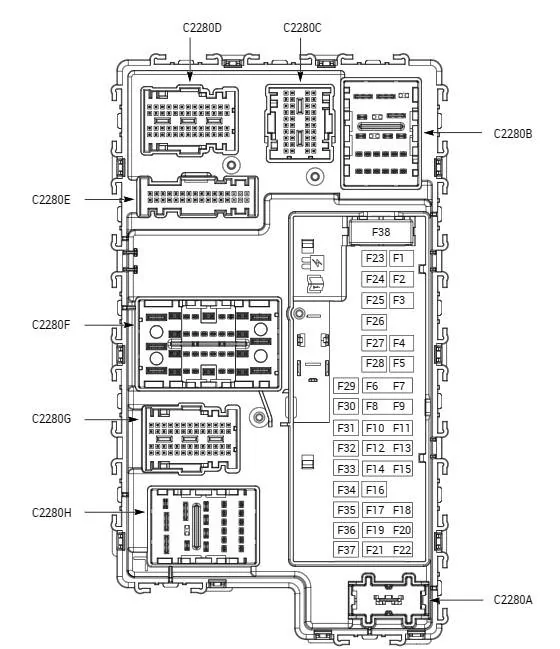

To clear the Install Instructions up - add some clarity to the BCM connector location C2280F
Instructions = (Top Left) but pictured correct
Actual is:
and I can confirm pinout and wire colors match the install instructions as called out.
