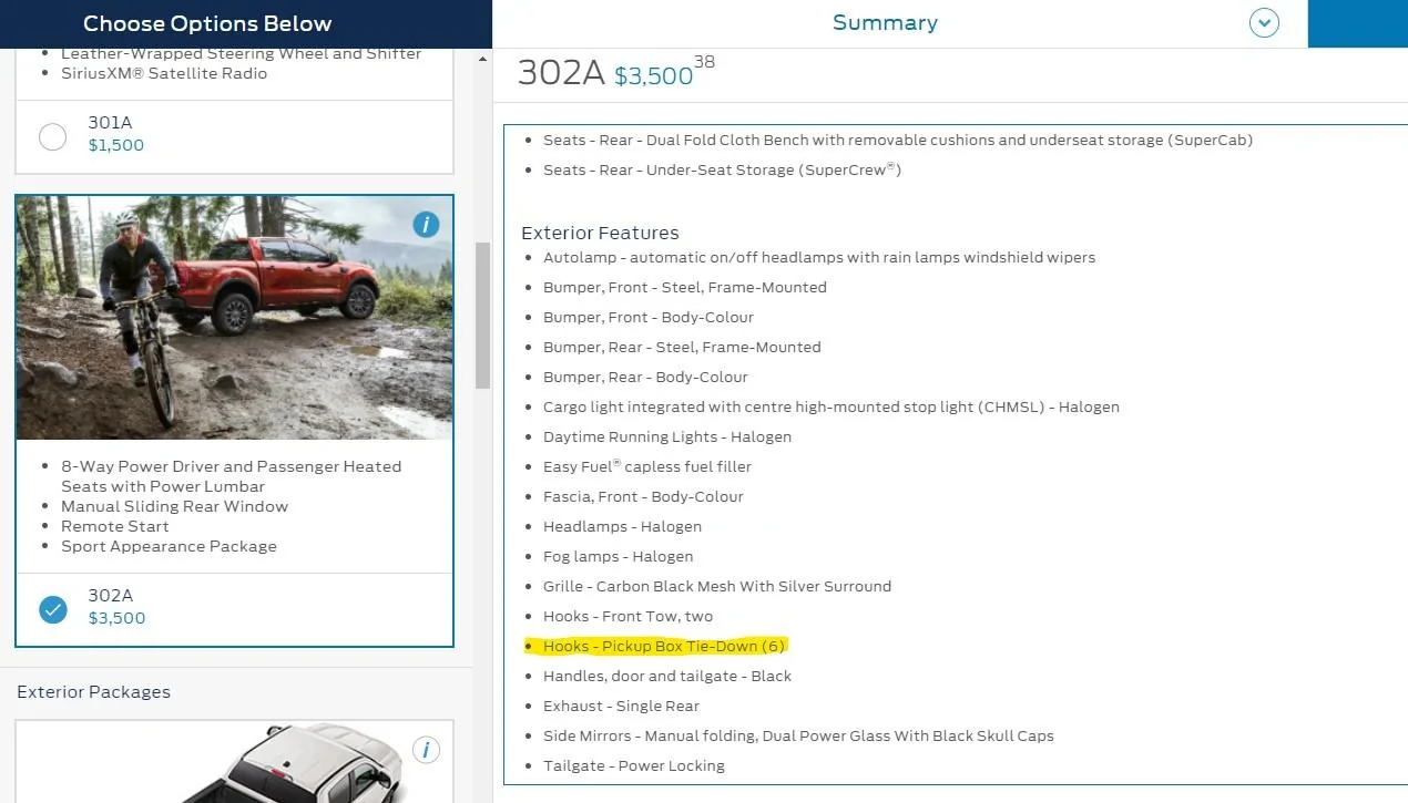

Buying a Ranger? Check for the middle tie downs

same problem -- I ordered a set with bolts and the holes are dunked up with the bedliner stuff do you remember what size tap did you need? I can't get the bolts in and id like to have the third set.
Yep, that happens, I stuck golf Tee's in the holes prior to getting the Rhino Liner done, kept the holes clean.

found a set of taps on amazon for about ten bucks, chased the threads and got them installed the other day -- thanks to those who posted the thread size I knew that was the solution but was worried about messing the threads up and never looked for the thread size --- it was ridiculously easy oh and it offsets my tailgate damper really well :thumbsup: :LOL::LOL::LOL:
