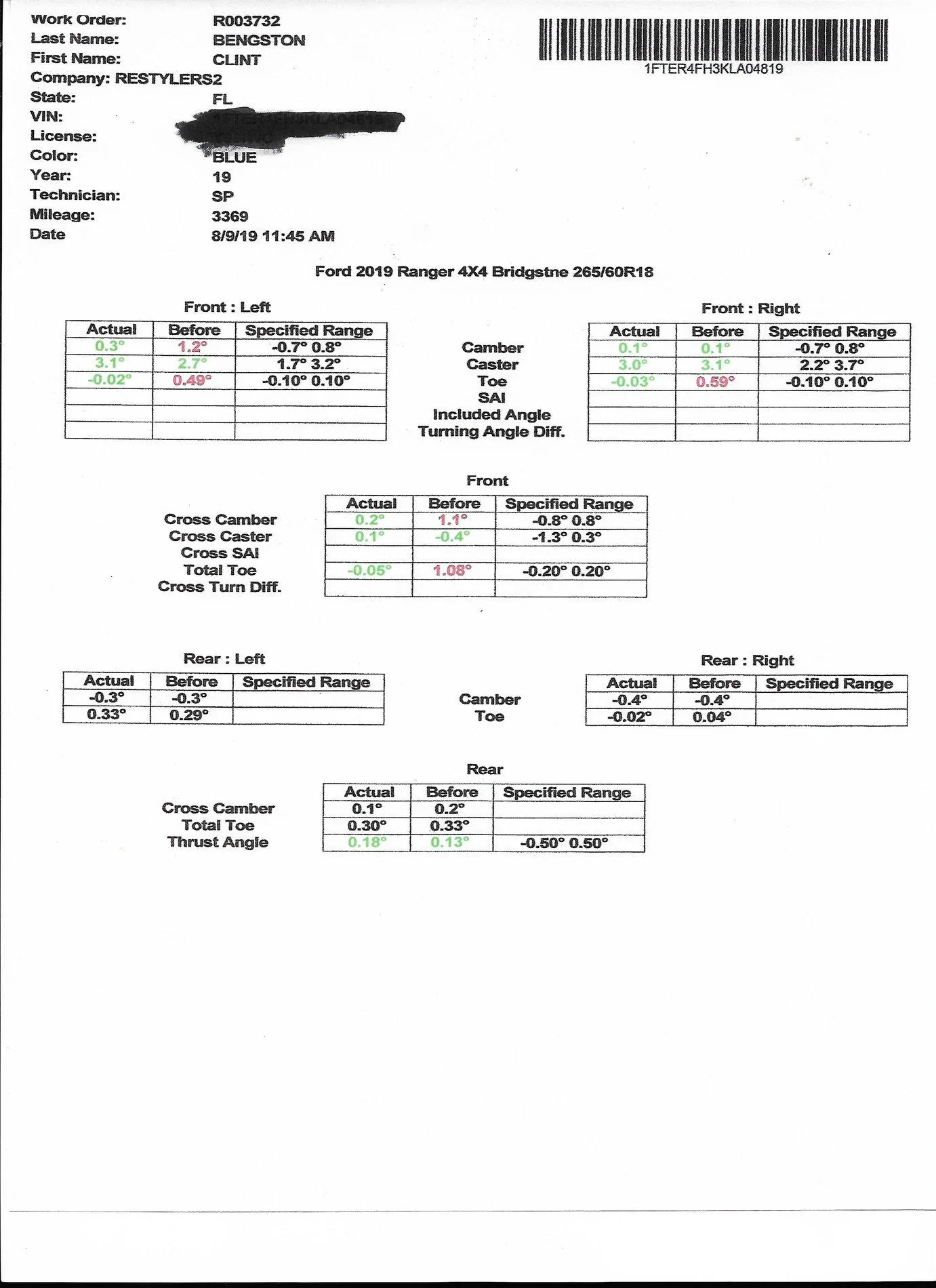

Here's a copy of my last alignment.
I find it interesting that your Rear Left tow is .33 and Rear Right to is .04. My truck rides fine but tires seem to wear more on the sides. How much does Rear Tow matter. Mine is Left .31 and Right -.01. I wonder if it is a manufacturing thing since ours are so close?
