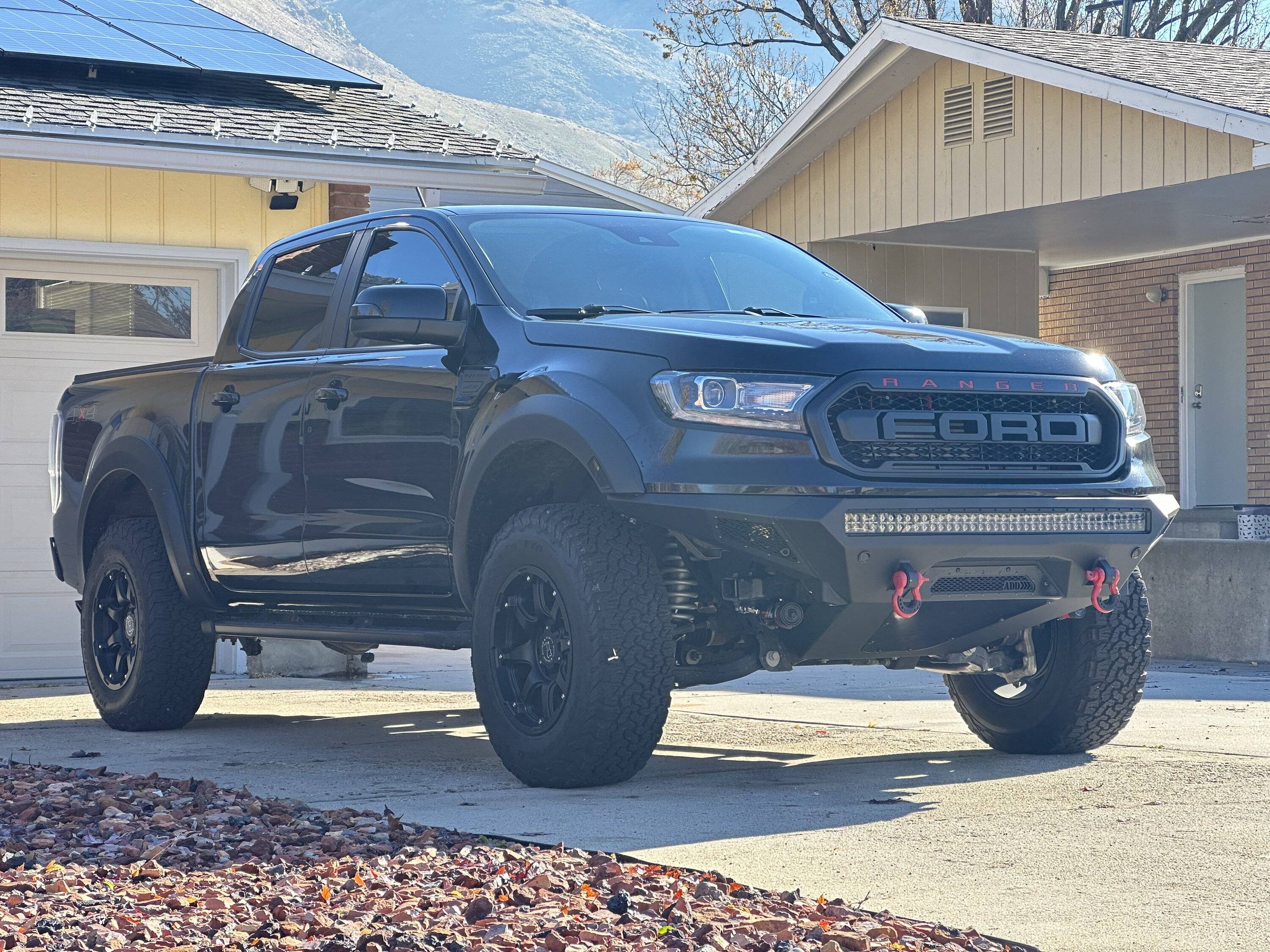

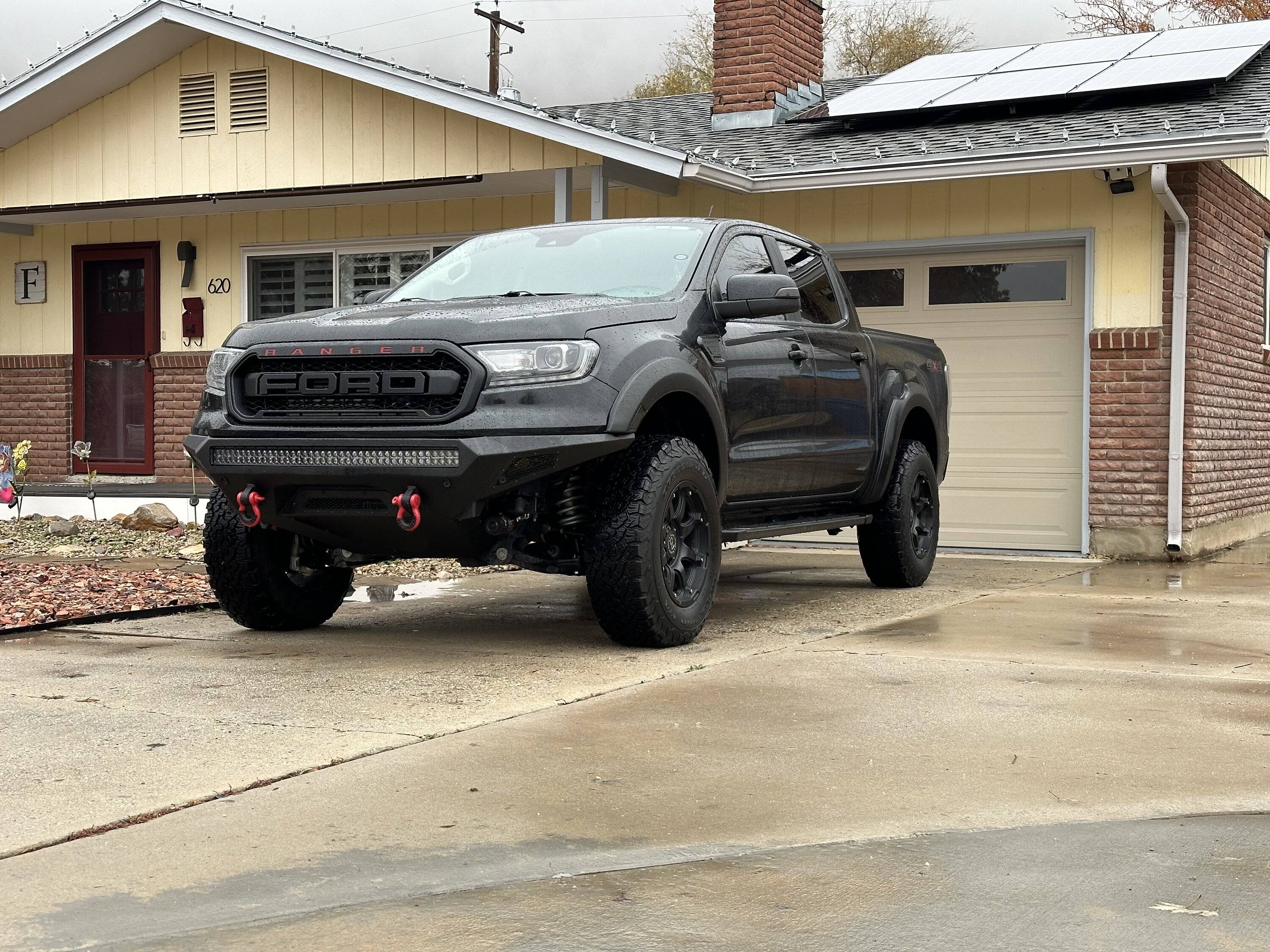

My set of last month... some other mods have been made (headlights and ditch lights).

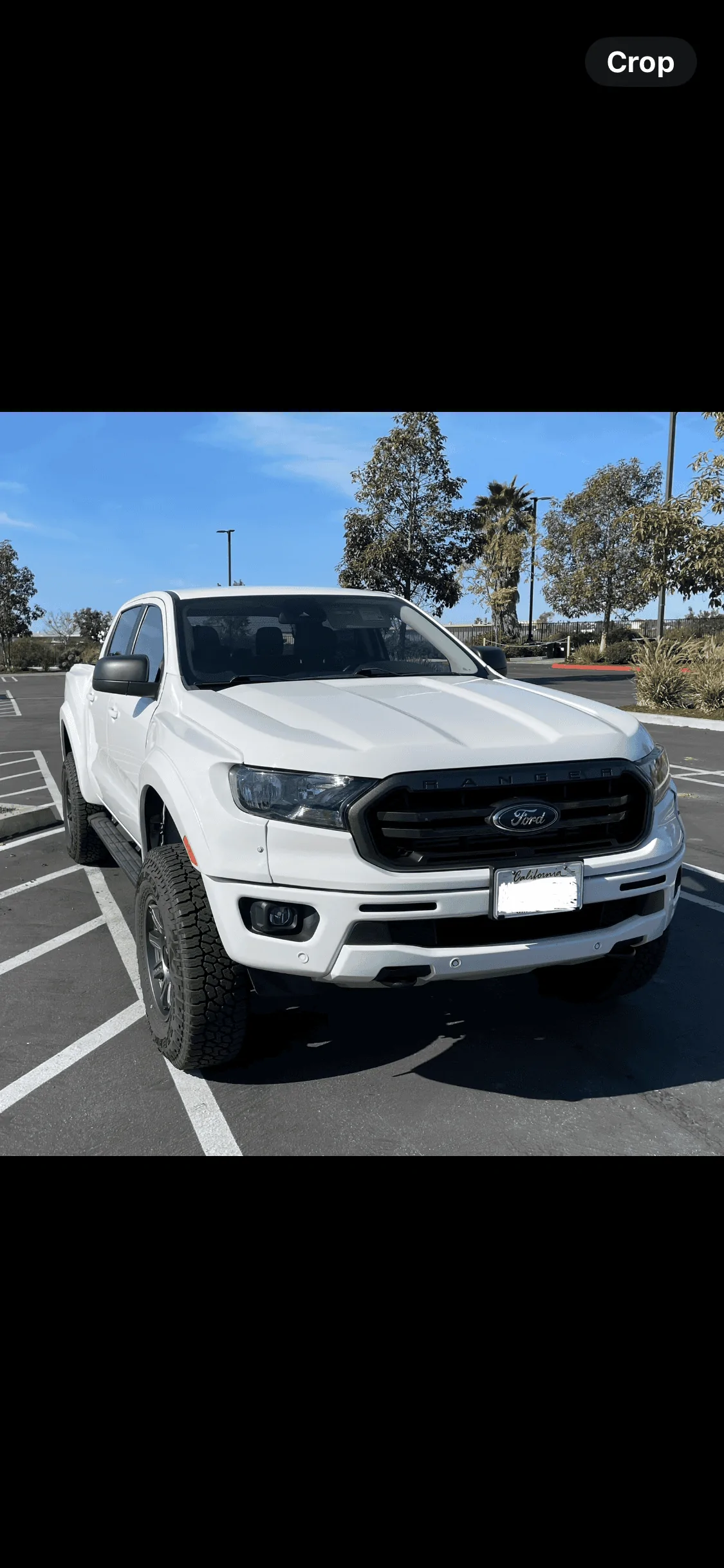

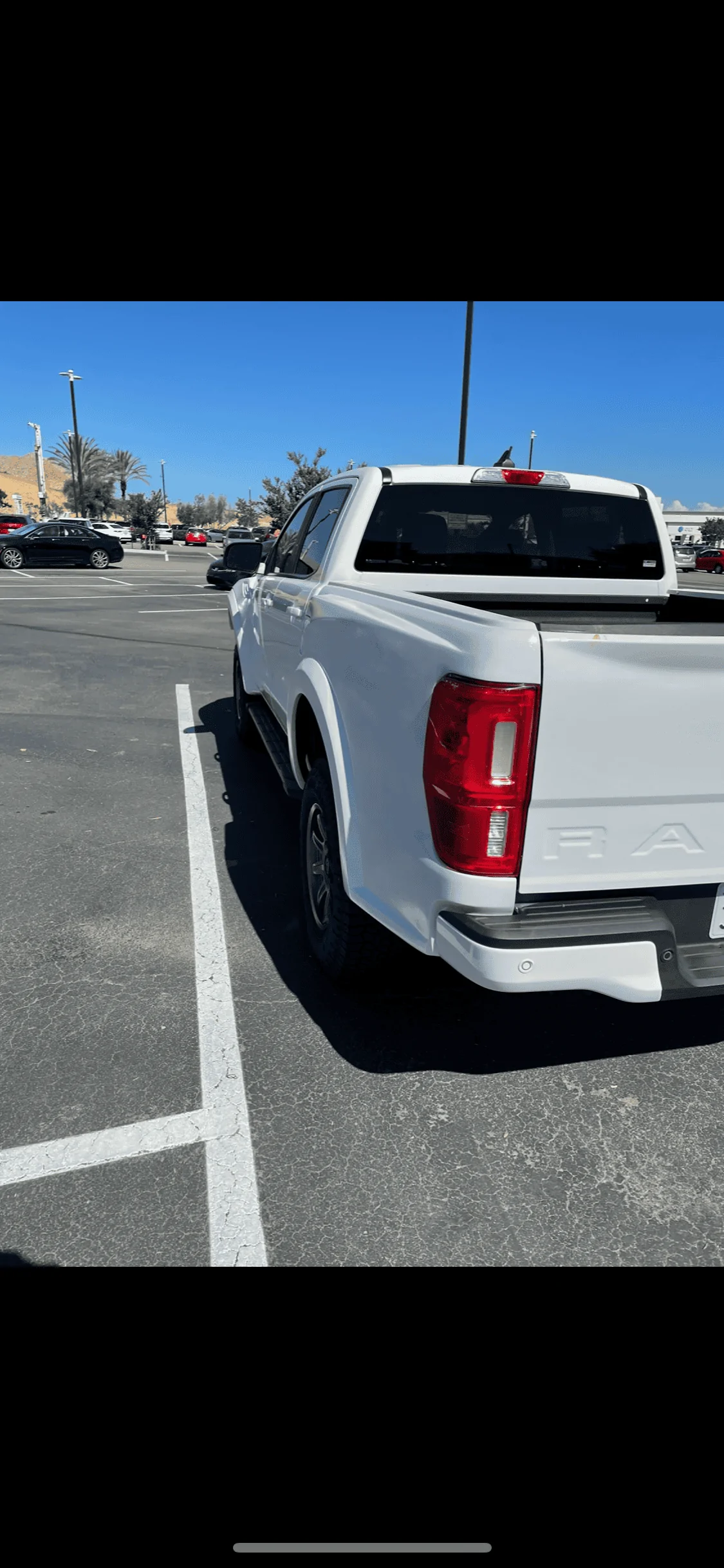

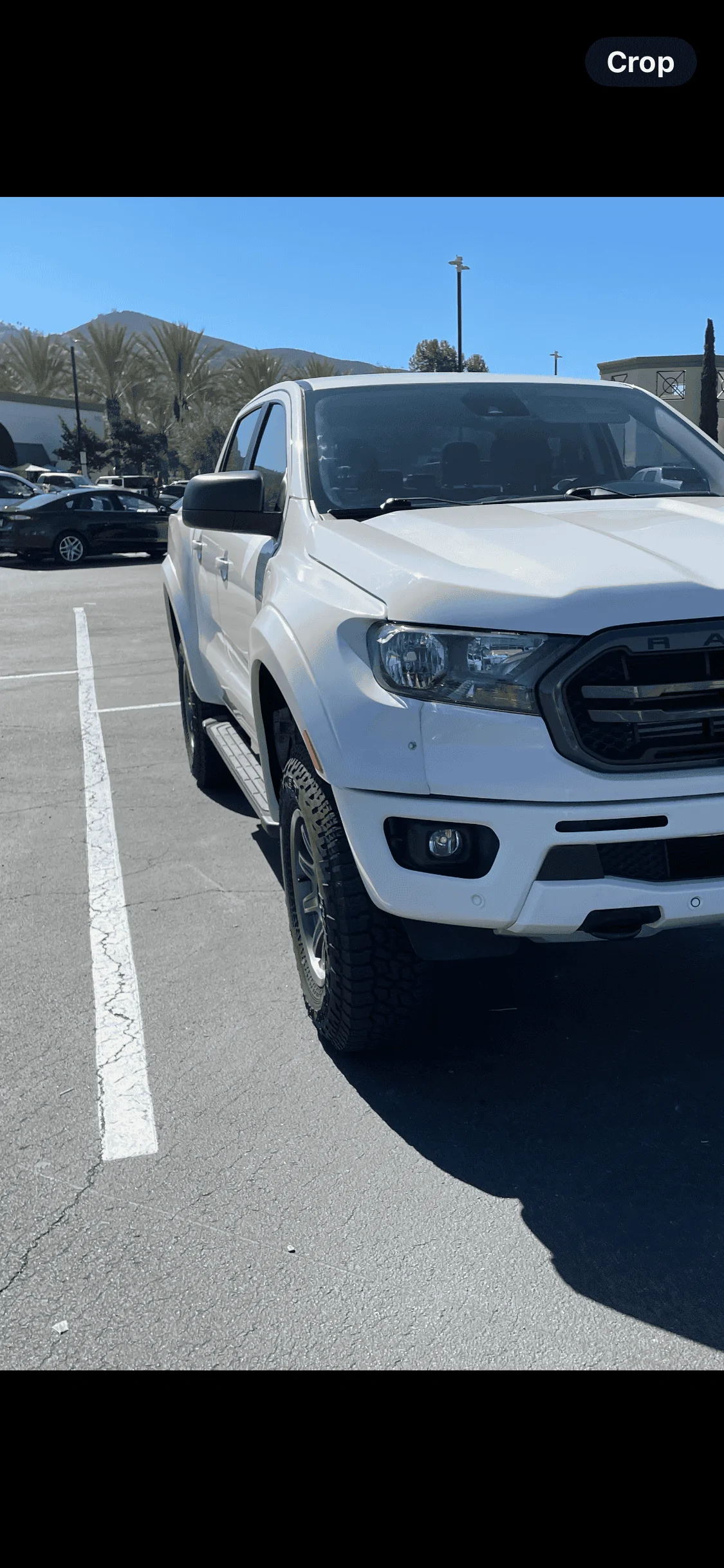

Hey there's nothing wrong with that haha! To each their own... but yeah I'd like to avoid that look ?

Wait, you don’t want it to look like this, haha ?
are those the fiberwerks? and how was putting the bedsides in? I have my fiberglass already but like I said I refuse to put them on until the Baja kit. Especially because they are 4.5" on each side so it would look ridiculous haha. I think you have the 3" bulge right?

You are correct, these are the 3” wide fiberwerx. I had them installed by fiberwerx before I installed my Bajakits.
As for the axles. I took out my axle and took them to ORW to have them install the extended shaft on stock joints. I then installed the rest of the kit myself, upper/lower arms, axles, steering extension, break lines and shocks.
The hardest part was the break lines because they’re easy to remove but a pain to get back on.
