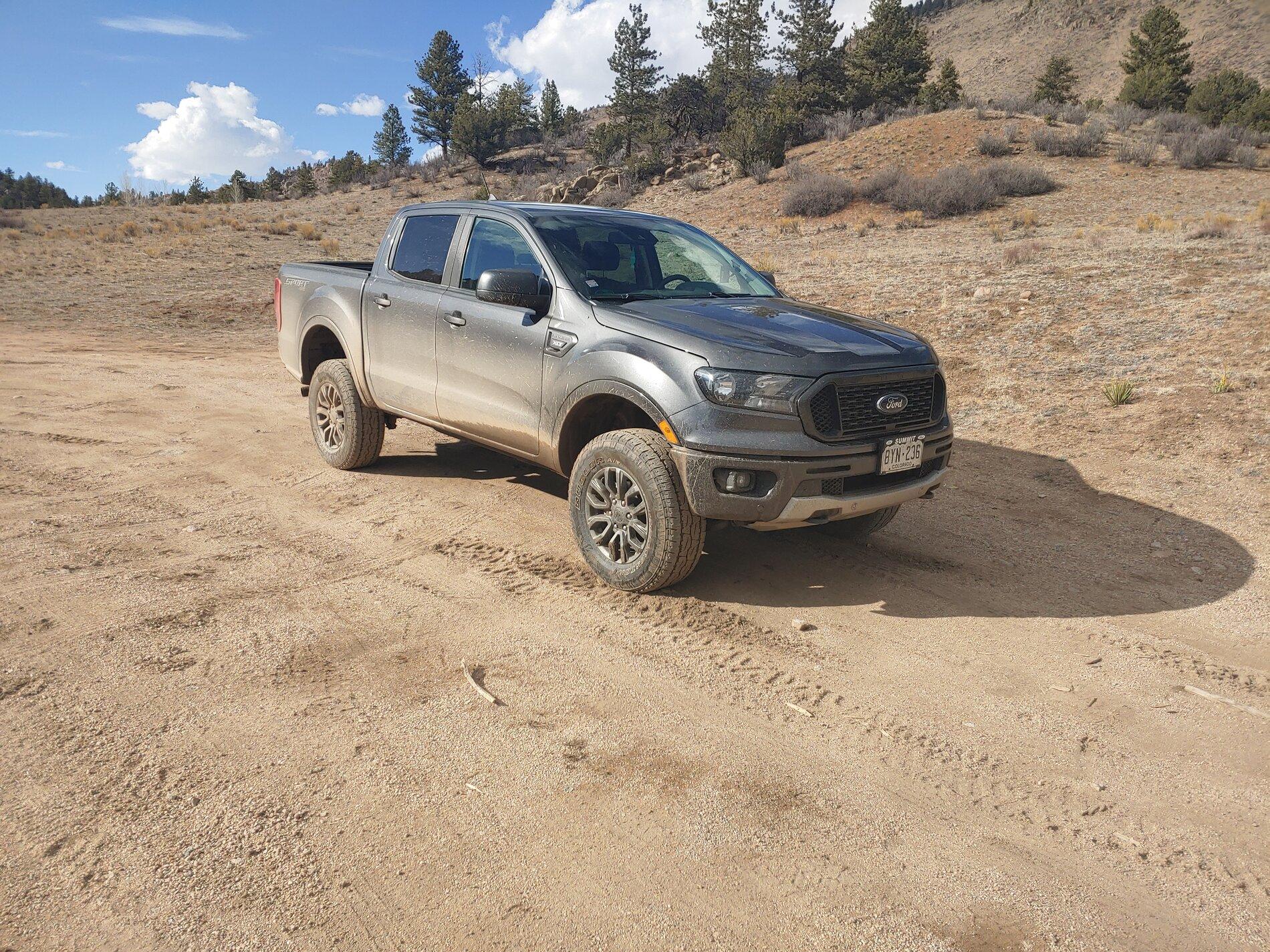

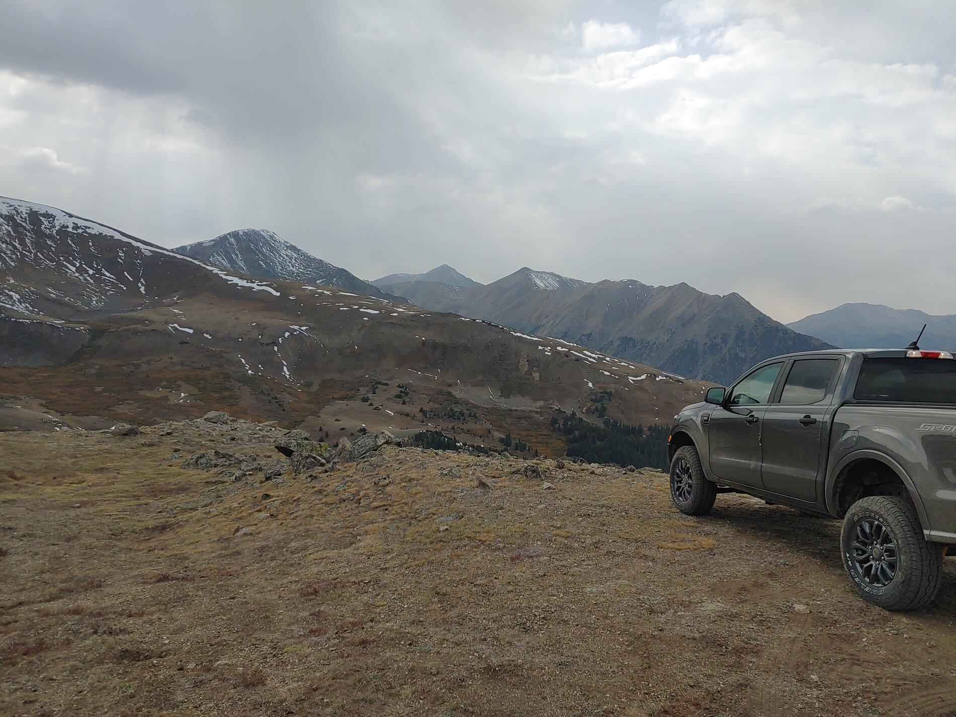

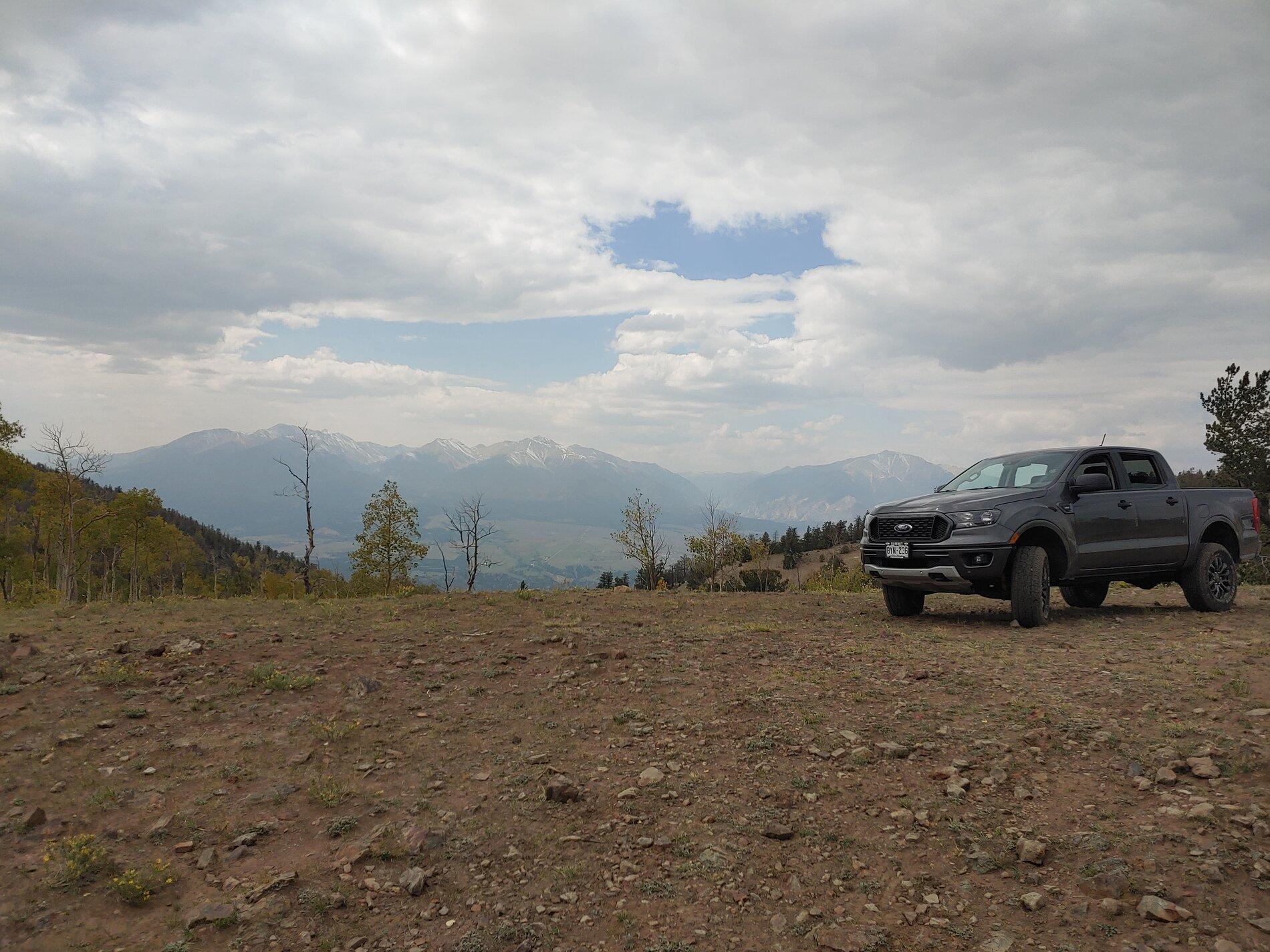

So instead of a leveling kit I suggest a lift kit!!!! Yes there is a difference and the one I suggest to you is Old Man EMU!! You do not have to worry about the control arms as the factory ones are retained. What do you get with the basic kit? New shocks on all 4 with new coil and leaf springs. The front is lifted by 2.4 inches and the rear is lifted by 1.6 inches. With that kit you can easily put on 285/70-17 Firestone Destination XT tires on factory wheels with no spacers and have no rubbing. Those tires will lift the truck about 1.5 inches on all 4 from stock. How much weight can you put in the back before you level it out? 800 lbs in the bed will level the truck out on the standard OME leaf springs.
I do have an entire review with information if you look it up.
Here are some pictures of my truck with 265/70-17 Bridgestone Duelers right now.
