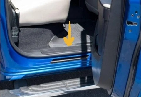

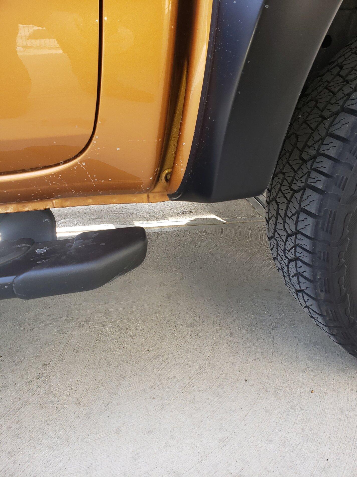

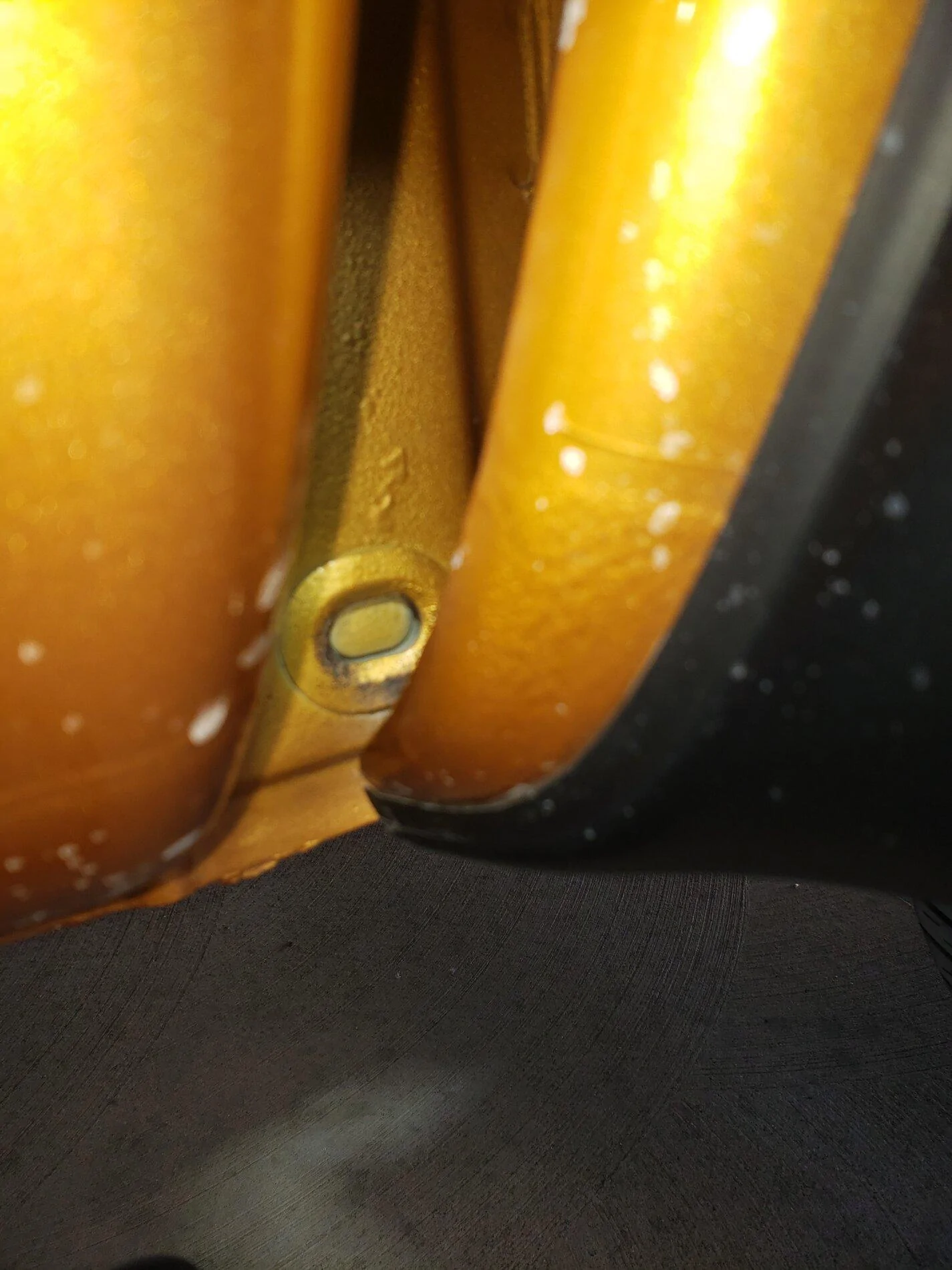

Look at the picture with the bed and cab, then the zoomed in Pic , that small grommet is where I ran the 12v wire. It's only exposed for a very short amount so I put a loom over it and zip tied it in place. There are a couple of grommet/ vent areas behind the rear seat I believe but I didn't explore that area because the power wire I needed was right under that sill cover. I attached a picture of a rear scuff plate with an arrow pointing down, pop that loose and the round hole that the plastic rivet pops into is where I brought the wire thru. I did not enlarge it. Depends on how much you want to take apart I can't say for sure if there isn't another hole or opening it would come out at in the cab, I didn't want to take apart more than I needed , I just clipped the tape that bundles the wires and found the wire I needed and tied my power into it. The ground I ran up to a main ground up front. I used good quality speaker wire for the +&- to the bed.
Also, I tried using a piece of 110v wire as a fish and it was too stiff. So I used a single strand of doorbell wire and ran it from inside to.that oval grommet, I could hear and feel the vibration of the wire but couldn't snag or see it so I twisted/spun the bell wire and it popped into view then used a wire to hook it and pull it out. In the bed I used the other bell wire to go down the hole in the bed and it pops out in front of the rear wheel
