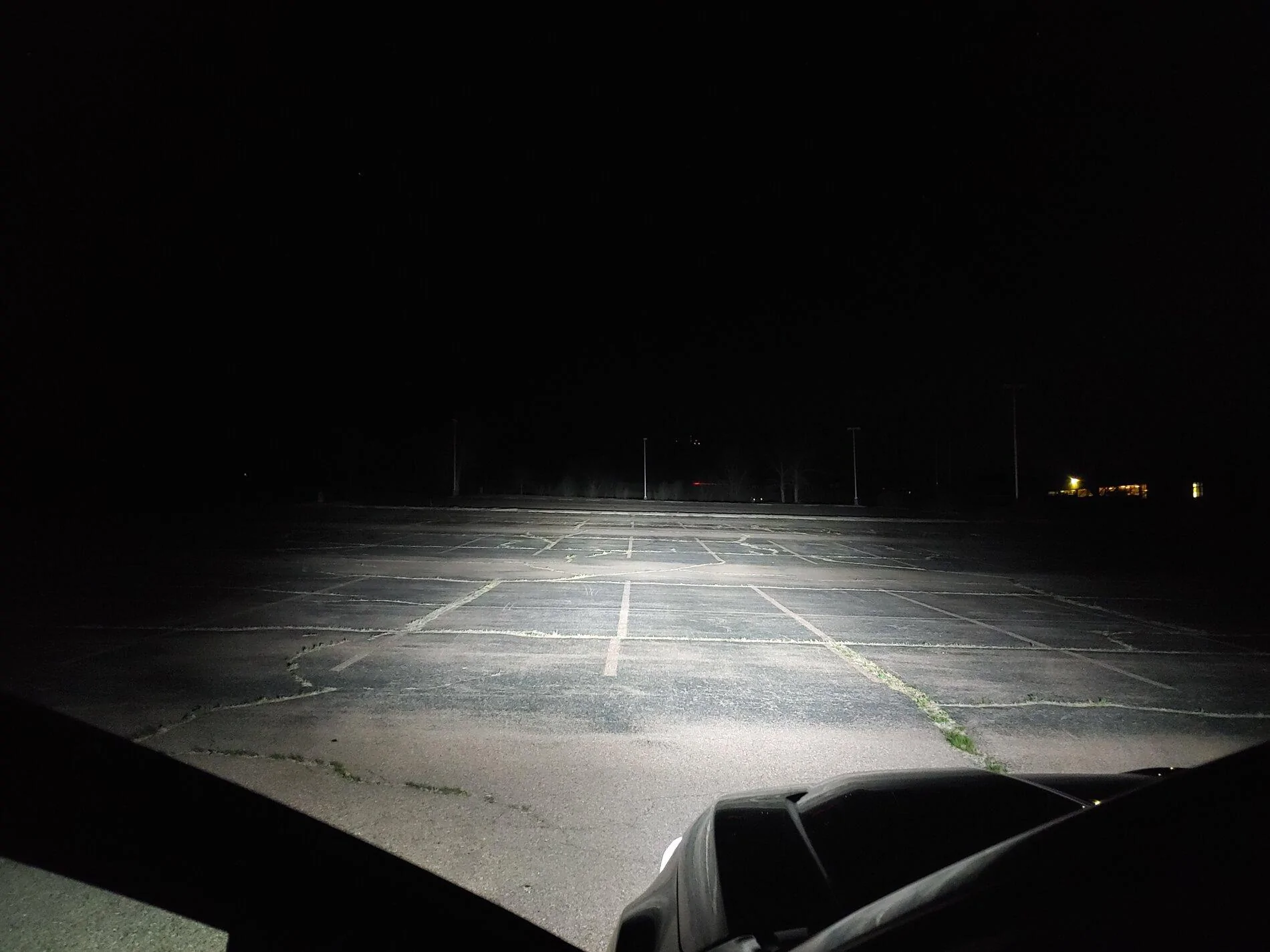

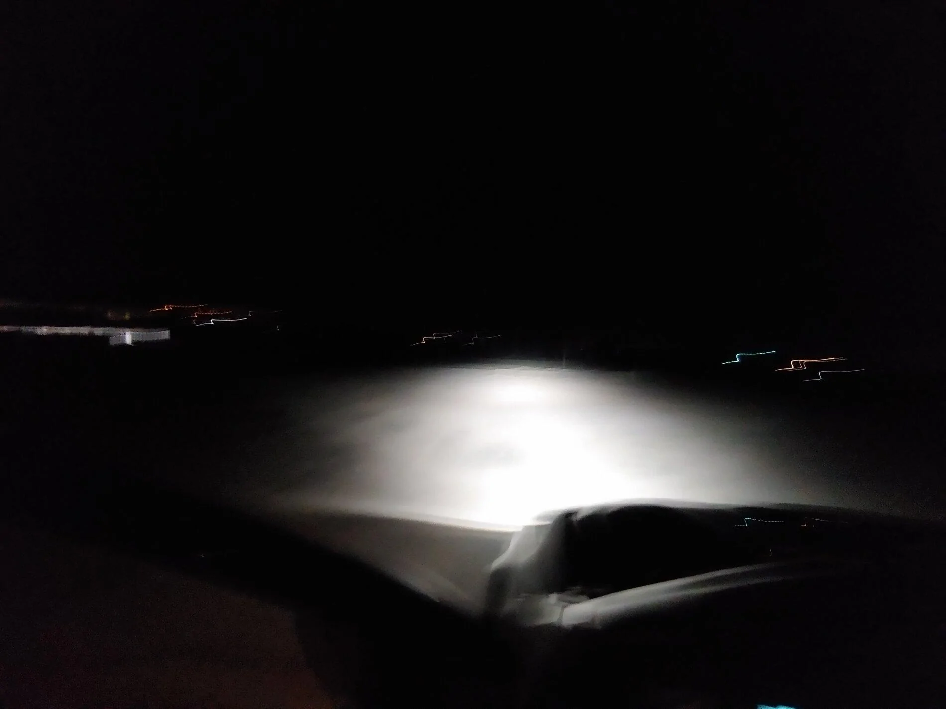

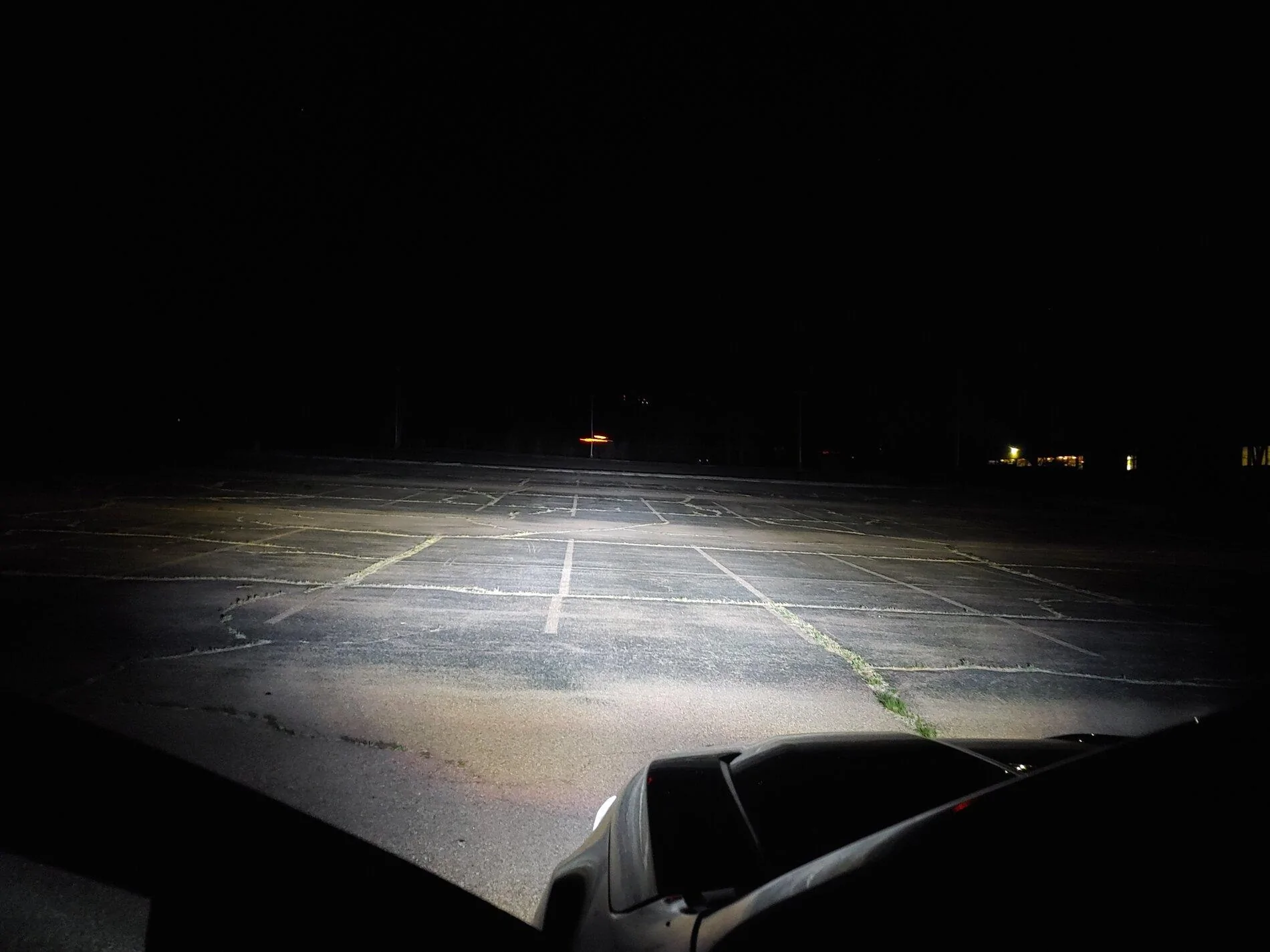

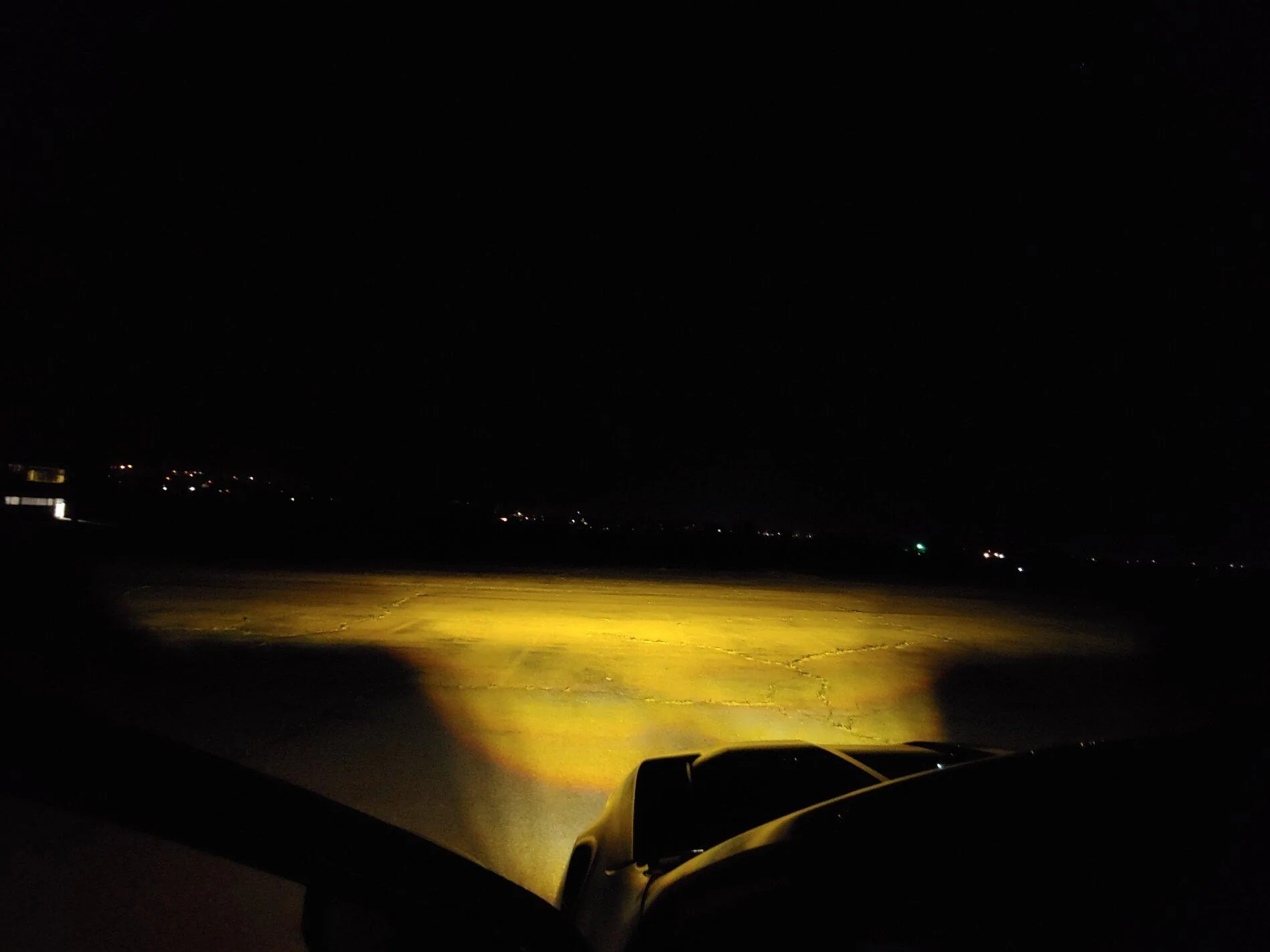

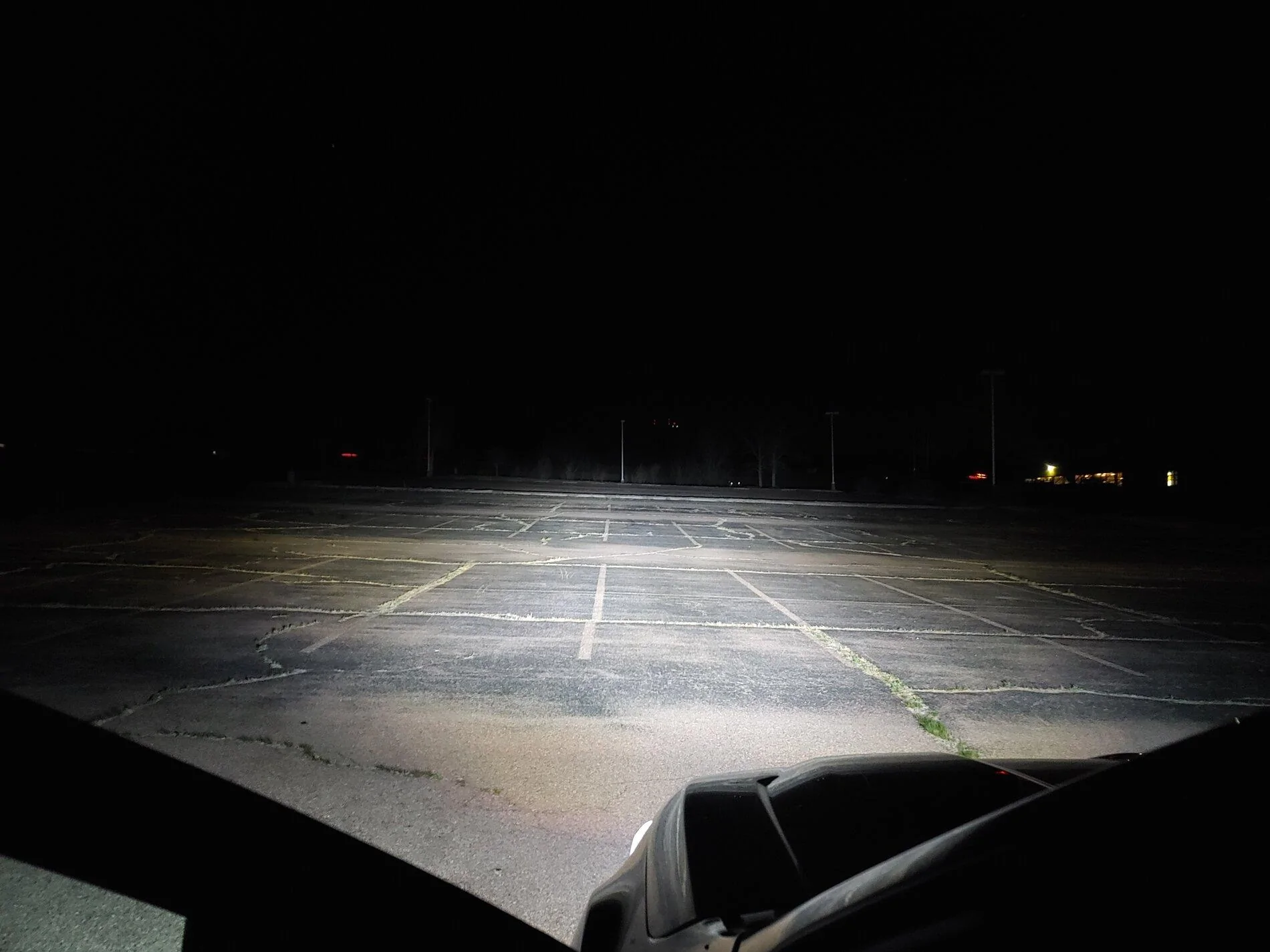

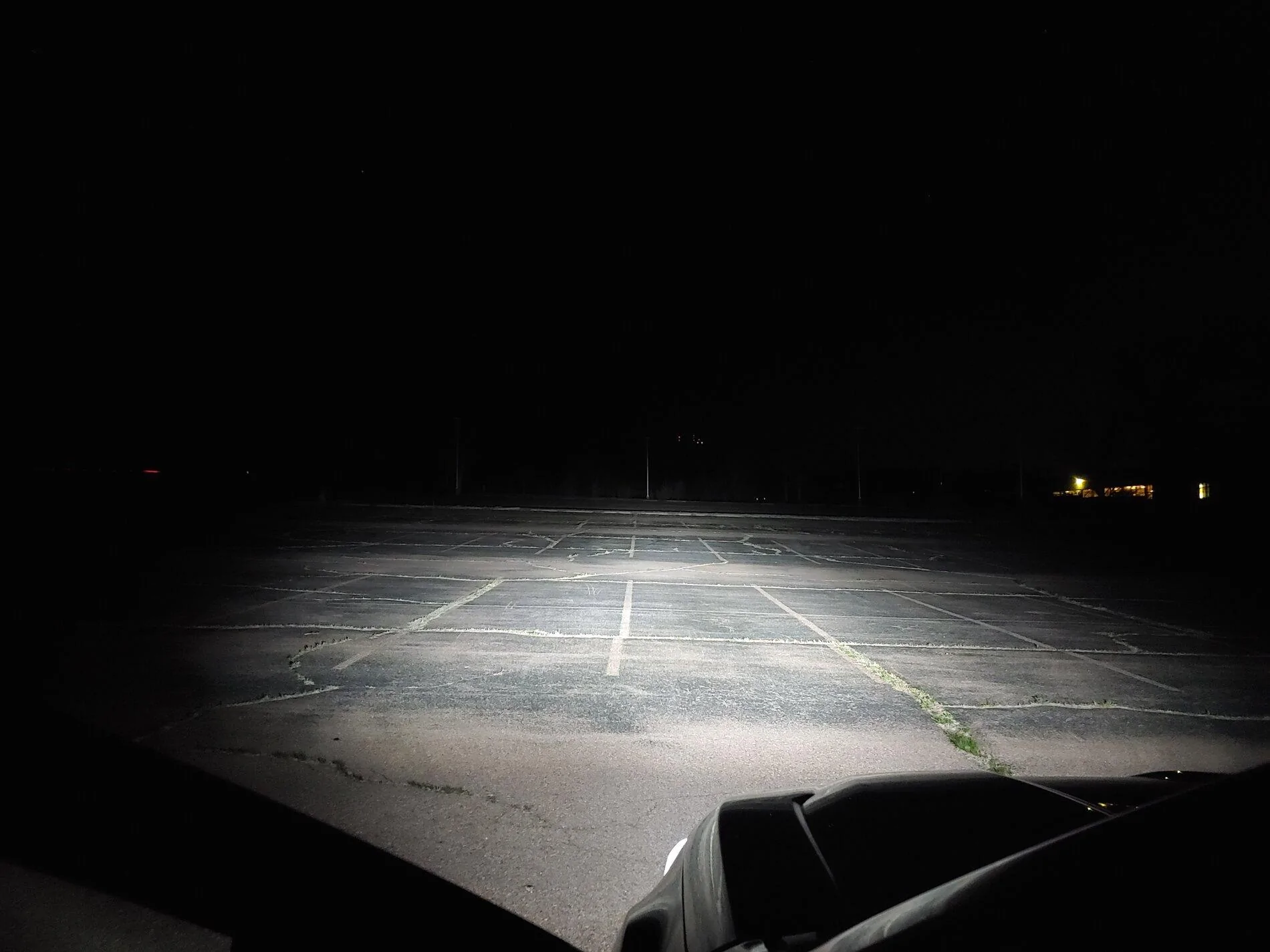

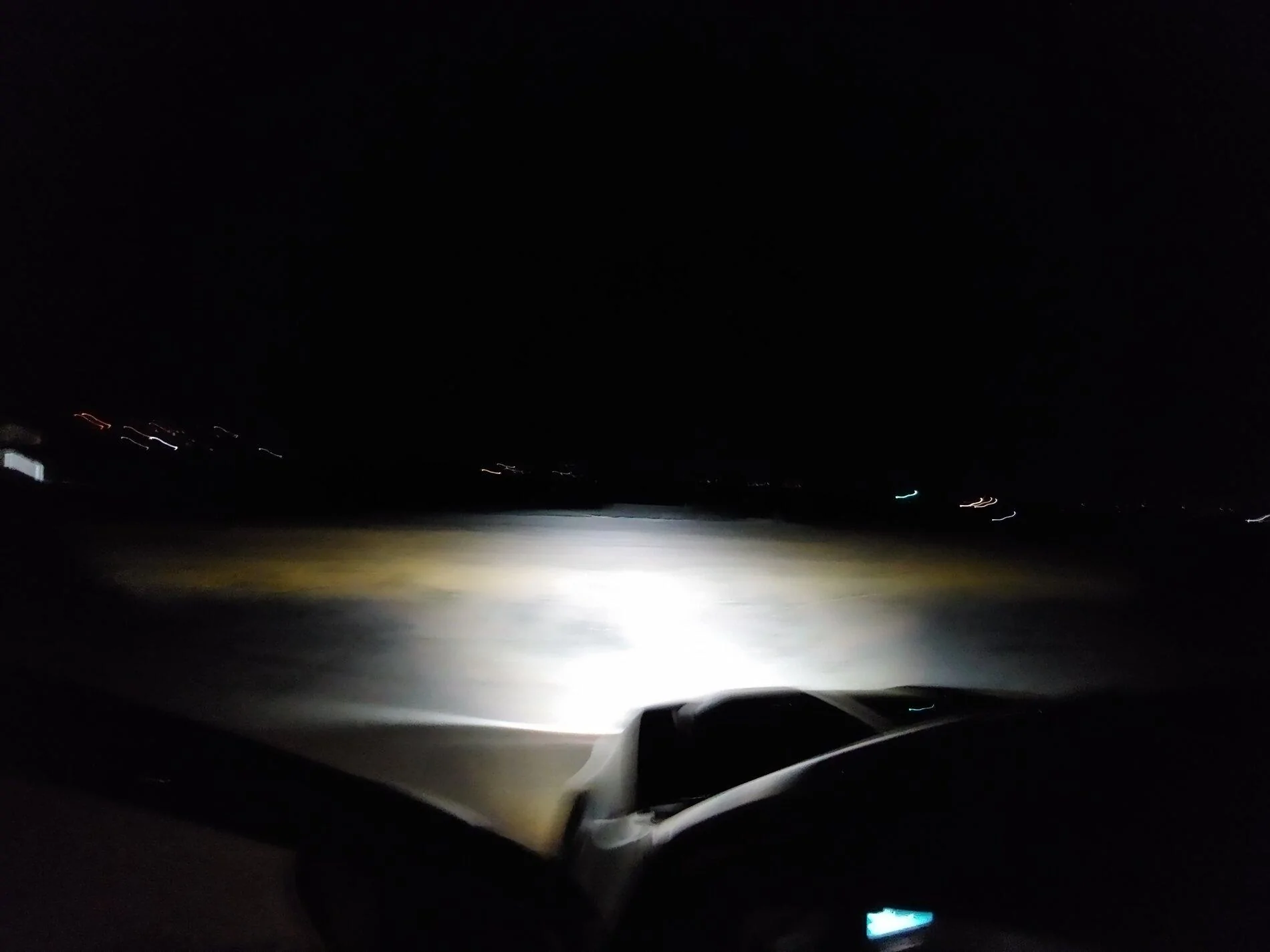

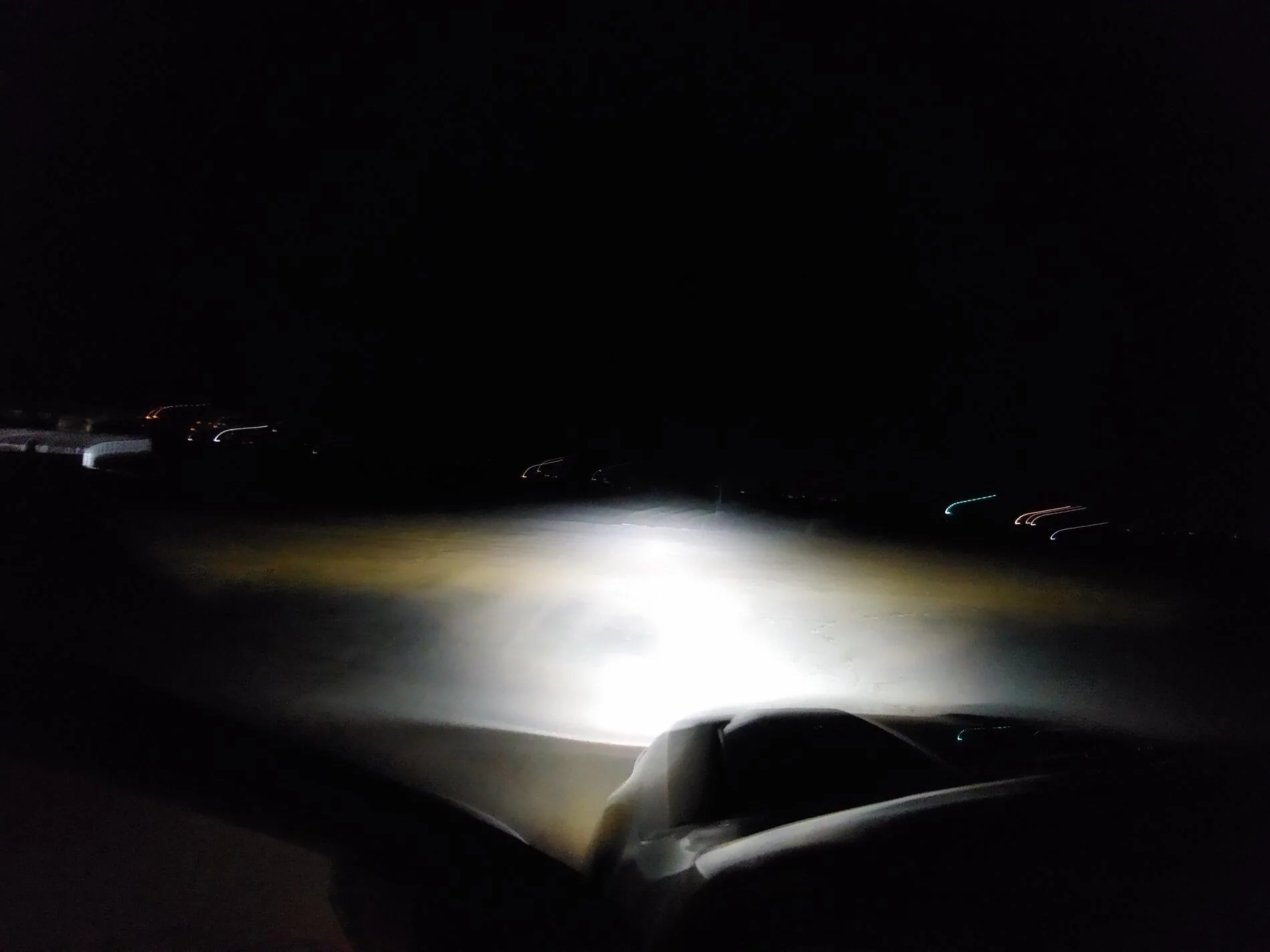

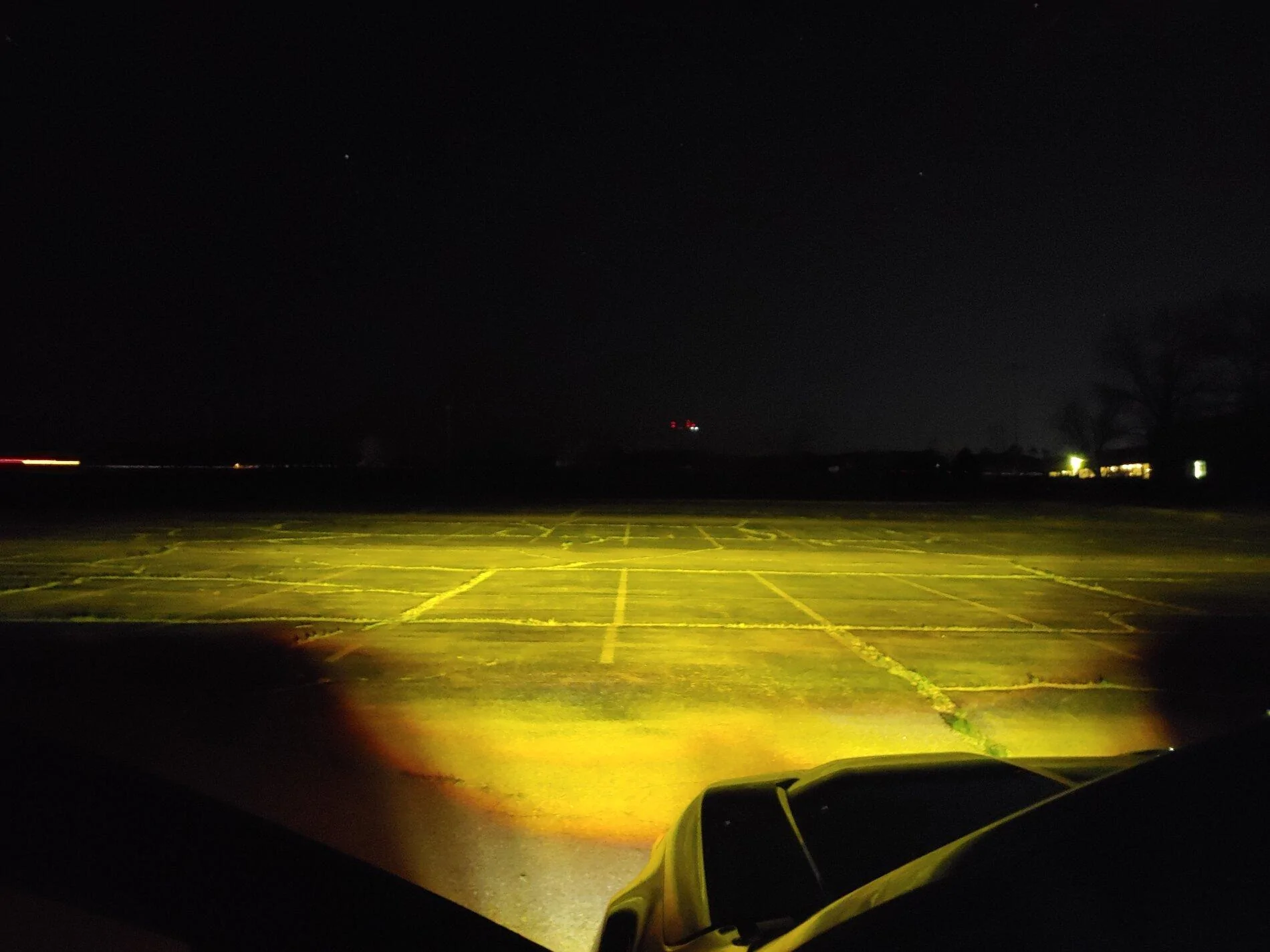

Alrighty, so I got my headlights adjusted to what i believe is correct. I took some pictures of the on road. I did not take pictures of them in the truck because that is just silly.
How did I set the lights up? Well after going into Forscan and setting up the DRL for Dedicated DRL I hooked the DRL module up and now when I have thwe switch in AUTO the DRL lights are on without low beam headlights.
Now before I put these headlights in i had drop in LED's from BeamTech. They were ok but not that great. Last weekend I installed the Morimoto XB Fog Lights. The output was nice for what it was. The headlights came in yesterday and even after a long day of work I decided to take the chance and install them as I just could not wait. Today I corrected the aim.
Here are the pictures I have for you guys!!
The first 5 are with the Alpharex. The last are with the Beamtech's

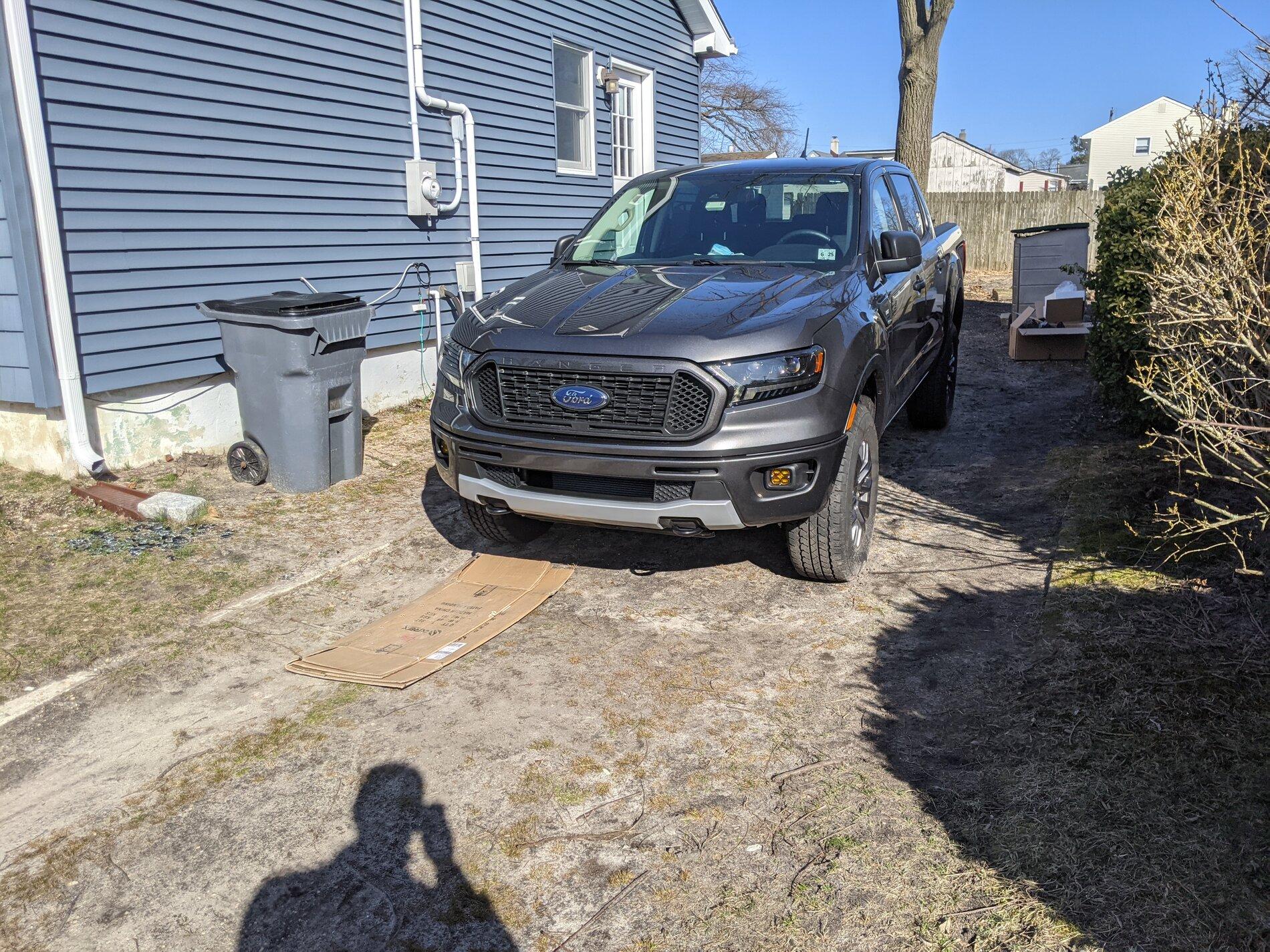

I bought the LUXX series. General consensus from my friends and myself is that the light show on unlock and startup is a little over the top, however the actual beam pattern and lights themselves, especially in alphablack, are a incredibly significant upgrade over the stock halogen headlights IMO. Pics below. I'm very happy with them. The guys with pro-series and LEDs look like an excellent option too, from the pics posted on here.

So I'm not a Fan of the Drop in LED lights as the light pattern from the reflector housing sucked. Going to the LUXX the beam pattern is much more evenly distributed and smooth. Its just the best way I can describe it. Also the color temp of the BeamTech is 6,500k wich causes horible sight in snow rain and fog!!! Thankfully the LUXX is a little warmer. Talking to Alpharex they had a guess of between 5,500 to 5,700k on color temp so that will make a difference.

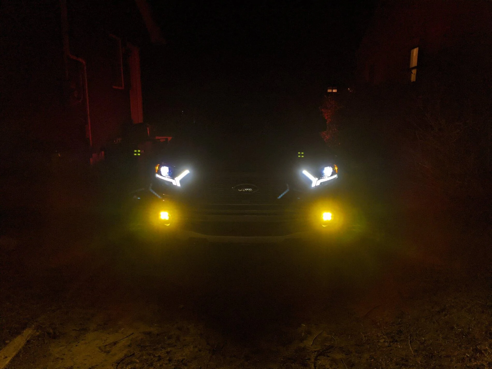

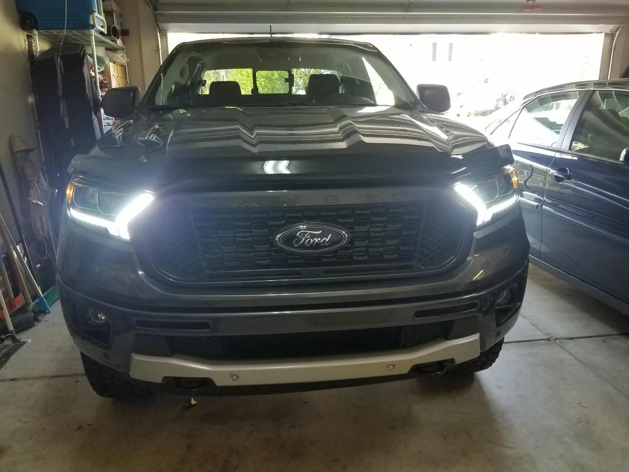

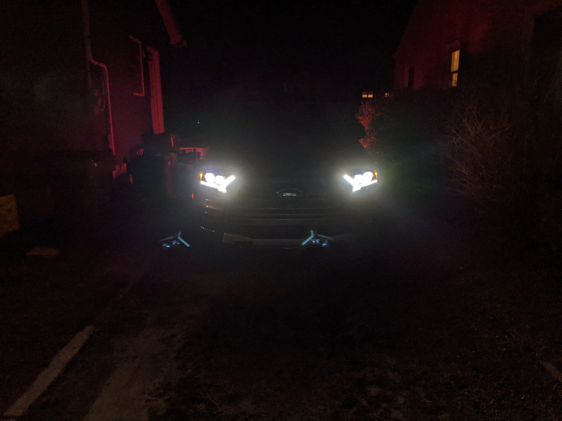

Got these guys installed today. Quite a job but worth it. I have always liked the front design of these trucks , but these Luxx series headlights transformed it even better! Both ways!
All wired up for the starting sequence. I'll get used to it.
Thanks Uncle Sam. ;)
