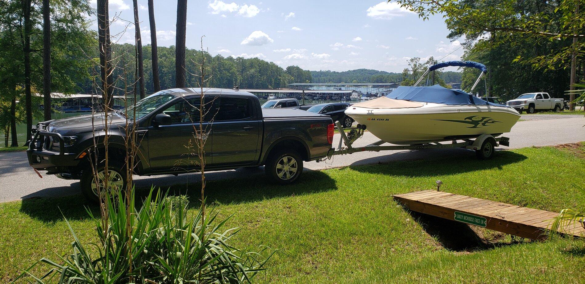

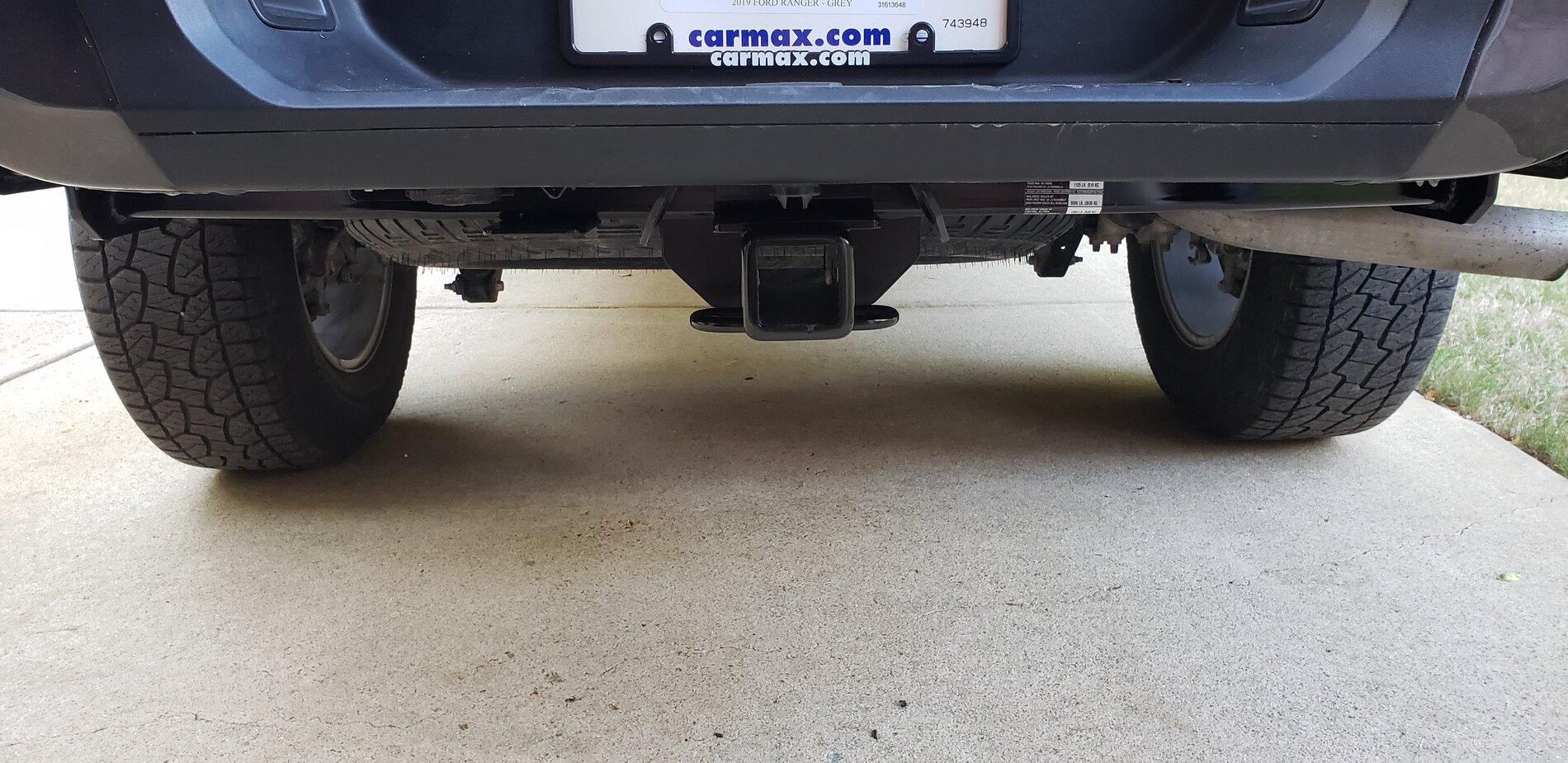

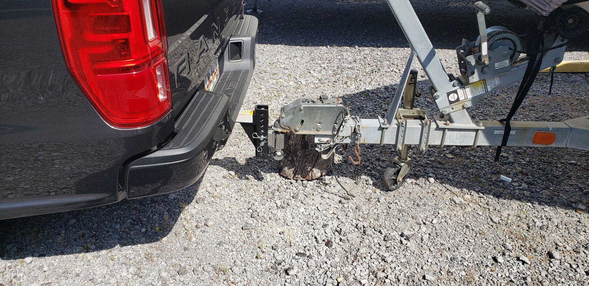

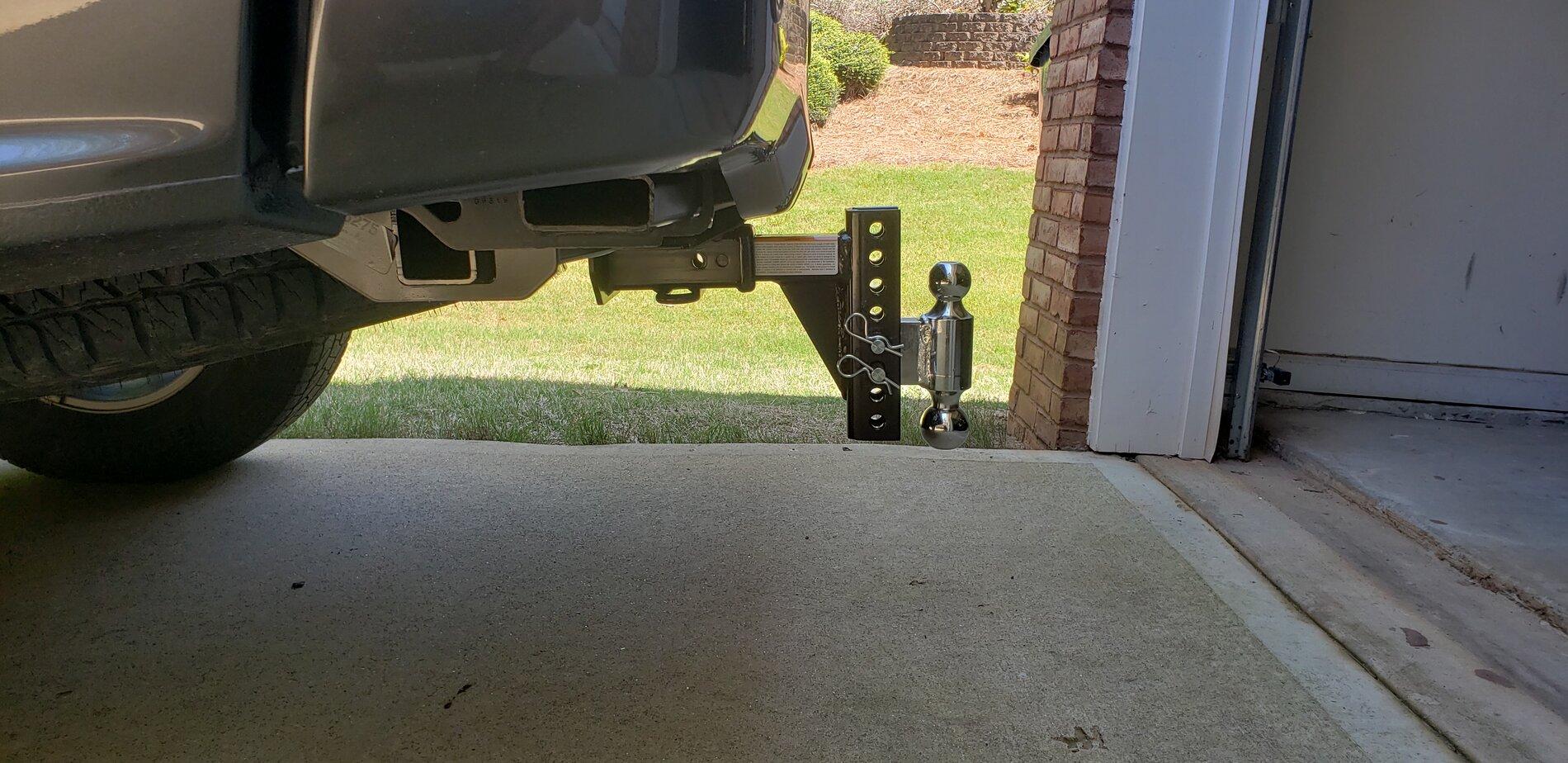

If your not towing heavy loads, you'll be good with an aftermarket hitch and the non-towing package truck's existing trailer plug. Mine did not come with the towing package and I added the DrawTite hitch and I use the stock 4 pin wiring harness. It works very well for towing my boat! And the truck recognizes when the trailer is plugged in, even without a towing package.
